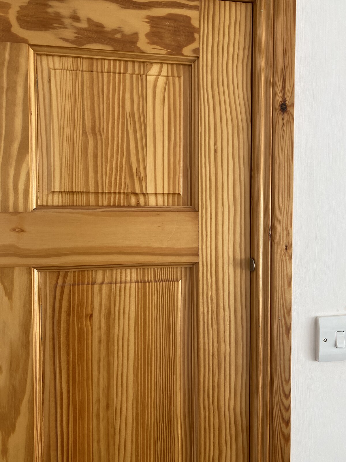

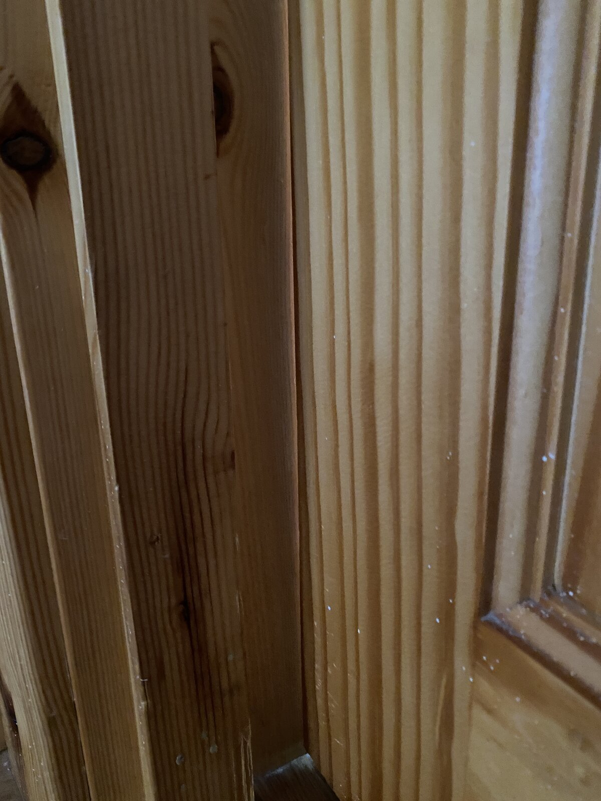

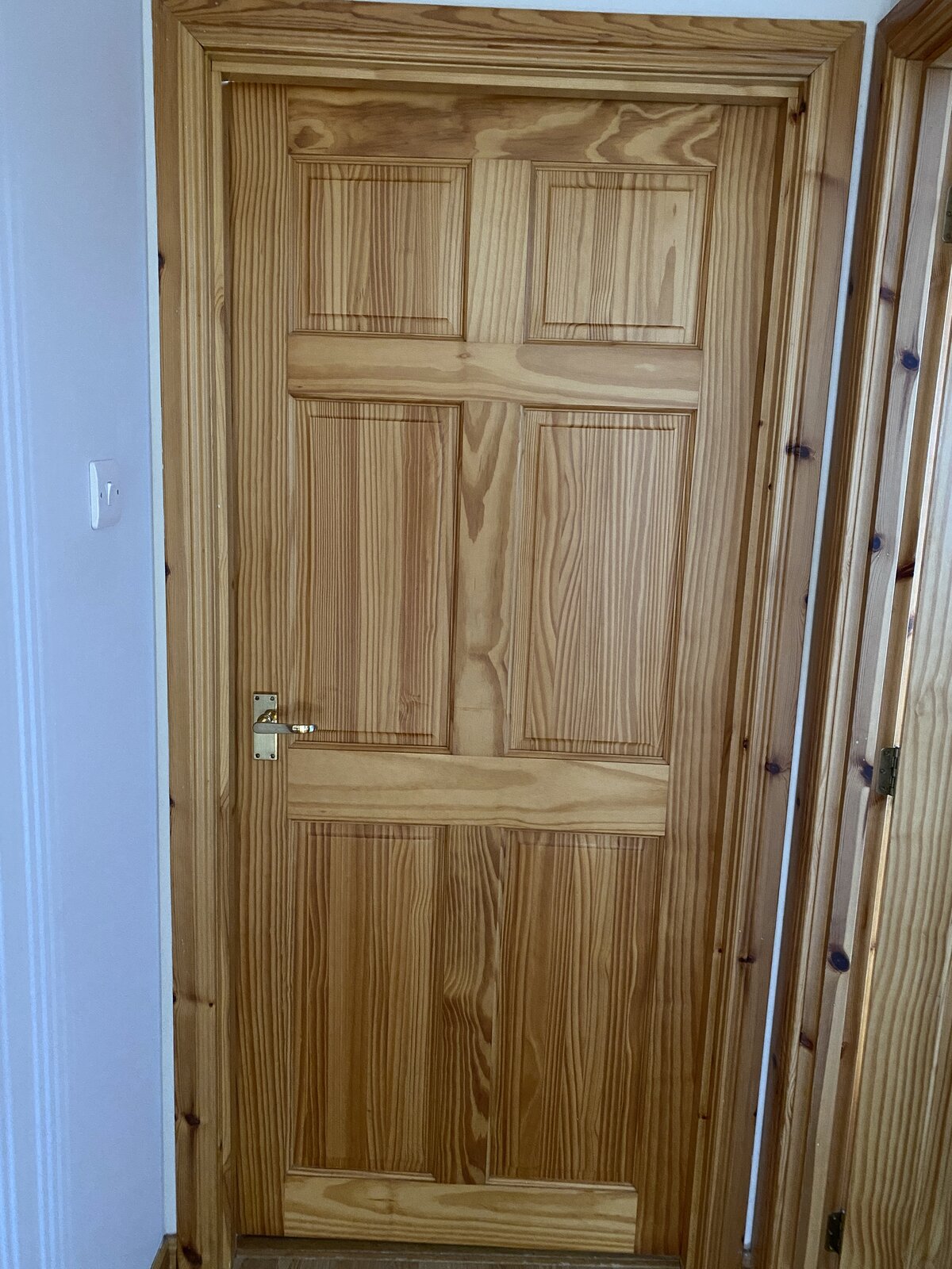

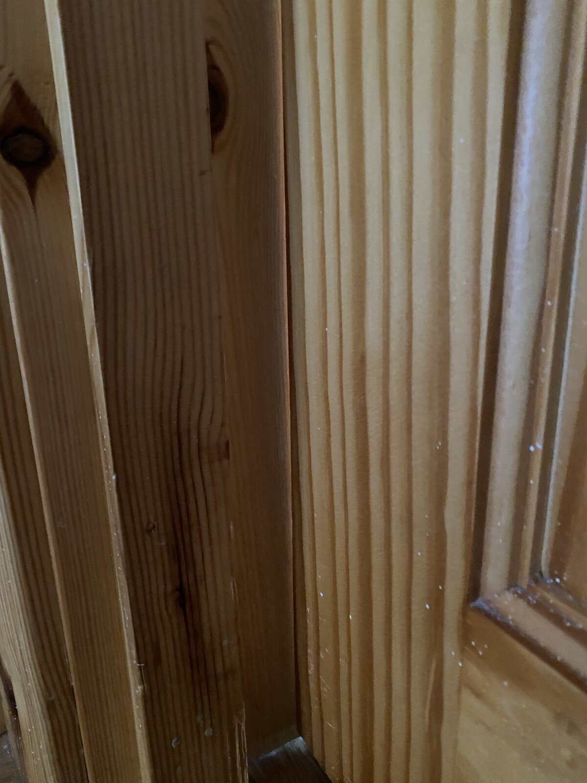

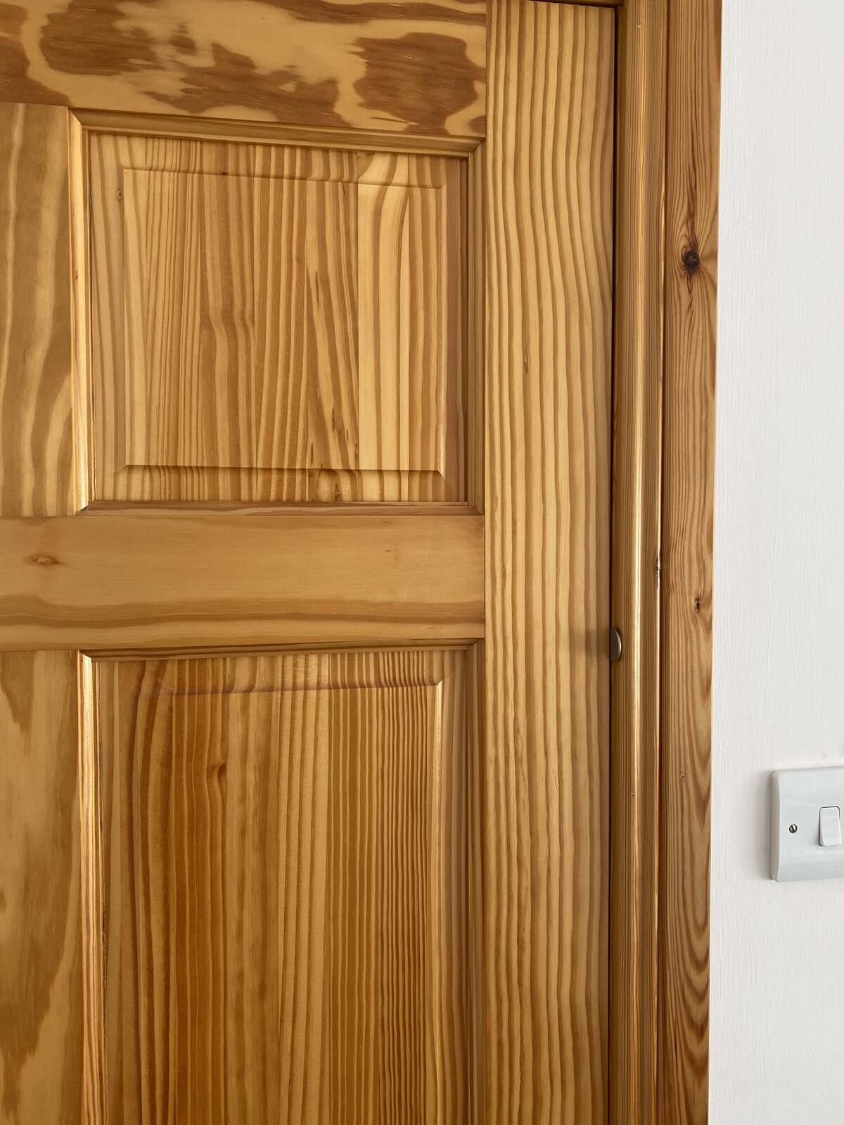

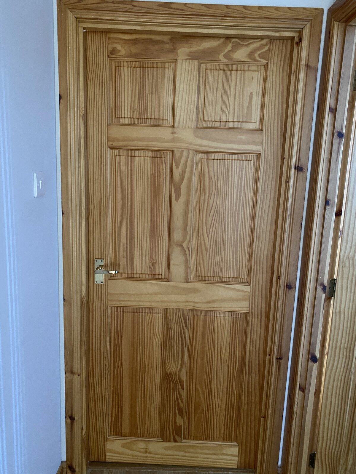

They are solid wood doors. They are only about 12 years old in a new build bungalow. Here are some pics showing the gap decreasing.

yes, they are panelled doors in varnished softwood. it is possible for old panelled doors to sag into a trapezoid shape, with the hinge stile higher than the lock stile, and the top rail sloping, but I don't see that. Have the doors and frames had an extra coat of varnish since they went in? They will expand in humid conditions, for example if you drape wet washing over radiators or have steamy showers.
I can't make out the gap. To see it, close the door fully, and stand on the inside (so you would pull the door towards you to open it). You will be able to see the knuckles of the hinges. The gap should be sufficient to run a 10p coin between the edge of the door, and the frame, and this gap should be equal all round the door. Is it? Will a £1 coin fit?

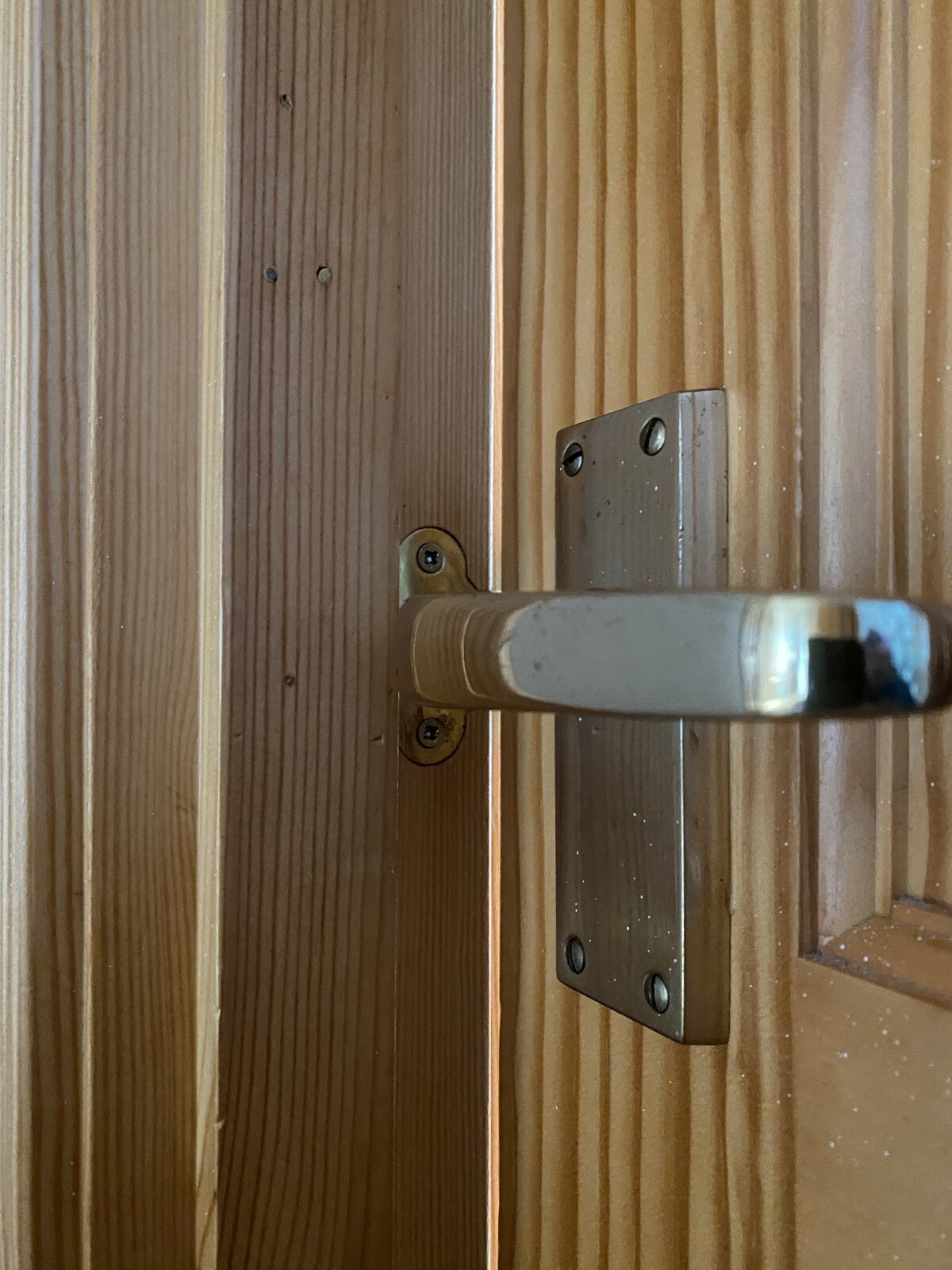

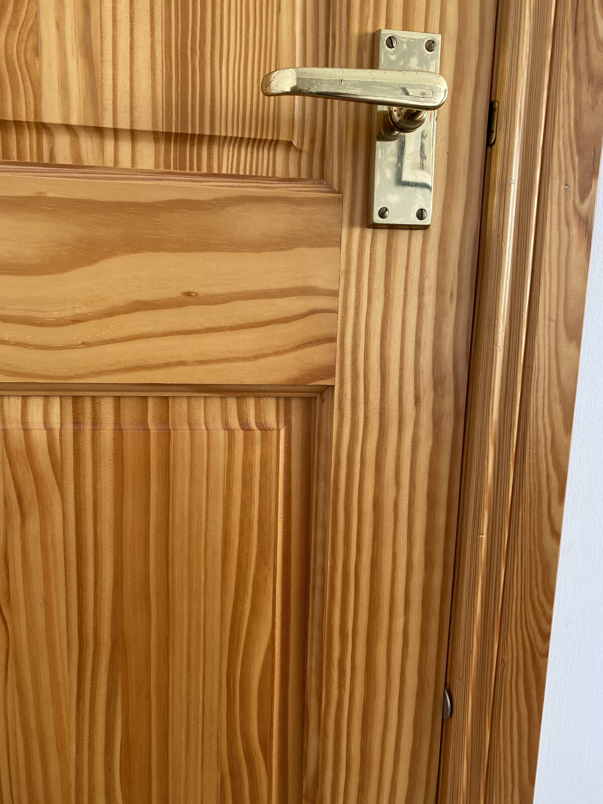

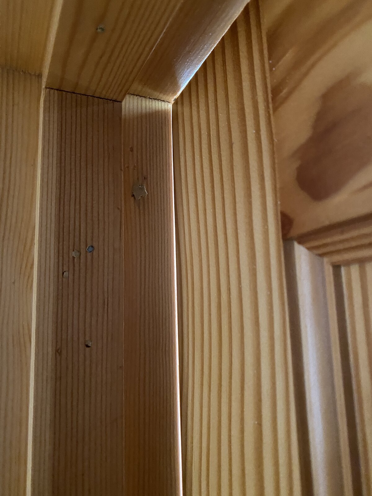

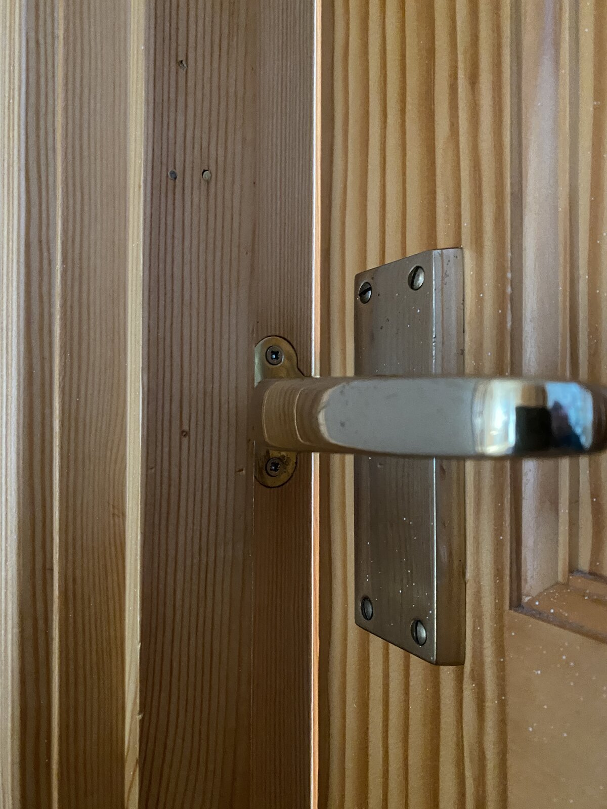

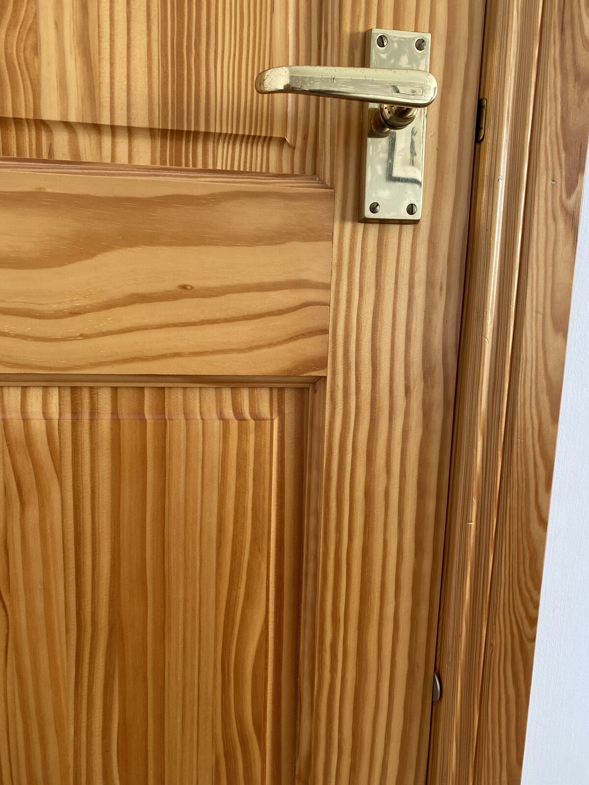

Pound coin won’t fit anywhere round the door but the 10p is a good fit for most of it. The only place it gets tight is above the handle till just below the handle. It won’t fit in the gap there.

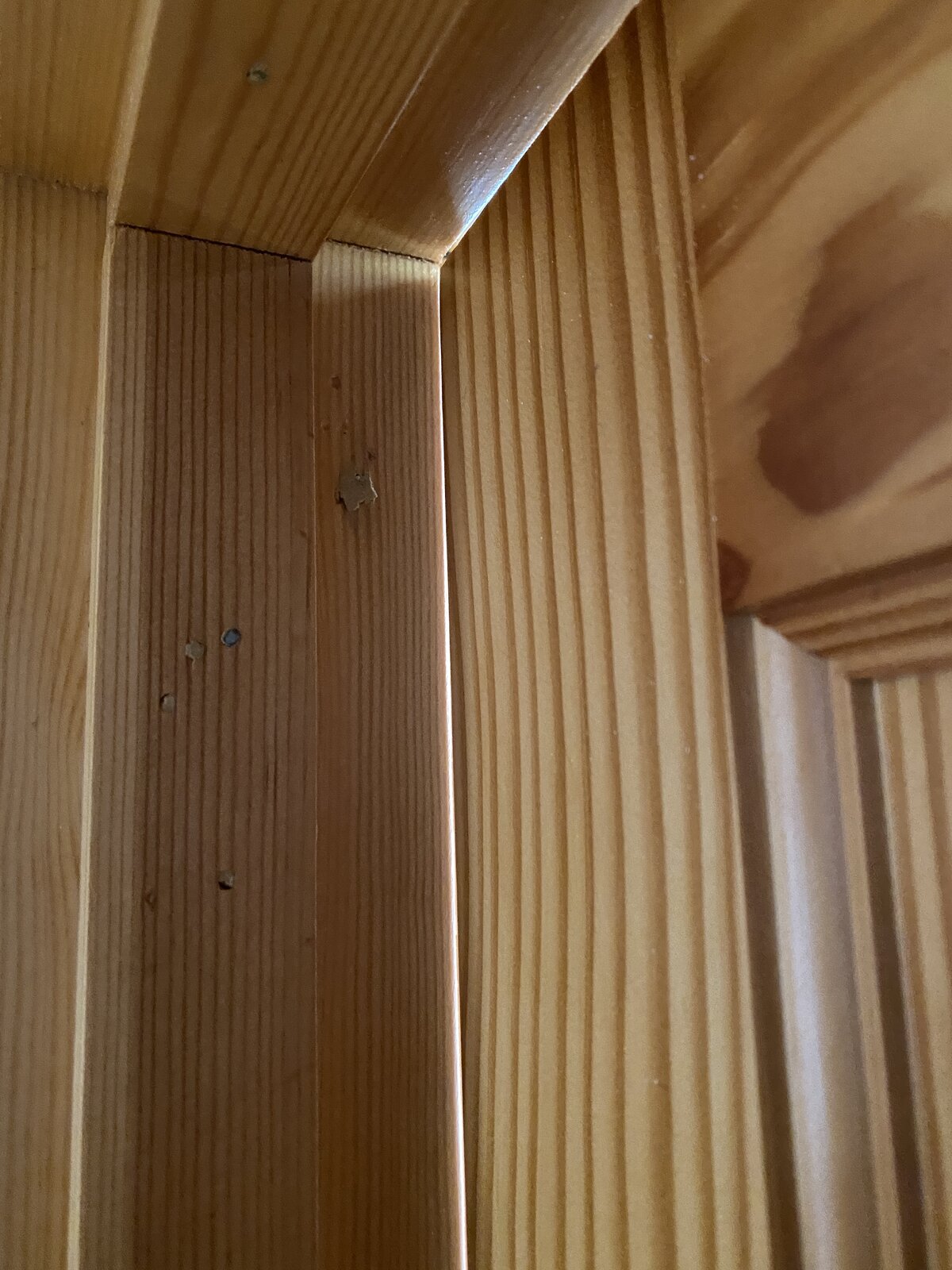

And what's the gap like on the hinge side, and along the top?
then I don't see how it can be the "bottom of door hitting jamb"
the bit near the latch could be planed back a bit. If you have a long spirit level or something, test to see if it is the door, or the lining ("frame") that has the bulge in it. You can rub chalk on the edge of the door to show where it is rubbing.
