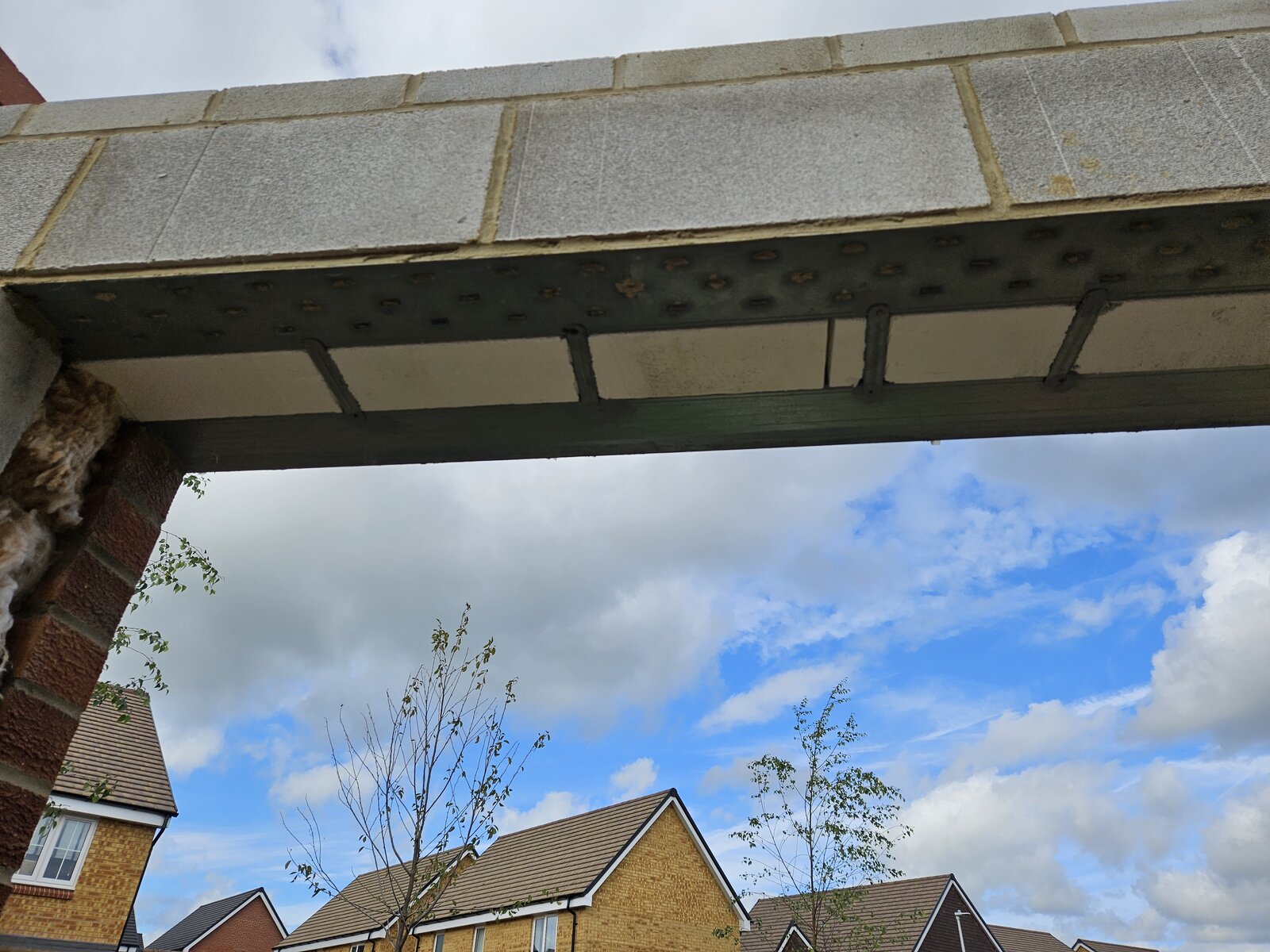

I've done some lintels and have seen some things that say you should have wall ties within 225mm above a lintel. This would make perfect sense for concrete lintels etc., but I'm wondering whether the cavity lintels act as wall ties too. The docs aren't clear but say it creates stability between the leaves and split lintels require more wall ties. My lintels are thermally broken, but are tied together with metal straps along the bottom.
This is what my lintel looks like from below. You can see the metal straps under the polystyrene insulation.

That spec doesn't work at all. Either the masonry above a lintel is just infill to wall plate level or there is masonry walling above, in which case there would be a cavity tray in that area. No room for a wall tie.
General specification for wall ties is they should be placed within 225mm of openings. This really refers to the open sides of windows and doors where the general strength is weakened by the open sides. This normally isn't used in reference to lintels. I wonder if somebody has read the 225 rule and applied that incorrectly?
You are right about a cavity tray. The tray goes up 225, so there's nothing to stop me putting ties on the same course as the tray on the inner skin. I will actually have 450mm of masonry above the lintel, and then a flat roof.

Is the Ancon diagram wrong? It clearly shows 225mm above the openings. Does the same apply to my concrete lintels (going into the garage), or should I put ties on the lintel (as close to the opening as possible or is 450mm fine?
The diagram is wrong. The lintel is a tie, to comply with regulations, the next course of ties should be 450 above the lintel. I wouldn't put a course of ties on the cavity tray.
