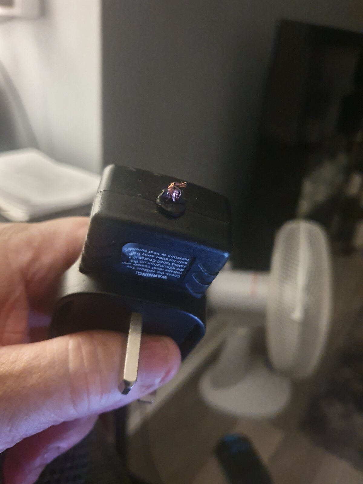

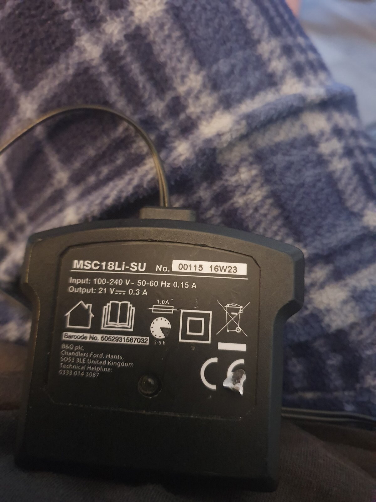

I have a Mac 18v charger for my Mac Drill, trouble is that the power lead is broken and can not be fixed. I've tried to purchase a replacement, but cant find the correct one. Mine is a MSC18Li-SU with 3 contacts. Can I buy a compatible charger , if so , which one and from where.
Thank you ...... here's hoping

In what way has the power lead broken? Can you describe that issue and Can you share a photo.
Sfk
do you mean the lead is damaged? or the charger?
replacing a damaged piece of wire is easy.
The wire has snapped too close to the plug. The plug is a sealed ug

And last question - is there a label or messaging on the plug that says anything about what voltage it is producing?

Sorry - should have explained. Saw the photos and yes cable has broken very close to plug (or sometimes called power brick).
My concern is that the plug is glued shut and also that you do not know how to solder.
I Was interested to know if the plug has any extra details on its back that highlighted what voltage it was emitting into the broken cable. As one solution might be to get a new one of those.

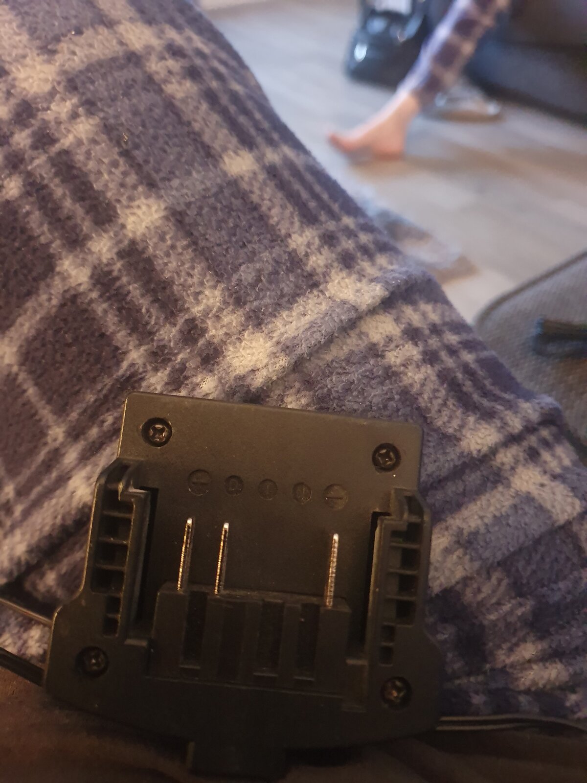

Buy this then as a punt
Right volts but more amps but that don't matter. Volts need to be same and it is
Wire up to battery mount.
Maybe find UK supplier
if the old wart is unusable, you might as well open it up.
a dremel along the seam, perhaps
might be glued, might be ultrasonically welded, might have snap-on (barbed) fixings.
my guess would be snap on. If you cut through one you will be able to see the others.

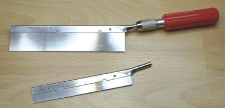

Get in there! I'd use a razor saw if there's a glue line.
You don't need a handle.
Useful things. Smaller blade is finer - 0.2mm iirc.
I suspect there's controlling electronics inside the mains end so you can't use 'any' 21V replacement.
I've tried opening one of those transformer plugs and it's not possible without lots of damage.
Never got as far as putting back together the mangled plastic so it can be used again. Binned it
