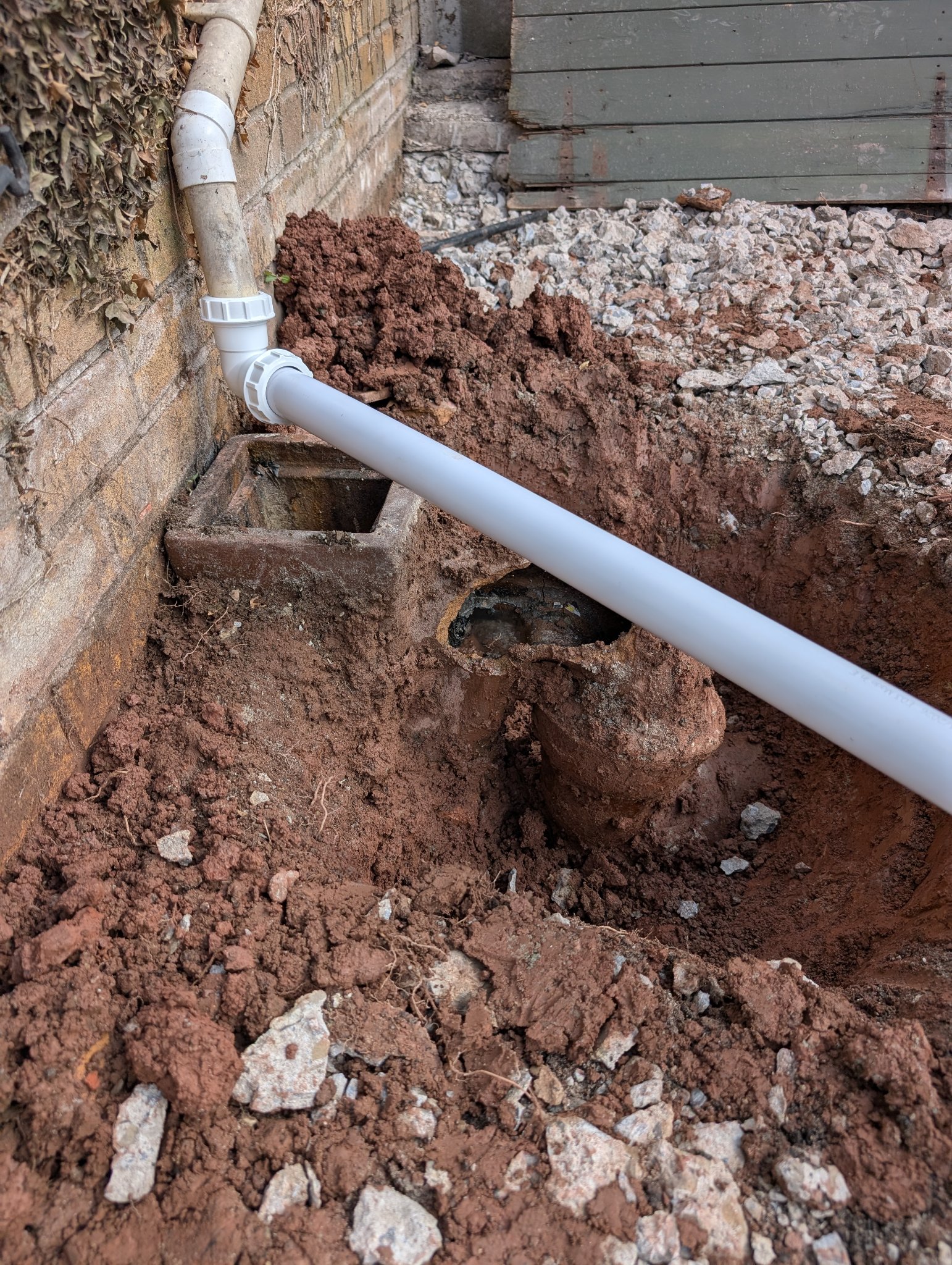

Son-In-Law is renovating the patio area at the back of his house and restoring the surface to be at the correct level (2 bricks down from DPC I believe) by removing all the additional layers that have been added over time. He may (or may not) have damaged this clay gully/trap that would have been installed when the estate was built sometime in the 1960s. The gully/trap appears to have a vertical outlet into a 90 degree bend connected into the soil/waste system.
Ignore the plastic pipe, it's a temporary bodge to take waste water from the kitchen sink and washing machine into a nearby inspection hatch/chamber.

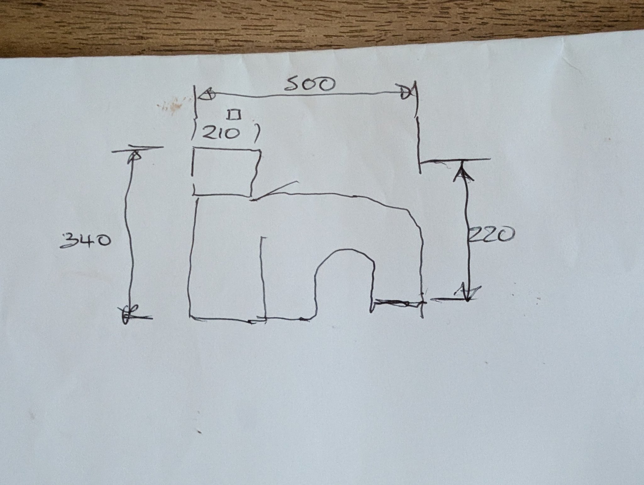

Can anyone shed any light on the make/model of the gully/trap and how we might best replace it, and what with. The vertical outlet from the gully/trap is cemented into the collar of 90 degree bend, so is probably going to be tricky to remove without causing further damage, so and advice on how to do so would also be greatly appreciated. I've attached a sketch of the rough dimensions of the gully/trap

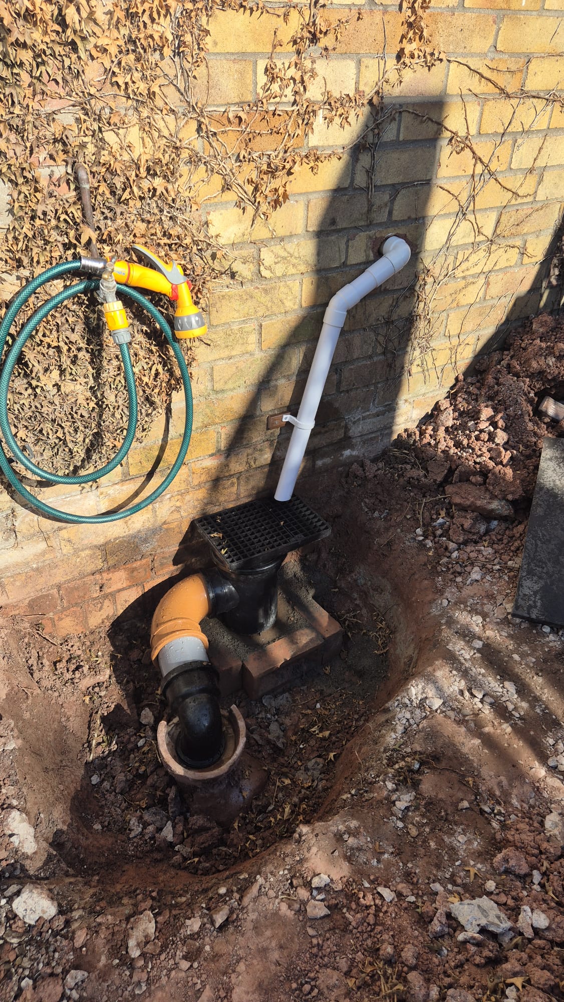

We seem to be making progress. After trying several other combinations of fittings, it looks like we can get everything to line up. I've had to cut away part of the clay pipe collar in order to fit the 90 degree drain adaptor. A straight drain adaptor with a 90 degree bend would push the bottle gully way too high for the intended finished surface level.
Plan tomorrow is to make a concrete pad for the bottle gully and then cut a short piece of 110mm pipe to connect the 90 degree McAlpine Drain Connector to the 90 degree bend from the bottle gully.
Any recommendations for suitable material for filling the collar of the clay pipe? Cement, Silicone, Soudal, Nothing, Something Else?

The nearby inspection hatch/chamber I referred to previously is only a foot or so off to the left on my second photo. It's quite shallow and takes the soil from the bathroom via external cast iron pipework at the rear corner of the house.
The clay pipe taking the waste from the kitchen/washing machine disappears off underground in the direction of the neighbours garden, which appears to have been completely concreted over at some point in the past.
I suspect that both bathroom and kitchen pipe runs meet up somewhere nearby, but there is no sign of an inspection chamber for where these pipe runs might meet up (unless under the concrete in the neighbours garden!).

Hmmm. Looking at it again, and bearing in mind the above comments about 90 degree bends, it looks like I might be able to swap the first 90 degree bend for a 45 degree bend and rotate the bottle gully accordingly. I'll go back to the builders merchants Monday.

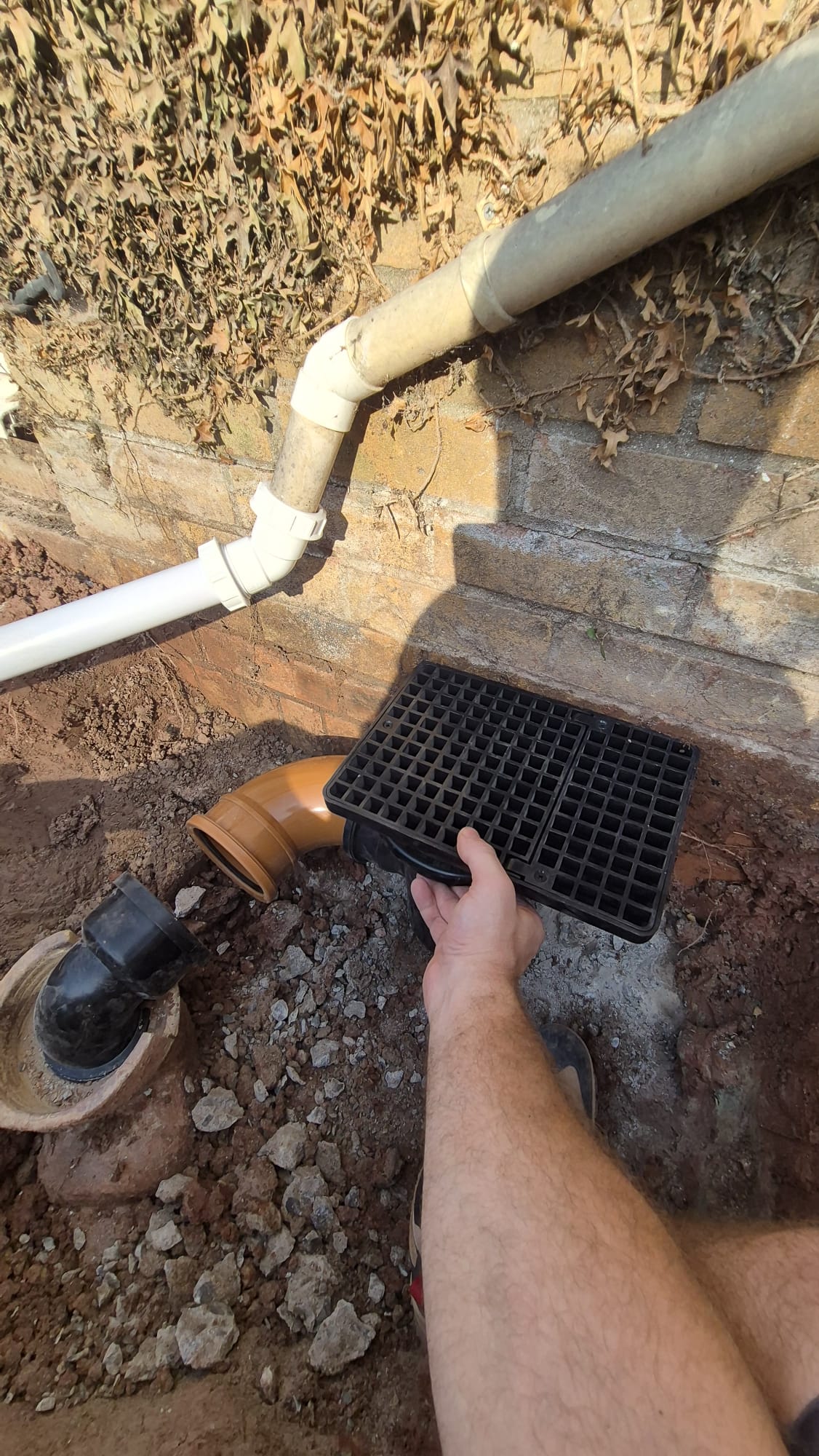

I've now had the night to reflect on my plans, and after finding out that the McAlpine Drain Connector is also not suitable for underground use (aargh!), I have accepted that now I need to stand back and do it properly.
I have now been back to my Son-In-Laws and dug out the area around the clay soil pipe boss ready to cut it to fit a Fernco adapter. He has a mate with a disc cutter larger than the 5" I have, which should help to get a nice clean and square cut.
The measured clay pipe circumference is approx 430mm, i.e. approx 137mm diameter (5.5" maybe). The Fernco AC1602 adapter I got from the builders merchant is a tad too big I think at 144-160/110-122, so I think an AC1362 (121-136/100-115) is the right one to get, but open to advice on this if there's a better alternative.

OP,
1. You have the option for cutting the horizontal drain, and then coming off it at 45* to go up and connect with the gully, street elbow rolled down to meet it at an appropriate angle.

You don't need to cut the pipe in one go. It's usually impossible or dangerous to access with a big grinder anyway, just use a 4" one.
Cut across the pipe top, you'll get about half way down.
Then cut along the top of the centre of the pipe, from your cross-cut to the end. Don't dink the bit you want to keep.
If possible, also cut along the sides from the ends of your cross cut to the end.
Now snap off those two top quarters, with your hand or by gently tapping it with your hand holding the pieces - don't send them down the pipe.
Now you've got rid of the top half, you can complete the cut around the bottom from inside the pipe.

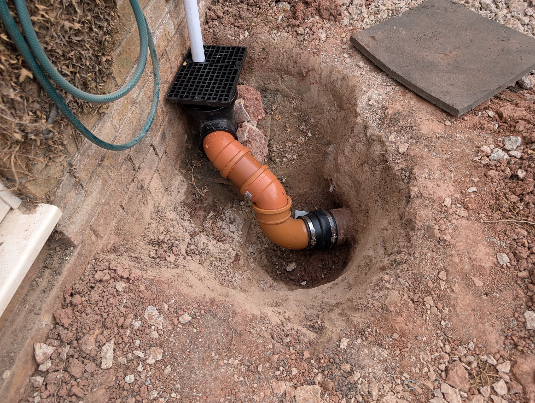

Turns out I had to use my 5" angle grinder in the end, and pretty much did as you said and cut the 90 degree bend into pieces until it came out of the collar on the pipe in the ground, then cut the collar off a piece at a time. Cleaned up the cut edge of the pipe and then put a Fernco AC1362 Flexi Adapter on it. Two 45 degree bends, one 90 degree bend, a short length of pipe and some silicone lubricant later and bob's your uncle.
Yes, it's got a 90 degree bend in it, but there was one there before, so I'm going to live with it.
Got the bottle gully held in place with some rocks at present, so now need to fill hole back in. I'm thinking to fill the bottom of the hole with pea gravel so there's no sharp edges to damage the Flexi Adapter, then backfill with the material that came out of the hole, tamping down carefully at intervals to minimise future subsidence. Again, open to suggestions for best practice here.
