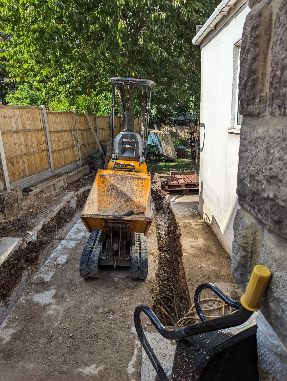

Ok so this is where the current manhole is
And I want to seal it and move it basically straight into the garden, as you can see they have dug down looking for the sewer pipe, we believe it's probably 2m deep.
Southern water have rejected saying we can't build within 4m of the sewer, but the sewer already runs under our building, so it makes zero sense?
The trench on the left of the pic is where we are extending to, and the pallets are covering the trench where we are extending out to, so the new manhole will be located a bit further into the garden than that with a new pipe running back to the existing location.
Oh and yes I submitted multiple pictures, architect drawings, structural engineer reports etc, building control sent everything across and I sent additional information after I done the application on Southern Water build over website. initially their response was that they was going to send a CCTV survey out, didn't hear anything for a week then this update that they have rejected it

The 4m thing is nonsense as the requirement is not to load the pipework. Do your proposed foundations go down past the pipe invert level? I've had a quick look at the company web site and they don't mention the 4m criteria, so is something either not clear in the application, or have things been misinterpreted?
Normally if you design in accordance with Doc H, that's evidence of an acceptable proposal.
For the existing manhole, normally it would need to be removed and pipework adapted, not just covered over and sealed.
Post the drain layout and building footprint.
I've done hundreds of these and all of the water authorities I have ever dealt with - four I think, maybe five? - use a 3m criteria for building near. I've never come across 4m?
One reason for not allowing a build over is a critical or strategic sewer. I note Southern Water describe the line as 'critical' so this may be the problem? However, critical lines are normally 225mm or more? Again, I've never come across an issue building over a 6" line. In fact, most authorities have standing orders for lines up to 6" meaning you don't even need to apply if you can tick off certain criteria.
The normal procedure is to apply sending construction and technical build over details > the authority carries out a cctv survey, which is included in the application fee > they then either approve or tell you what they would prefer as an alternative.
As Jeds says it’s usually 3m not 4m - confirmed on the Southern Water build over page.
Have you checked the list to see if your proposal meets the requirements? And equally check the unacceptable list.
If you meet the requirements then just apply via the self-certification. I doubt a real person is even going to look at the application. I’ve just done mine with Welsh Water (who have near identical requirements) - filled out the self certification, paid my £81, got the acceptance email which I forwarded to my BCO and now I just have to build to Part H.
The only issue I can see, from what you’ve written, is that the foundations may need to be 150mm below invert; which if your sewer really is 2m deep is going to be expensive.

Here's the situation, We applied for a build over, we was unaware at the time that a sewer main runs through the back garden, it's approx 5m deep and 1.9m from the rear of our property.
SW were supposed to send a CCTV survey out but wanted us to wait 3 weeks so we got our own done and submitted it to them.
SW rejected our application initially because the manhole to the side of our property would be moved as it's going to be built over.
We redrew our plans and discussed with the builder and Southern Water that we could remove the manhole, fit a new pipe to the sewer pipe from the manhole with a rubber sleeve etc and have the new waste connect into that plus add a rodding point, and it seemed they were fine with that as our neighbours have a manhole.
However they then replied that they still won't agree as upon further inspection the sewer main in the garden is approx 5m deep and thus deemed "Critical by depth" and no building within 3m of this.
The survey shows the main being 1.9m in the garden, we had dug out footings, ironically right on top of this main!
So they are basically flat out refusing to let us build unless we divert the sewer main, which I estimate is going to cost more than the actual cost of the extension!

FIVE metres deep!! Fudginell, no wonder thy are concerned. That must be one heck of a trench. :oops:
Footings are the standard depth though but they flat out refuse to let you build within 3m of their 5m deep pipe, it's ridiculous really.
