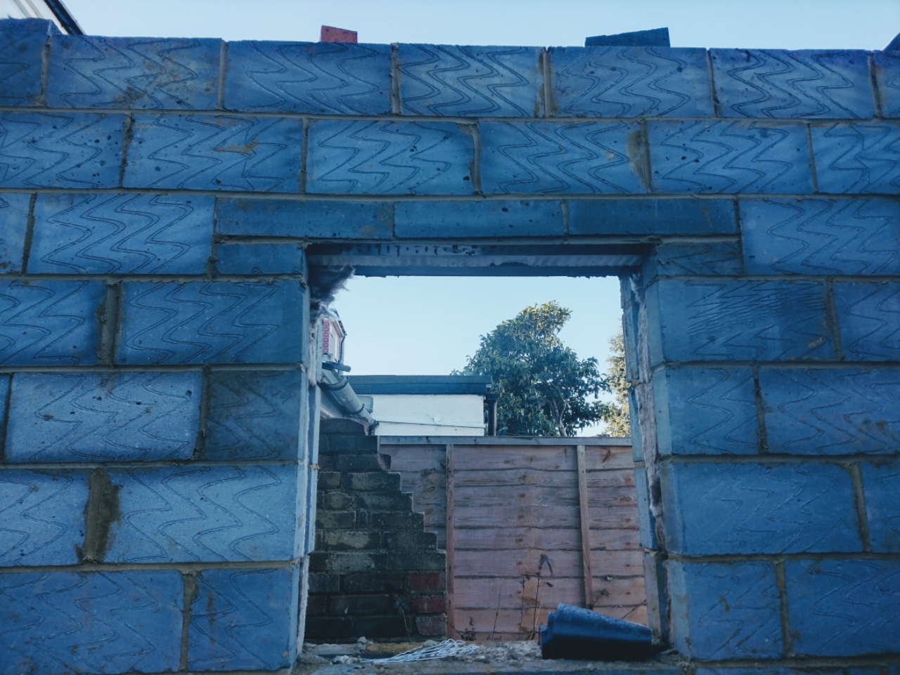

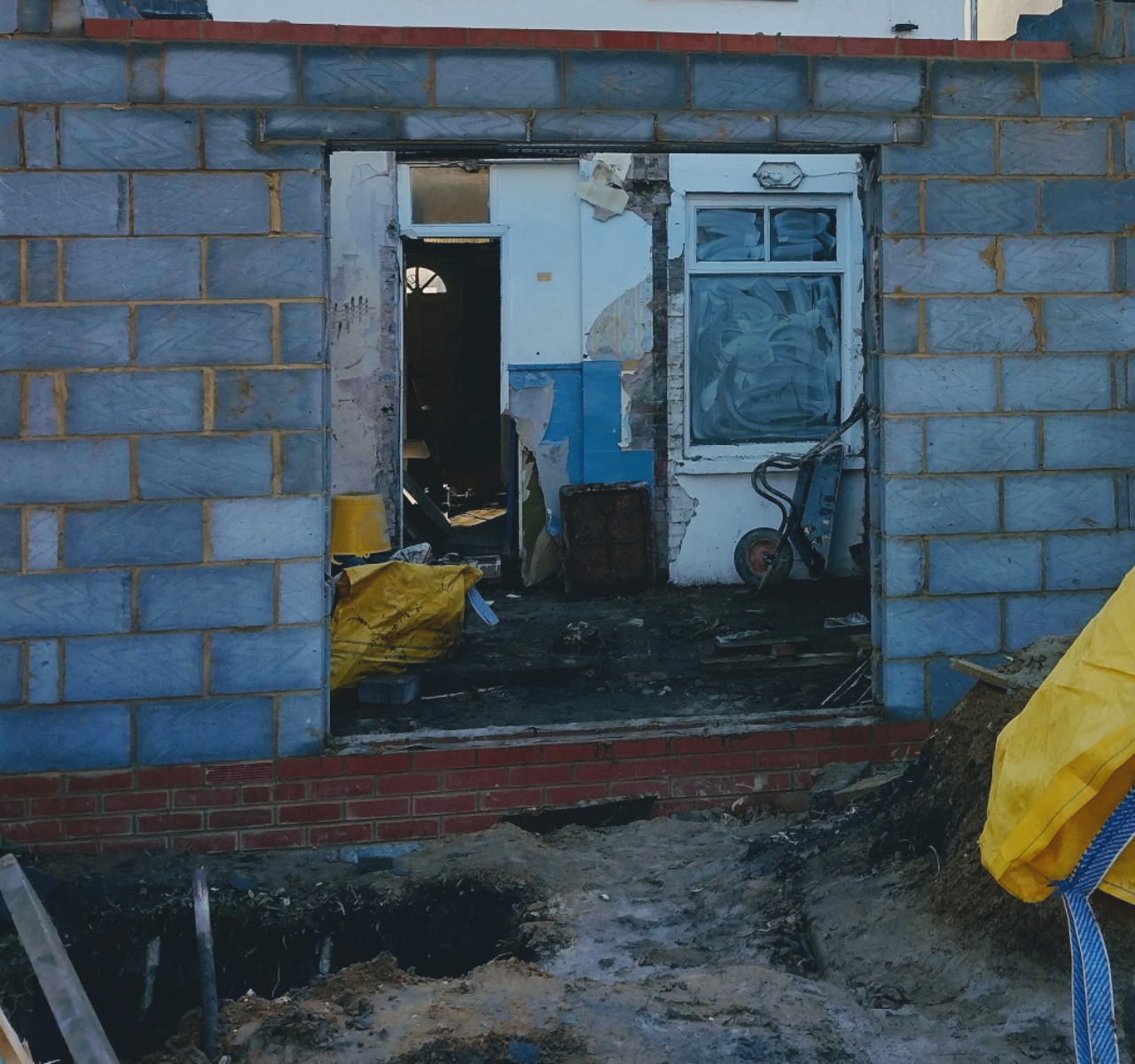

Getting an extension built and I noticed that the builder/ bricklayer didn't add a cavity tray
They simple installed the lintel and built up the wall above (see attached images). What I want to know is what is the best way to rectify this issue?
The first image shows the opening for the patio door. The second image is an opening for a window.
I am looking for a good solution, which would be the least disruptive (if possible).

I say this not knowing exactly what cavity tray does - but if you need it then:
While it is at this stage, remove the bricks above and redo it with the cavity tray.
Don't mess about with half assed unsuitable resolutions - do it properly.
He'll probably be OK as you say, however waterproofing costs a few £s to fit first time round but £800 or something to rectify if there is a problem. Why should the homeowner take that risk?

Looks to me like you have a standard Catnic CN/ lintel coupled with Dritherm insulation. Any wind driven rain eventually percolating through, with be deflected back down the cavity along with the rest.
