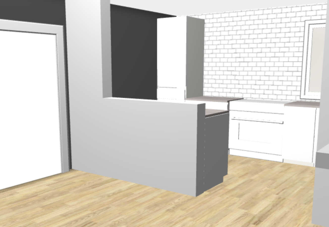

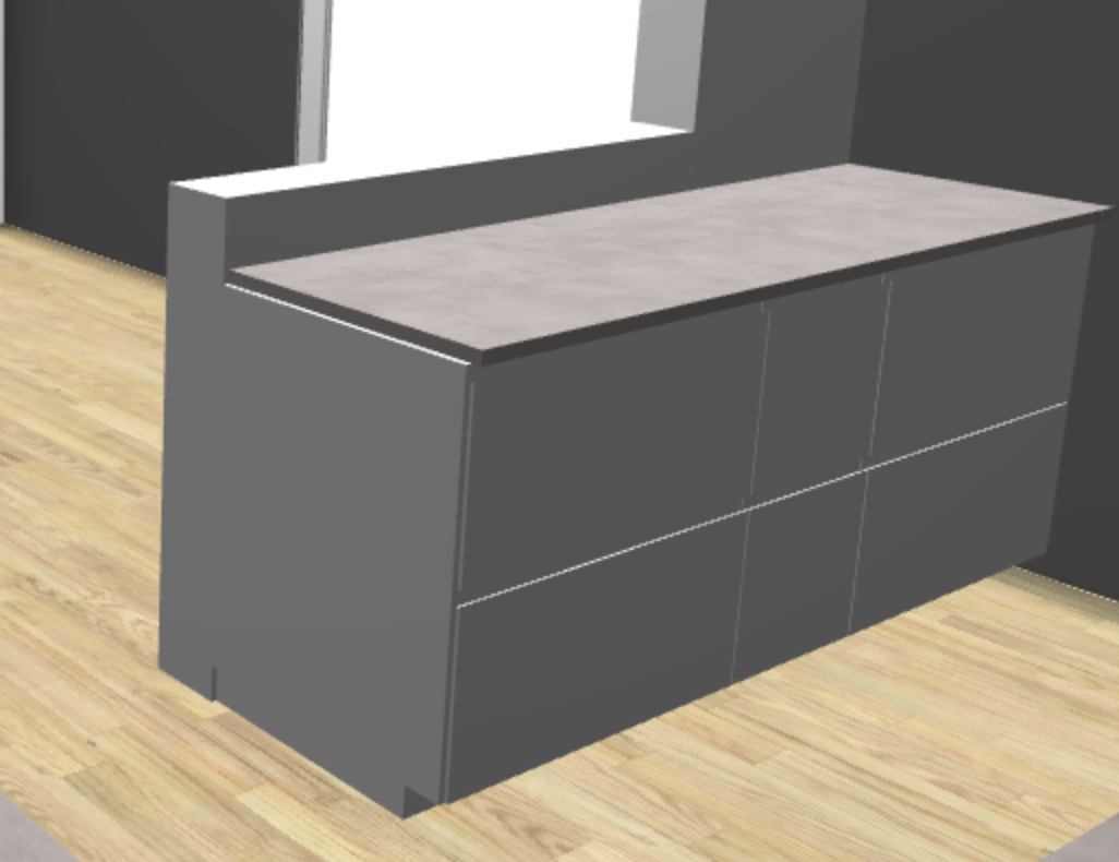

Hi everyone,
I am getting a new kitchen installed and need to build a half height stud wall to attach some floor cabinets onto. The kitchen is going to be from Ikea. In the attached photos from the planner, I will only be building the half height part, the other small bit of wall already exists and is masonry.
I have found this video which seems to be exactly what I'm after, and think if I built something like that, that it should be strong enough to hold the cabinets:
I was wondering if I could run a few questions by anyone who has done this type of thing before.

For maximum rigidity...
1. DON'T use a nail gun - the joints will not be rigid enough in my experience. For best rigidity you need to pilot, countersink and screw the frames together using 5.0 or 6.0 x 100 screws.
2. Use 4 x 2 rather than 3 x 2 for the framing if you can. Either way use a dry, regularised (or better) timber, NOT rough sawn carecassing or the like. Select for straightness. 3 x 2 is the bare minimum size. Joinery grade planed redwood is stiffer than whitewood or failing that C24 structural graded softwood is stiffer than C16 or ungraded
3. If the floor is masonry use Rawlbolts or resin anchors to fix down. If timber use coach bolts into drilled steel plates on the underside. Preferably add an 18mm plywood mattress to the underside of the floor before bolting down (sits between underside of flooring and steel plate). Failing that fix to floor with something like 10mm coach screws at 200mm centres through large square washers.
4. Where possible fix to masonry walls using brown plugs and 5.0 or 6.0 x 100mm screws (7mm holes) - leave the plaster on and go through it. Unless it's really thick lime plaster you'll be OK
5. Use timber wedges beneath the sole plate at each bolt to plumb up the frame before finally tightening it down
6. Clad the faces of the frame with plywood, glued and screwed before plaster boarding. 6mm ply is adequate, 12mm is better (and allows cheaper OSB to be substituted for plywood). This gives you a structure to carry your cupboards if needs be. You may be able to get away with ply one side only, but TBH if you do you'll need to.use thicker PB on that side. PB needs only to be the thin 6mm stuff where overboarding ply/OSB as it contributes no strength
7. Don't skimp on fastenings
8. Skirt out as if it is a wall
9. Skim is normally 3mm these days. For tighter spaces go to taper edge boards and tape and joint instead
Based on building more pygmy walls than that over the years in shops, restaurants, hotels etc where they need to be rigid and durable
