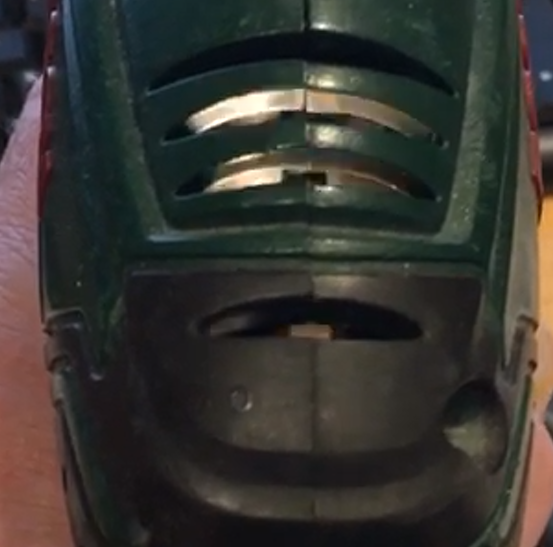

burning smell
Because it's broken. Could be motor windings, armature, bearings, gearbox, shorted wiring. If you have sparks from the back end it could be the brushes.
As @cdbe says, could be a number of reasons but all leading to indicate drill has been overworked at some stage and not maintained.
I'm assuming its a corded 230/240 volt drill and not a cordless battery model?
First step is to check the carbon brushes. Make sure they are sliding freely in the boxes. Check for length and that they are touching the commutator fully. Is there a build up of carbon dust between the segs on the comm? Is the comm a dirty black or dark brown colour? How about the coil windings? Looking discoloured or burnt? Same with armature windings.
These are basic checks to be done before even thinking about checking resistances, earth leaks etc.
It does sound as though it has developed shorts though, and if this is the case, don't expect it to last much longer if it is in regular use.
yes, sparks at the back and smoke
cordless battery model; I bought a replacement which I use but just wondering if it worth repairing
photo attached

I would guess that the brushes will be less than a tenner but that you may pay a fiver for postage. Factor in your time to open the machine, fit the brushes (and use webrax to clean the commutator), and then reassemble the drill.
Then decide if it is worthwhile fixing it.
If you enjoy fixing things, then go for it. If the 30ish minutes to fix it deprive you from doing something else you would rather do, perhaps bin the drill.
