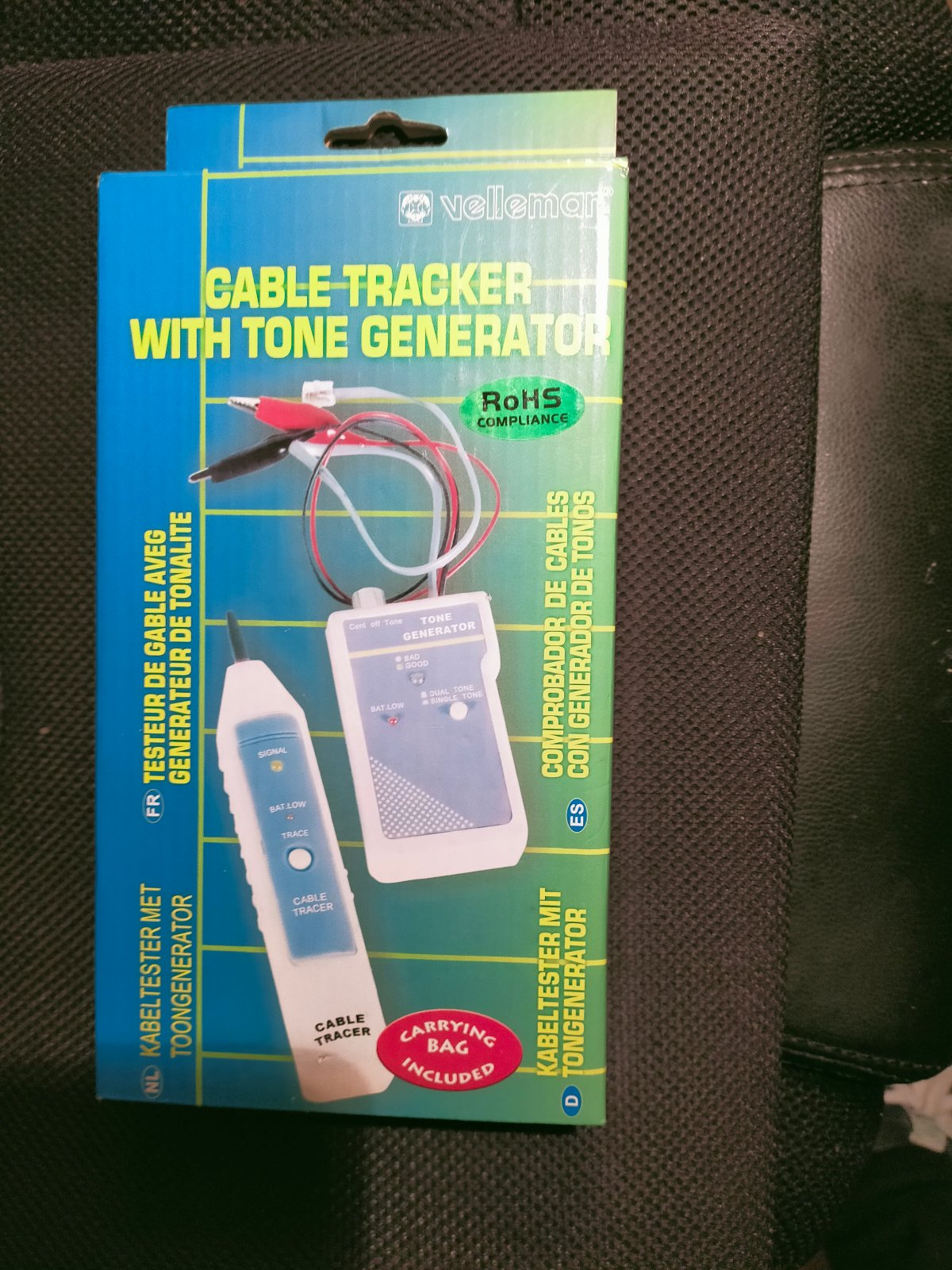

I have been given a "Cable Tracker with Tone Generator" which is brand new and still in the box (BNIB).
What is this used for (polite replies only, please)?

Ok for a an example….you had a cat 5 cables in your house 1 point per room …x10 that all ran to a common point that hadn’t been labelled up …you clip on the tone generator at room 1 , go to the set of 10 cables , run the probe done each of the ten cables one of these should give you a tone …
That’s how it works

These testers clip onto a cable and basically turn it into an aerial. You can pick up an audible signal when you get the receiver to within 50 mm or so of the cable. Great for tracing unknown cables in walls. This one looks like my Testboy 26 in a different case. It’s great but it does have one downside. The sender needs to be connected to two wires which mustn‘t be shorted nor earthed. So if the wires you‘re trying to trace are shorted together in an unknown or inaccessible place you‘re out of luck. It’s also supposed to be able to withstand up to 400 V for tracing mains circuits without disconnecting but there’s plenty of reports on blown-up units on the internet so I‘m not going to risk mine.

I want one of these, would be very handy at work when I have to find where the other end of a cable goes in the building.
I might get one eventually.

They can save you an awful lot of time, following cables.
That's why I want one, they are about £25 on Amazon so imo worth it, I may even get work to pay for it.

I have an ex-BT version, it's very sensitive, anywhere within a couple of feet (adjustable), and it will pickup the tone. Only thing is, the transmitter, is only safe connected upto 150v live cable, but why would you connect to a live cable?
You wouldn't - there are some specifically made for that.
These cheaper ones specifically say not to.
I have just checked amazon and found one with loads of adapters (not just 2x crocodile clip leads) so it can be plugged into RJ11and RJ45/BNC sockets etc.
Usually because you want to identify a circuit without turning anything off (connect the sender to a socket and run the receiver along the MCBs in the DB).
