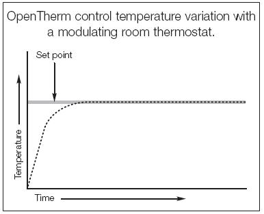

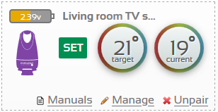

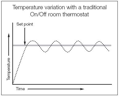

But for it to work, the lock shield valves need to be carefully set, as I said speed is important, Flat Battery TRV.jpg the electronic TRV gives one target and current temperatures, if the current exceeds the target then the lock shield valve is open too much. Using on/off control, we get a hysteresis Temp_variation_on_off.jpg using analogue control we get a smooth graph Temp_variation_OpenTherm.jpg it is easy enough to realise we don't want valves which simply turn on/off.
