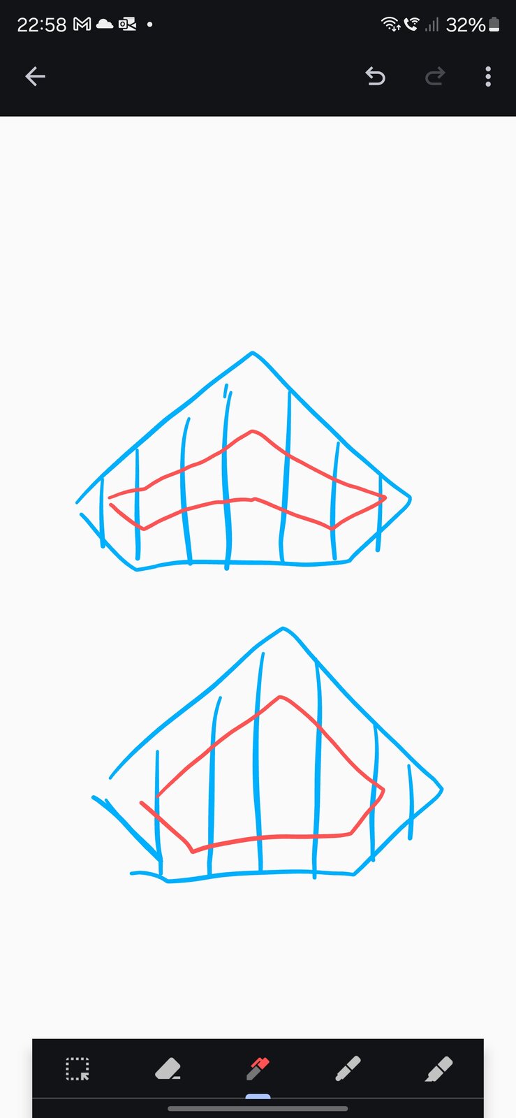

According to the regs cable routing through joists are 0.25 - 0.4 of the joist length from bearer. This looks logical when your joists are the same length however where the building is triangular and joist different lengths then 0.25 of the length from the bearer is different distances, which then looks illogical.
What is the correct way to route cables through joists that are all different lengths?
thanks.
Nothing more than it just looks odd, the cables don't run straight parallel to the wall as you would expect with joists that run perpendicular to the wall of the same length. With different lengths of joist the cable tapers from closer to the wall on the smaller joist to further away for the longer ones.

The CORRECT way would be to use the joist formula on every joist, regardless of how their lengths differ.
The span rules we use are just a quick ready reckoner sort of thing really, if you follow them then you should, in practice, avoid all the pitfalls.
You can, if you wish and have sufficient knowledge, calculate sheer force and bending moments to prove acceptable but if building control has any oversight on the installation then they will want evidence of your calculations in order to check their validity.

So, how long are these joists, how thick are they and have the relevant calculations been done to prove/disprove suitability?
