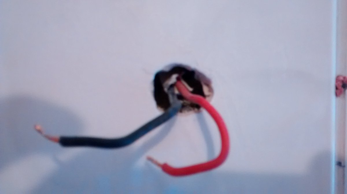

Hello forumites,
I had a Vysal Shaver Light cum Dual Voltage Charging Socket which was working perfectly until the builders opened it up for Tiling. Now, after they re-connected, it doesn't work. I bought 2 new Shavers and none would work either. On checking, I found that they do work when connected to a different point. So, the cables coming out of the wall are damaged.
There are Live, Neutral and Earth cables coming out of the wall. However, the Vysal being double isolated, only Live and Neutral were used. Since the Tester glows on the Live, I doubted that the return path was damaged / broken. So, after testing with a multimeter, I find no Voltage across the Live and Neutral, whereas around 240 V across Live and Earth. So, wondering what are my options now and if the Earth can be used instead of the Neutral ? I am not too bothered about charging, as I can always use another socket with adapter. It's the Light that is more important to me. Any suggestions please.

You may absolutely NOT use the earth as a neutral. If you have an RCD you can forget about that plan anyway.
Chances are a cable has become disconnected (it could be damaged), did they/you also take the bathroom light down to decorate? It could well be supplied from there.
Firstly, where does the cable come from?
You really should check that the other end is still connected.
You definitely cannot use earth as a return.

It could be broken, if a piece of twin and earth flexes backwards and forwards on itself too many times, or is exposed to too much force, it will break. Particularly if it's a bit old and more brittle than when new. It could well be broken in the backbox where the sheath has been removed, you'll be able to tell by gently moving the neutral backwards and forwards/up and down and there will be zero resistance and it will bend at a clear point, rather than moving the whole conductor (power off of course)

Not sure where the break is ? I have tried moving the Neutral backward / forward, but it is stiff and not loose.
One alternative is to take a new Sheathed Cable from a Socket in the Loft through the hole (if that can at all be done) for the Shaver Light ?

If you have located the cable, surely the other end can also be located?
It's then a case of removing the old cable and installing a new one. No need to waste time trying to find where it's broken or how the rest of the circuit is wired.

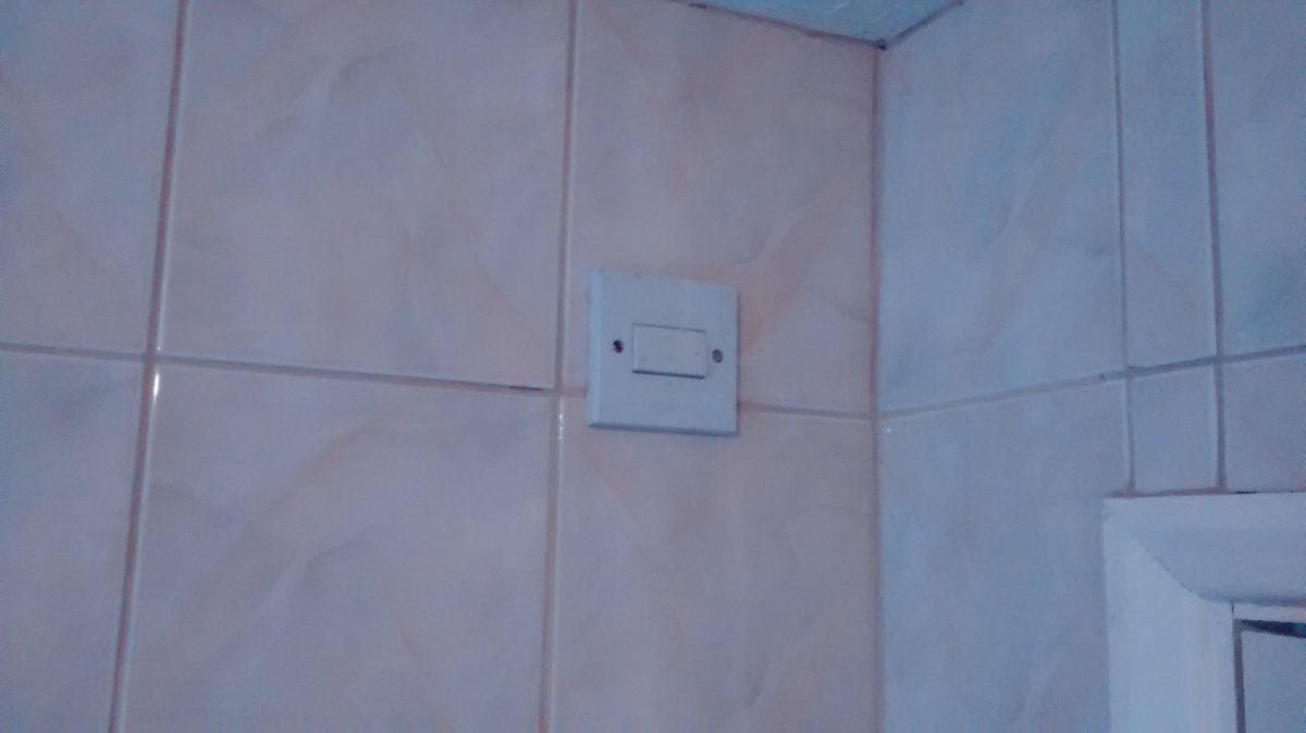

I'll upload photos soon. Just to clarify, the pull chord switch operates just the main bathroom light and also the extractor fan (which has a timer), so the fan comes On when the light is On and goes Off after the light is switched Off. There is a separate switch to turn the fan Off completely.
There is no separate switch for the shaver light, just an inbuilt one that comes with the Shaver Light.

Have you looked at what's going on in the isolation switch on the wall?
