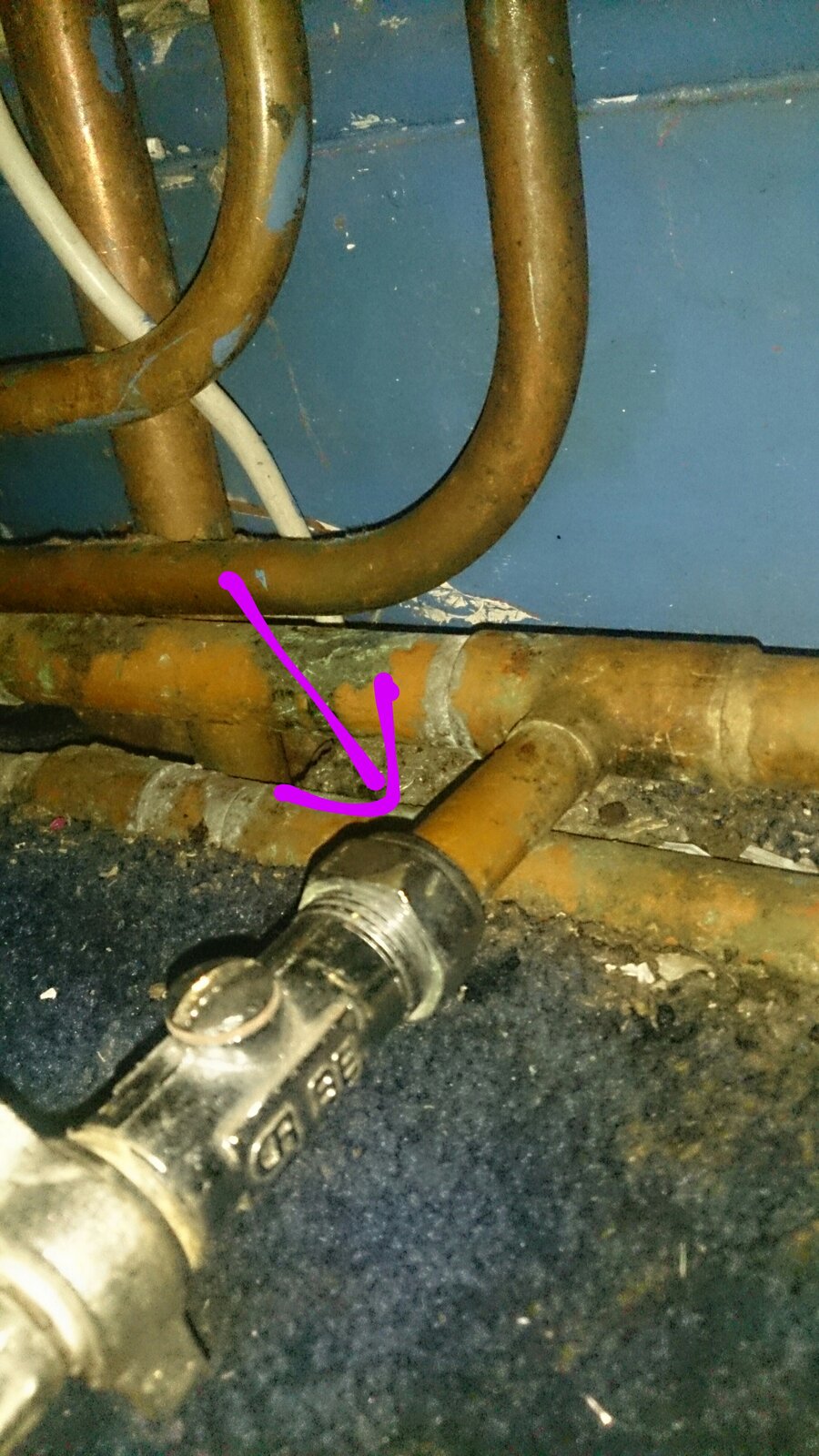

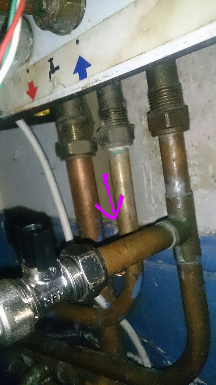

I've got all the bits now for an external, but Im not really happy about cutting into the copper pipe , can I put a t compression joint at either of these points? I'm not sure where the return is, is it likely to be at either of these points? picture on left obviously from main pipe picture on left into the boiler from loop

Can’t on one as it looks like it’s the cold main in for the hot water, well you could, but it won’t solve your issue :LOL: . The one near the 22mm pipe seems better choice, however do it after the filling loop valve.
I've had a better look, they are actually labelled, cold water in (tap) hot water out (tap) there's another 2 with a radiator symbol, one red, one blue, I turned the heating on and the red one got hot well before the blue so I'm assuming the blue is the return seems to go to the pump, does this sound right, looks like I will need to cut into it after all as the loop is attached to the feed not the return.
