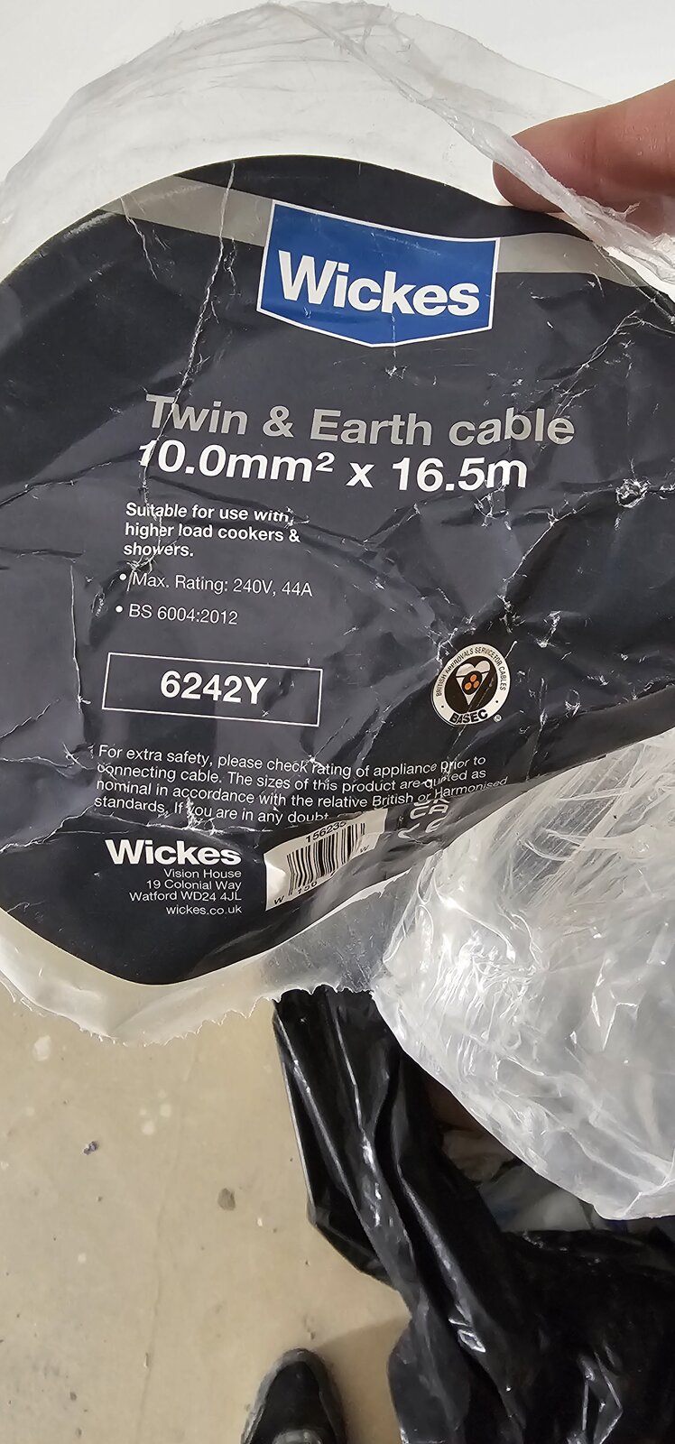

I put an original post before where I was asking if my newly bought oven would suffice on a 15amp normal plug. There were some 'possibly's' but mainly it was no due to safety.
So i just spent the night with my cousin Routing through a 10mm² 44amp T+E cable from the garage to the kitchen, following existing cabling and going through the upstairs floorboards (it's not actually connected, will get a qualified electrician to do that)
So I believe that this cable can handle upto around 10,500w (44a/240v).
My oven is 3,950w (which is why I upgraded the cable in the first place)
I have no idea how this all works but does that mean I potentially have another 6,000w to 'play with' because I was thinking of changing from gas to an induction cooker and I believe that at some point they will both be running concurrently so hence why I assumed I would have to add up the W, and that both maximum W cannot exceed 10,500.
Sorry if this sounds stupid but just thought I'd check before I go to a sparky so that at least it looks like I understand what I can or cannot upgrade to. Thanks
You're fine. Diversity for a domestic cooker (hob and oven, either separatly, or as one appliance) is 10A + 30% of the rest (+5A if there is a socket on the cooker switch)
10mm² T&E can carry 64 Amps but you only need 4mm² for a 32A cooker circuit (method C) although everyone uses 6mm² and because of diversity is adequate for 20kW of cooking appliances or 16kW with a socket.
The cable rating depends on installation method. There is a PDF chart here to show rating it is common to use a twin cooker connection unit and power two appliances from one supply.

Not sure why the op thinks 10.0mm2 cable is rated at only 44amps.
Sorry, saw the 44a and assumed that's what it meant lol
It might be a C Y A exercise by the manufacturers/retailers but in many instances depending upon how/where the cable is actually run it will indeed carry far more than they have said.
No.
Pretty much any combination of domestic electric cooking appliances can be connected to a 32A circuit.
That could be any of
standalone electric cooker
single oven and hob
double oven and hob
2x single ovens and hob
single oven, combi microwave and hob
6mm² is plenty for that, and 4mm² could be used in some circumstances.
10mm² is grossly oversized.
