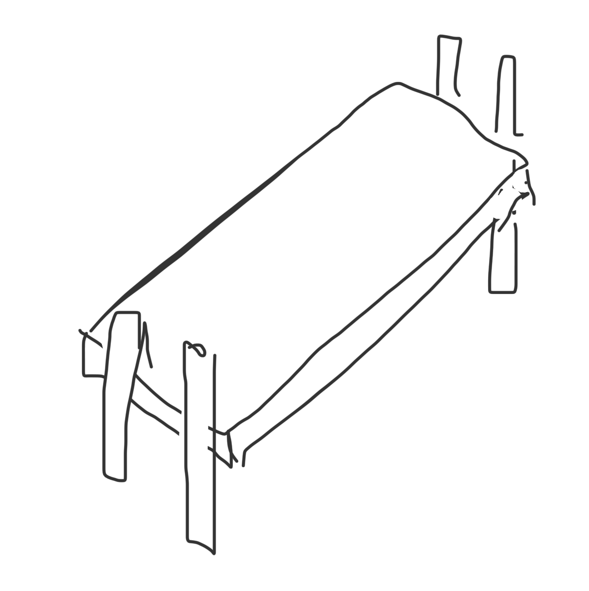

Make 4 legs and screw to door ends.
Paint one side of door with mini roller then flip over and paint the other side.
By this wayners means to remove the door, screw 4 bits of wood to the ends , so they stick out each side then the side can be painted and the door flipped and painted again, and have two wet sides simultaneously
If doors are not hung, I use a similar method.
I stick two screws top and bottom and rest them on 2 pieces of wood on the table.
You then need 2 people to turn the door over though.
The 4 legs work better, but I use a spacer where the legs are screwed so they don't touch the door edge and there's no risk of sticking.
