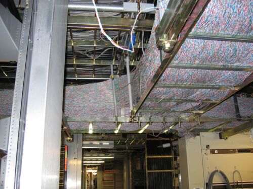

Someone really needs to re-asses their network structure...
Urgently.
