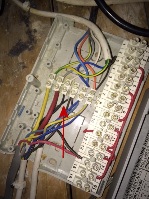

Below is the photo of my junction box. I notice that one wire, indicated by the arrow, isn’t connected to the choc bloc. I removed the single wire that is in the choc block, expecting to see broken bits of wire from the other cable, which would have indicated that the loose wire was was originally connected and had been snapped off, but that wasn’t the case, so I have left it as I found it for now. Perhaps that wire is the cause of the problem though? The junction box is in a position where it can easily get knocked, so it’s feasible that’s what has happened and a wire has come loose, but I don’t want to wire it up without being certain.
Do you have a multimeter? You'll need to be able to measure a few mains voltages to sort this out. That's a nice big wiring centre but the very useful labelling and all those terminals for the controls etc have been totally ignored. :cry:
With Heating Only selected on the programmer and the room thermostat calling for heat, you should have 240v on the 3 port valve Grey, White and Orange wires.
Than set the programmer so everything is Off and recheck those voltages. The only one to remain Live should be the Grey.

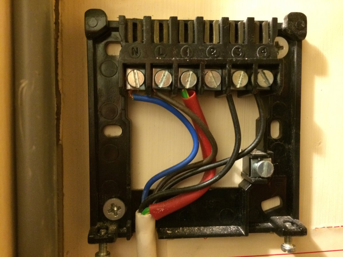

There should only be a live on the white wire when the central heating is required. It should not be there when the heating is set to off at the programmer. The tricky part is to find out why? What happens when you remove the programmer from its backplate.
@stem

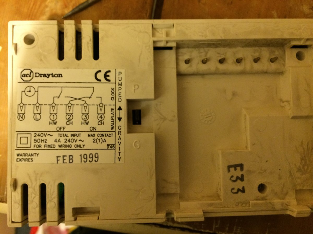

With the programmer removed, multimeter reads 240v on orange, 30v on white and a small current of about 5v on grey
Think the programmer could be the issue?
I just turned the heating on then off and I'm getting 240v through orange, white and grey. Actuator lever is still on H.
I then removed the programmer and the lever moved to W. Now getting 240v on orange, 30v on white, 5v on grey.

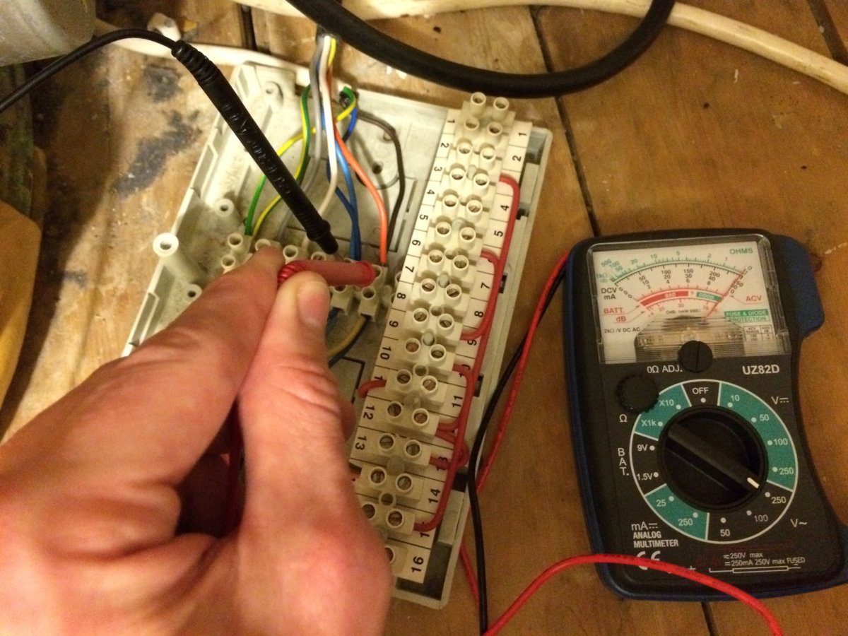

Just to make sure I'm not being thick and giving you bad information, I've added a photo of the reading from the orange wire with the boiler turned off completely and the programmer off.
Also, now with everything off, the pump still seems to be running
No problem there, that's exactly how to make the measurement using Neutral as the reference.
