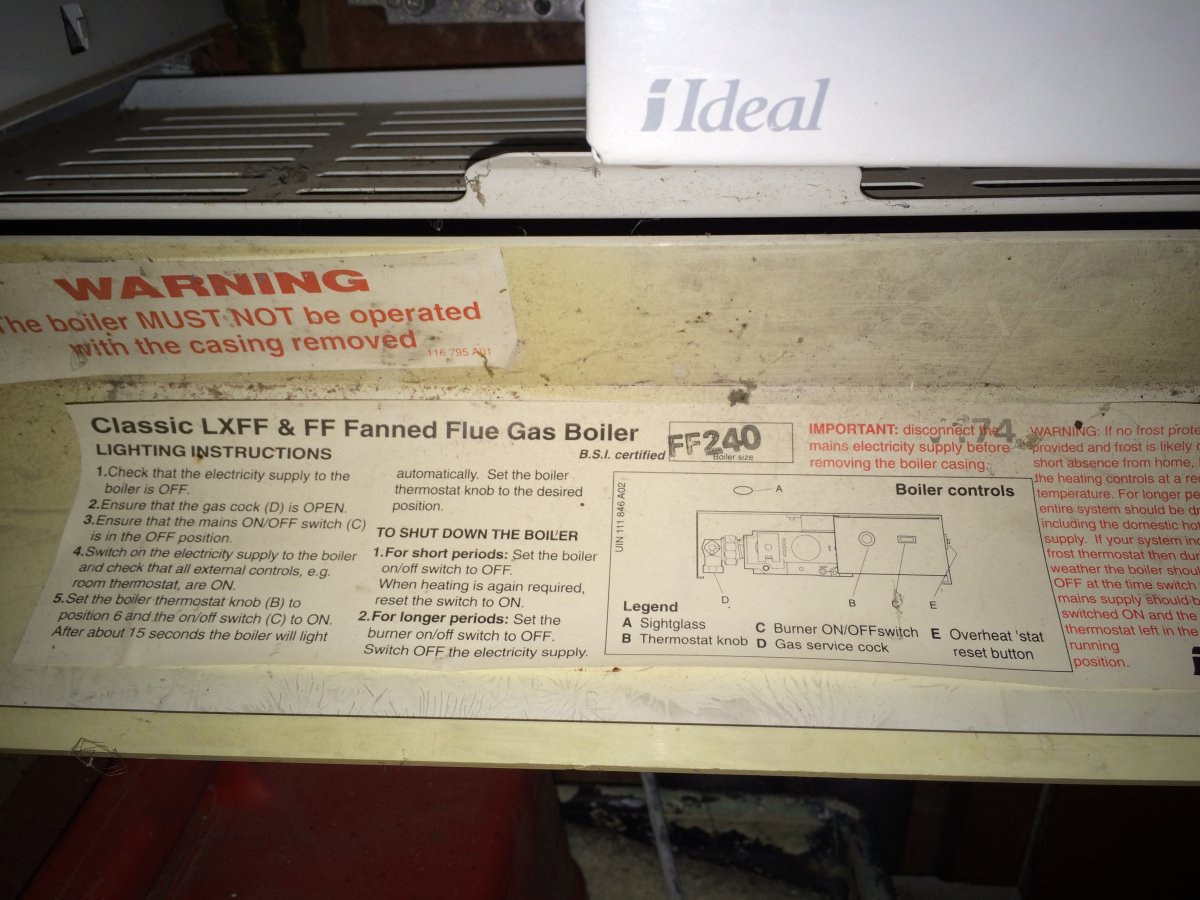

It's an Ideal Classic which I would guess is 20 years old. I'll check exactly which model when I'm home
It probably doesn't need a permanent live then, but best for you to check.

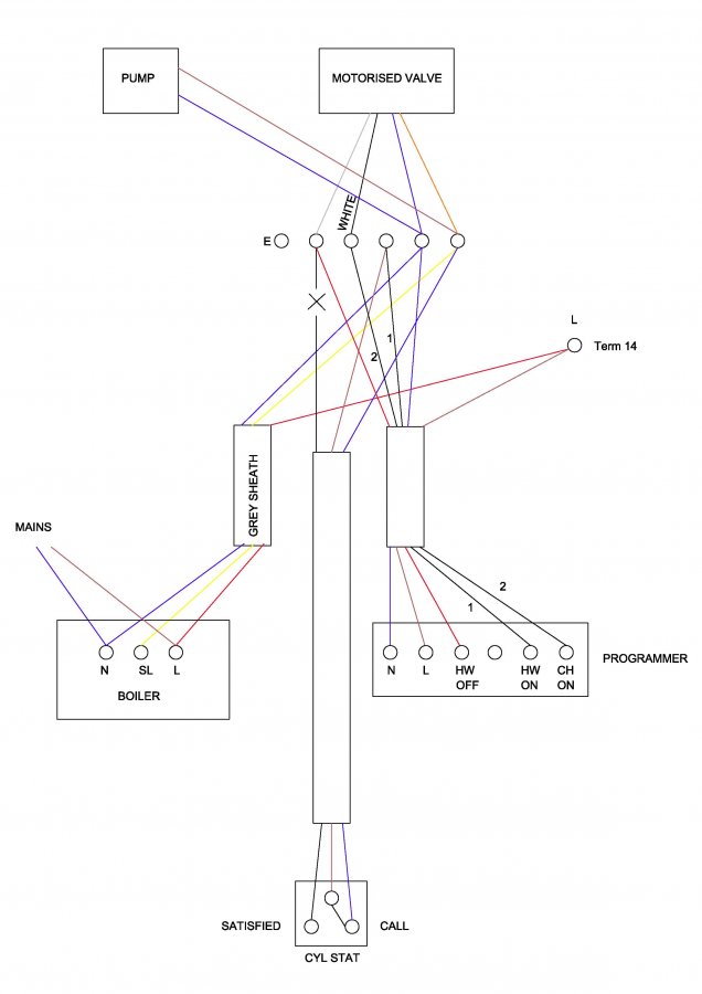

I will give the "demand signal" some more thought when I can focus a bit more. It is an odd fault and I'm wondering if there is more than one problem at play here. If rgi-1980 could confirm at some point that the wires do go to the terminals as I have shown them and that there are no other connections anywhere, that would be helpful.
The wires are as shown in your diagram

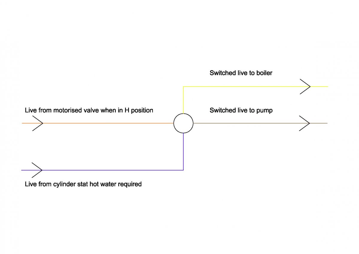

There is something odd here, and that relates to the yellow wire which you say shows 240v when it is disconnected from the other wiring. I would not expect to see any voltage there. Bear with me on this as I'm not too good explaining things in writing, but I will have a go.
In installations like yours, the yellow wire would normally be used as a 'switched live' to the boiler, and indeed, based on that assumption, your photographs show exactly what I would expect to see, as follows:
1. The yellow wire is connected to the orange wire from the motorised valve. The orange wire is made live by the valve when it winds to the H position and provides the 'on' signal to the boiler via the yellow wire when heating only is required.
2. The yellow wire would also be connected to the cylinder thermostat, so that when hot water was required the cylinder thermostat can also start the boiler.
This is what I see in your photos and is exactly what I would expect.
So far so good. However, in your case:
Yellow wire is temporarily isolated......With CH only selected, the pump comes on, the boiler fires and the radiators are getting warm.
The boiler should not be running with its switched live disconnected, but it would appear that it is. Are you really sure that the boiler actually fired up, or was the pump just circulating already hot water it contained? [The pump would still run if it was still connected to the motorised valves orange wire.]
This raises the following questions.
1. Why is the boiler running when the switched live supply appears to be disconnected?
2. Where is the 240v on the yellow coming from?
3. Is the yellow actually being used as the boilers switched live? if not what is?
When you get chance, can you confirm that my last sketch shows the wires from terminal to terminal as they are actually connected, and can you find the other end of the yellow wire and tell us what it is connected to or post a photograph please.

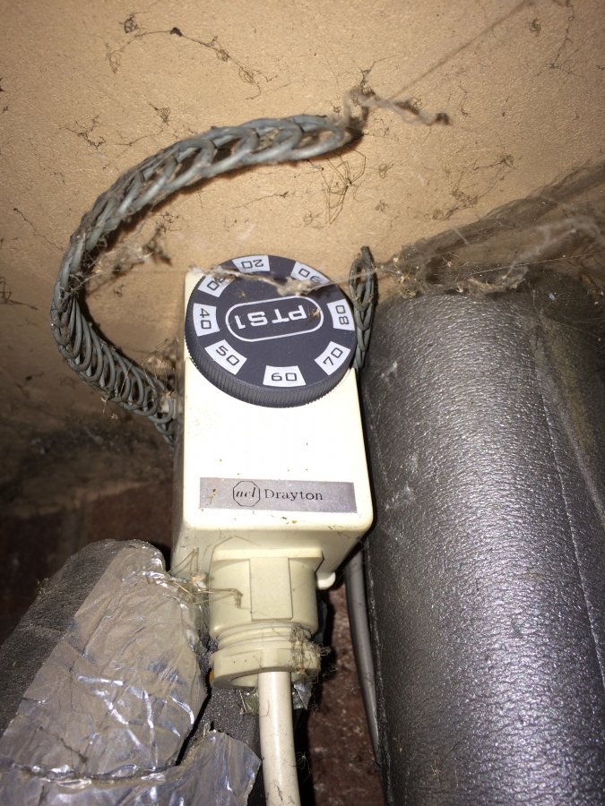

Is there a frost stat in the garage near the boiler maybe this is what's making the yellow wire live. If there is check what it is set at.
This is connected to the boiler in the garage. I've never noticed nor touched this before. My photo shows it set to 60.
I turned this down to 20 and noticed there's no voltage going to the yellow wire. Turned it back up to 60 and get 240v on yellow wire.
So that's what the yellow wire seems to be connected to.
I've wired things back up as they should be and turned the stat in the garage right down and everything seems to be working as it should be.
So I'm guessing when the boiler was being checked they turned that stat right up to keep it running and forgot to turn it back down. Then, completely coincidentally, I had a problem with the valve and a loose wire, which confused matters.

It's a bit of an unusual way to wire a frost thermostat. Normally there is an air thermostat to sense when the air temperature falls below 5 degrees and turn the boiler on. This is then wired in series with a pipe thermostat on the boiler return pipe that turns it off again when the circulating water temp reaches 20. Probably yours was a later addition and wired directly across the boiler terminals for ease.
If you only have the pipe thermostat, when the temperature of the pipe falls below that, the system will switch on, which in a garage (unless it is very well insulated) I would imagine would be fairly frequently, so I'm surprised that in 13 years you've not noticed it coming on in the middle of the night before. Anyway well done to johnmdc for spotting it. It did cross my mind briefly, but I discounted it because there was no sign of it wired into the junction box, and I've never seen one directly wired across the boiler terminals. Also, at the time the weather wasn't anywhere near cold enough for a frost thermostat to cut in. Unlike today :(
