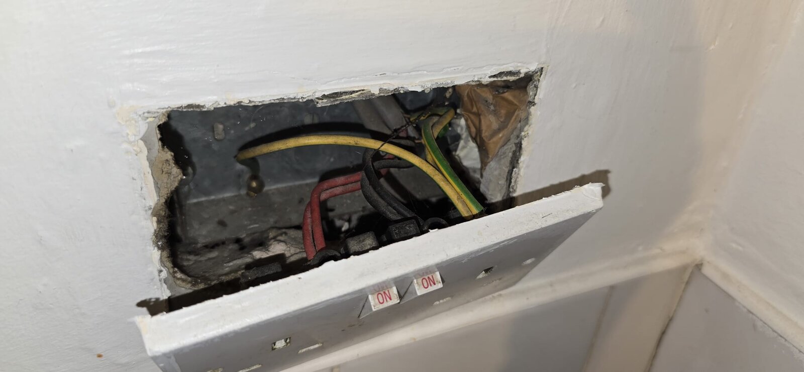

Change 2 Gang kitchen socket to 4 gang
This looks promising.
Ive decided to add 3 sockets (a second 2 gang to the ring, and 1 gang as a spur - for other kitchen tools).
I've noticed on their site they have a 2+1 too.
So the big question:
1. Is it better to have 2 +2 gang then a single one. Or add a 2 + 1 gang.
2. given how old the current box is and how deep set it is, is it better to try and replace the old one with dry lining box. (This would then have a gap between all gangs).
I took off the socket below the CU. It's definitely a ring. Quite old, given the red and black wire.
I also worked out why the detector didnt pick it up. The back box is set quite deep. Also the wall seems to be made of something really thin.
My thinking is, take out one of the connections, extend the wire for a ring, then use this Lap backbox (which should be indiscrimate of depth and the thickness of the wall) to add a second 2 gang about an inch apart from the original.
I might also add a single spur off the new 2 gang for the occasional appliances.
Definitely a ring unless it's actually definitely a radial. Or perhaps neither and just installed incorrectly, i.e. supposed to be a ring.
They do other layouts as well and to my eyes it looks better without a gap between the faceplates and as you are going to add other sockets you can have all five in a row
if you decide to go the dry lining box route, scolmore do a little gizmo that allows dry ling boxes to be joined at the correct spacing and in theory you could have dozens all in a row using it.
you do have to use their dry ling boxes though. I have used it to join two doubles and two singles together

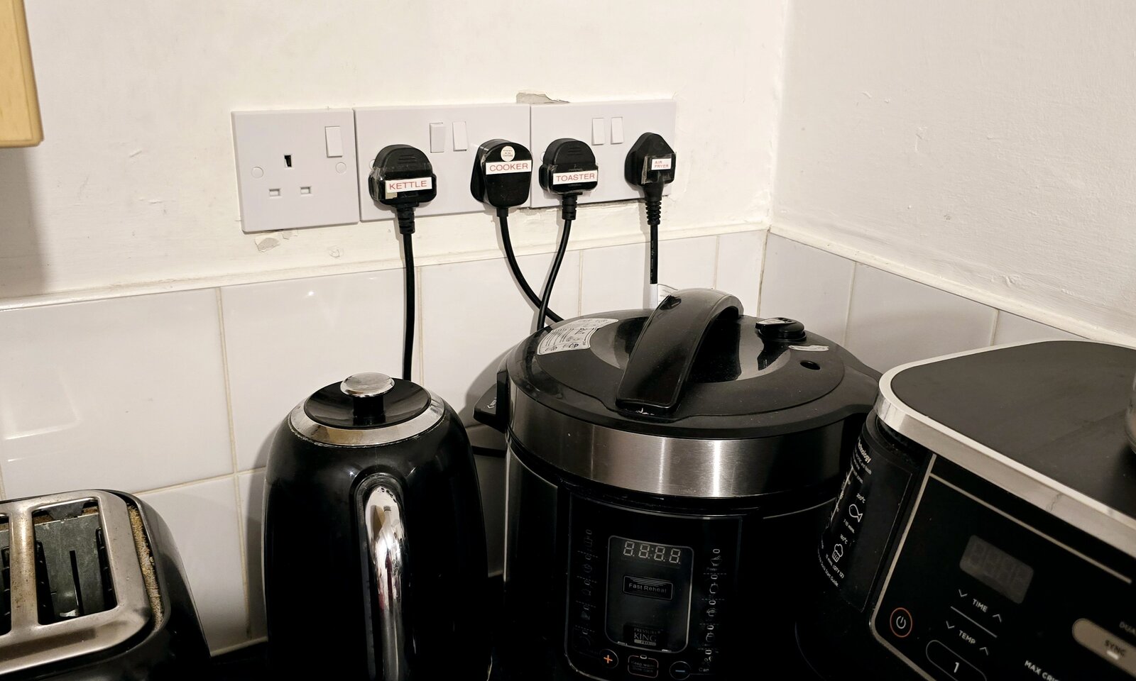

Quick update. I bought the Niglon 2+2+1 and a whole load of 2+2's (minimum order of 5 at 27p each).
I installed the it, and glad i went for the 5gang and not 2 x 2 gangs and a 1 gang.
It all lines up perfectly.

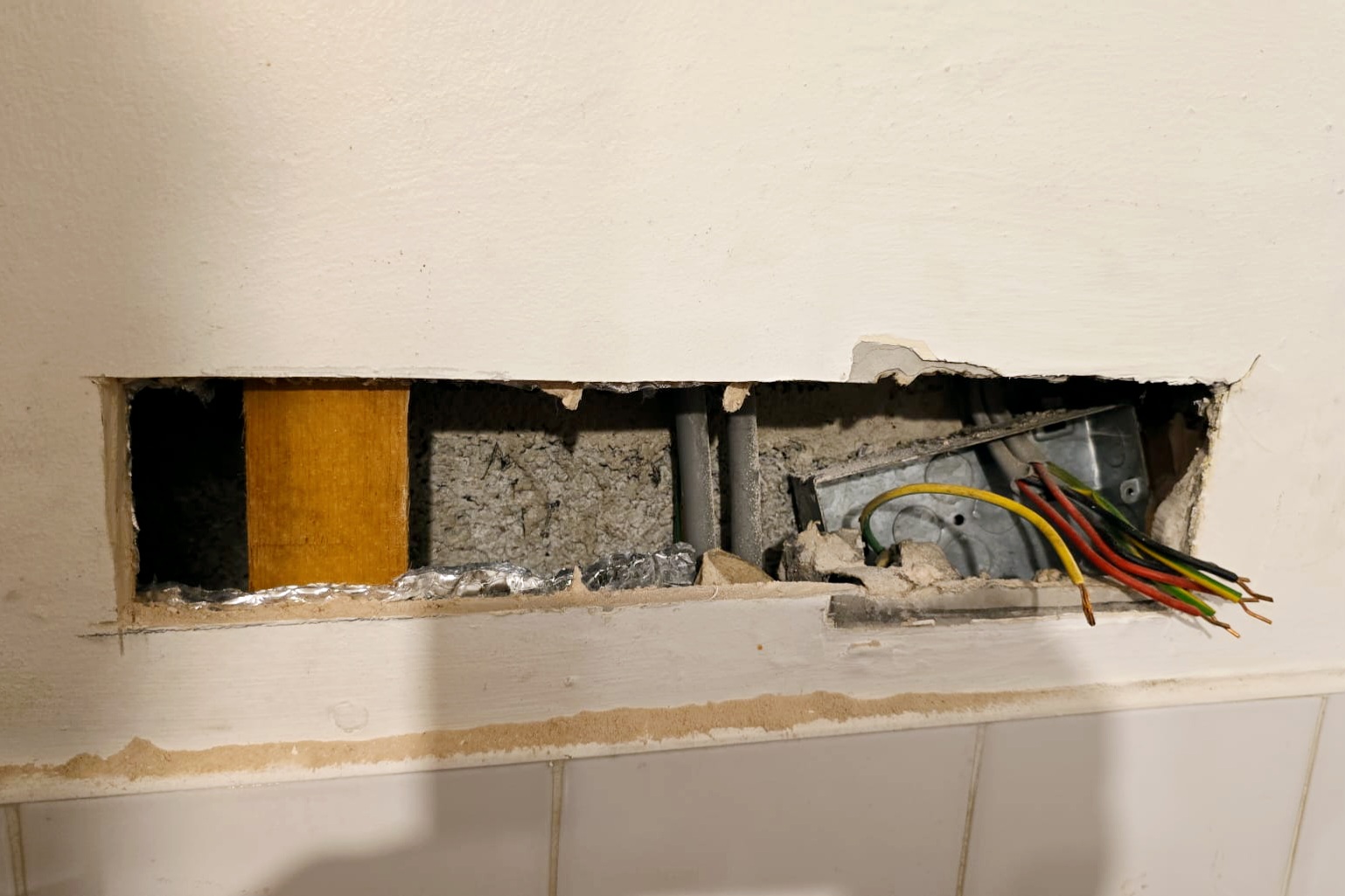

Whilst cutting the recess, luckily I noticed the 2 tail cables which where set back. I put a batton over them which I notched, which also gives it protection.
It was odd that the cable detector didnt pick them up as electric cables, it did pick them up as a magnetic field in the beam finder.
the additional complication was a 2x2 vertical wood beam half way along the recess which I notched to fix the back box to.

Looks good with all the sockets neatly aligned. But it triggers another question, why do most (all?) kitchen appliances, toasters, kettles etc have black plugs and black cable??? White would be less intrusive visually.
Well a contrast as such might be in a kitchen could be an advantage by giving clarity of positions and dangers too reduces inadvertent tugs, physical collisions and burns in flexes etc
Horses Courses ?
Thanks.
I have seen some with white, usually, budget brands. I do hate the discolouring.
My black cables will soon pop out more when I finish the sockets and paint everything white.
I like white walls

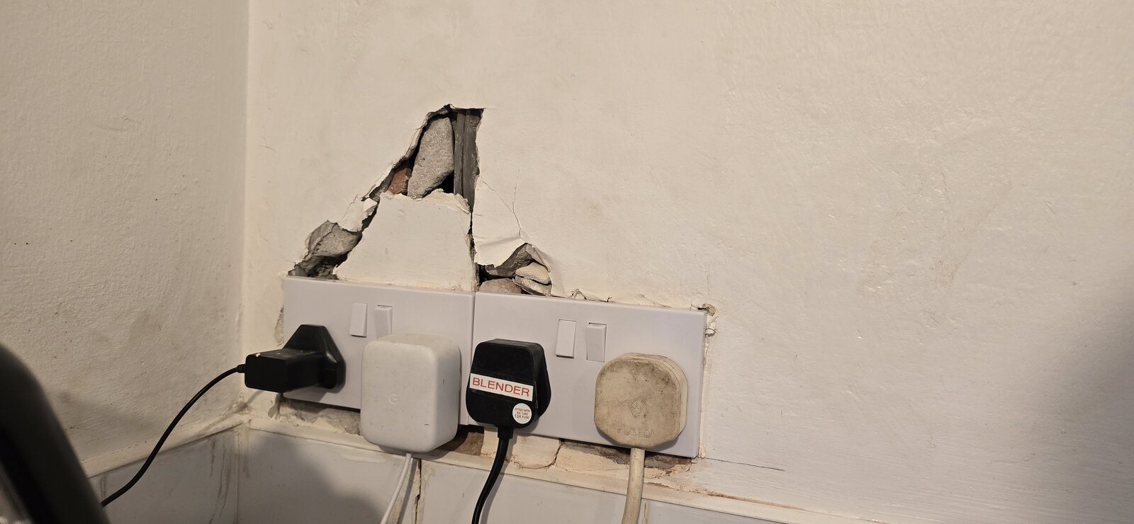

On a slightly different note - the opposite wall only had a 2 gang.
There is a fridge connected to it. The original socket for the fridge is under counter, and onnan outside wall that i think has some damp type issue which made it pop some time back.
I also have some smaller devices plugged in. I knew this maybe a more challenging change, it was in brick with some thick crumbly facing. I couldn't get the Nigol 2x2 in as it was too deep and I got bored of trying to knock a deep Crevice. Suffice to say the crazy thin old plaster and 2bcables started crumbling the wall away. Now I need to device on reskim or foam and polyfill.
Given the presence of the consumer unit immediately above, I would also be very careful when chipping out for the new socket. There may well be cables in the wall.
Thanks for this, made me so much more cautious, which paid off.
