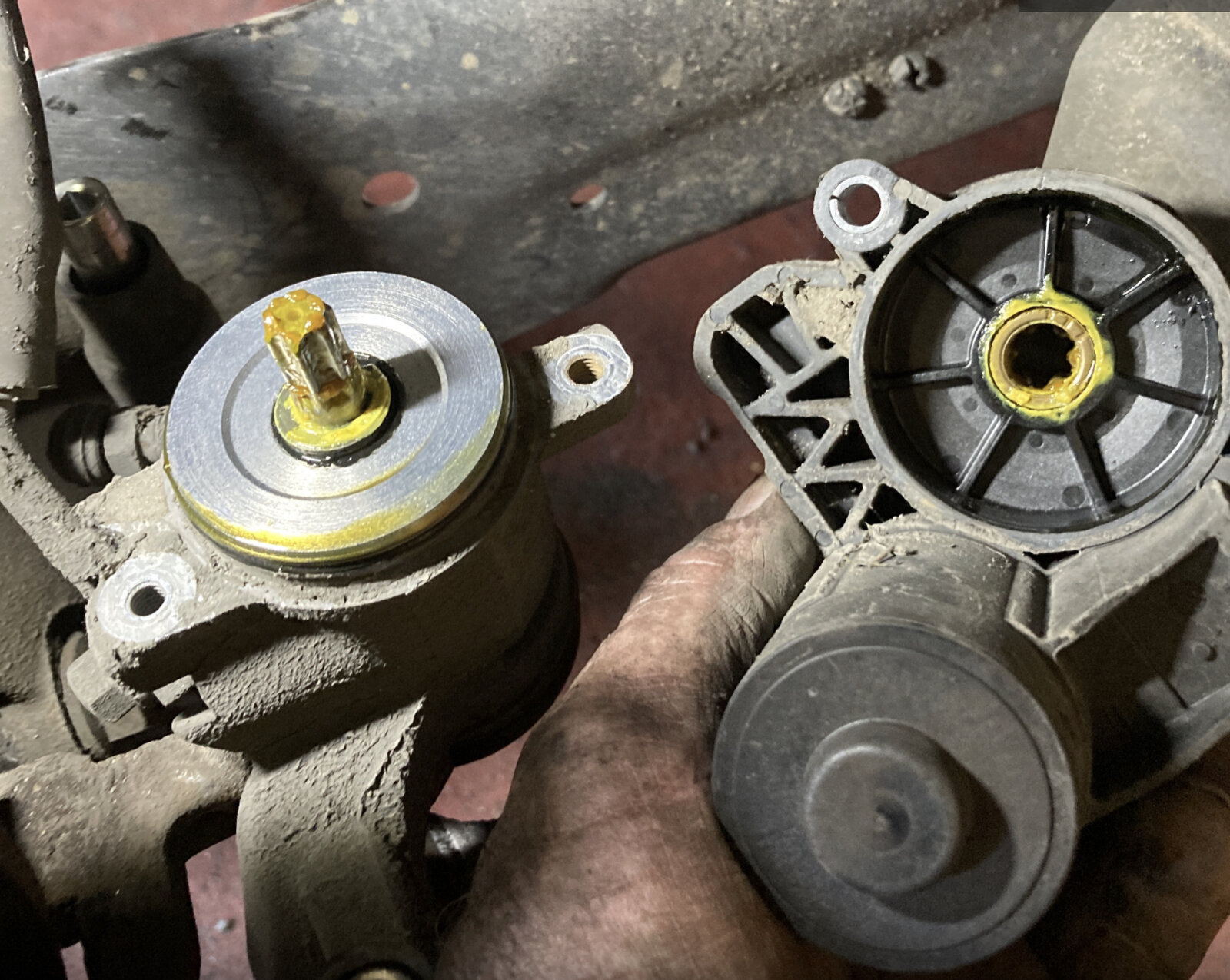

I'm interested in this, as we've just got our first car with an EPB and although it doesn't need doing at present, I Will have to, one day. If you take them off, to allow the pistons to come back, doesn't that mean the new pads are too thick to put them back on afterwards?
You disconnect the motor from the calliper, just two bolts. You can then, with the aid of a socket, wind the mechanism back, away from the rear of the calliper piston. Once this is done you can then push the piston back like any other calliper piston. You need to do this because the new pads will be thicker than the old ones. Here's a picture of my calliper and piston which should show what I mean.
