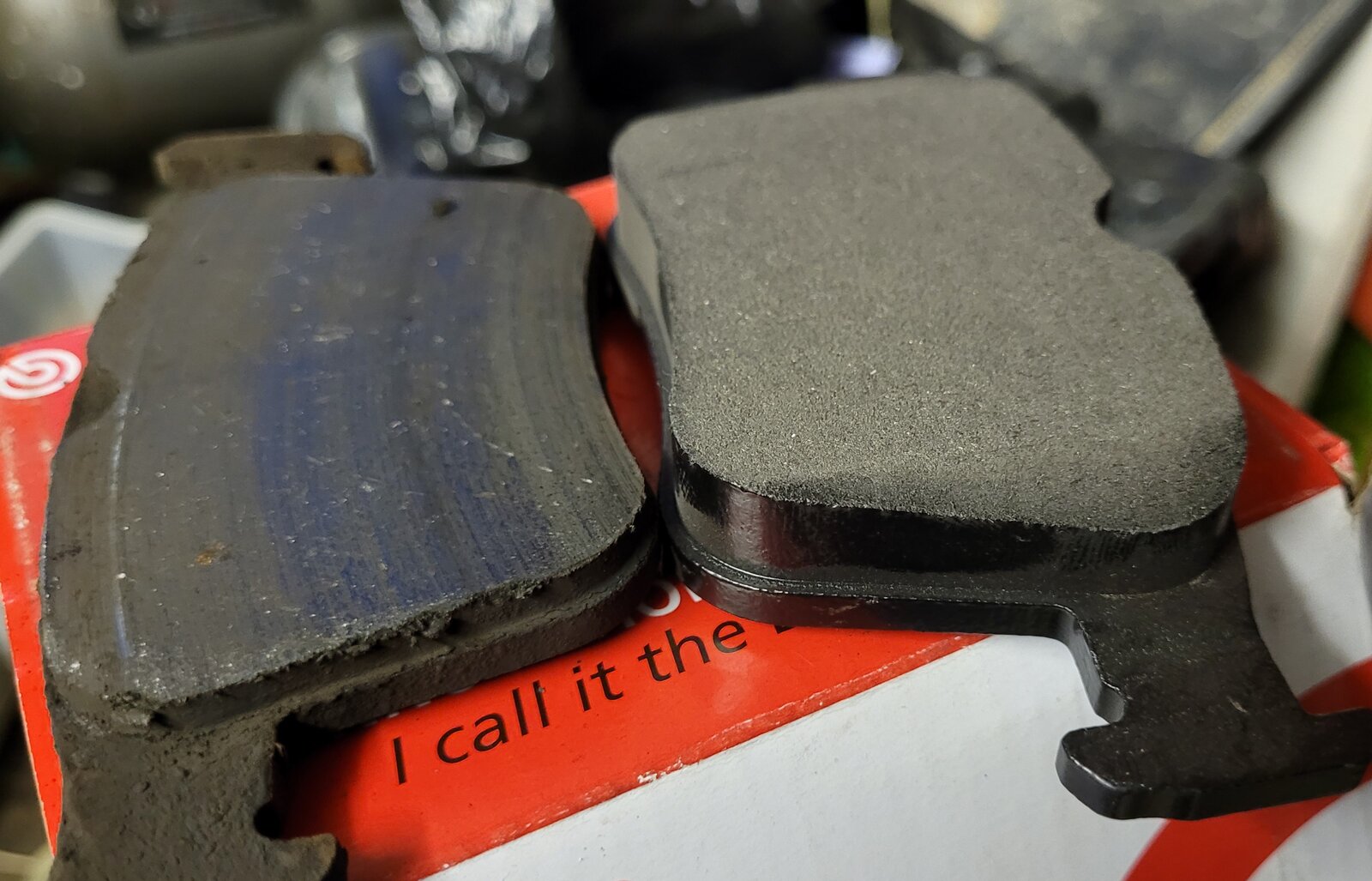

The pads were well worn…. Here is old alongside new
