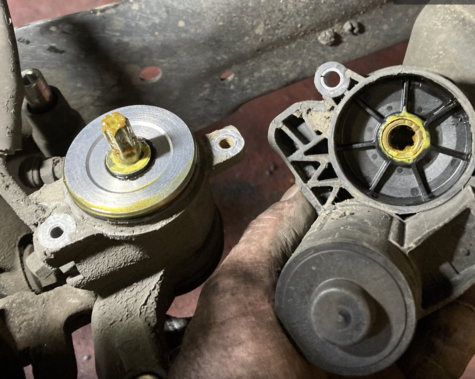

You disconnect the motor from the calliper, just two bolts. You can then, with the aid of a socket, wind the mechanism back, away from the rear of the calliper piston. Once this is done you can then push the piston back like any other calliper piston. You need to do this because the new pads will be thicker than the old ones. Here's a picture of my calliper and piston which should show what I mean.
Excellent! Thanks! Presumably, when you put it all back together, the car just adjusts automatically to the new pd thickness and takes up whatever slack it needs to? (I think they just tend to run the motors unti lthey stall, but I'm not sure. Sometimes on the company car, I manually apply the EPB and can year the motors running for a second or so, but when I turn the ignition on, they run again, very briefly. I therefore wonder if they only artially apply themselves most of the time the car is on reasonably level ground, and then just run until they stall when you turn the ignition off, or pull and hold the switch?
I'm sure that Mottie knows this, but for other people's benefit you need to be really careful that you put the car in a mode that it won't automatically apply the EPB part way through the job. If it does apply the epb whilst you've got the caliper off, it'll push the piston out of the caliper.
I don't understand that. If the motor has been removed, how can it push the piston out?

You are correct, if the motor is removed it can't push the piston out.
The point i was making was that if you remove the caliper in order to remove the motor or to change the pads, you need to be aware that the car can apply the EPB for a multitude of reasons, and if it does apply the epb whilst the caliper is removed without a blocking tool of some sort in place, it will push the piston out of the caliper.
Perhaps a simple expedient approach would beto unplug the electrical wire that feeds the motor at the start of the job .... then it can't operate
OK thanks, but wouldn't you remove the motor before removing the caliper?
