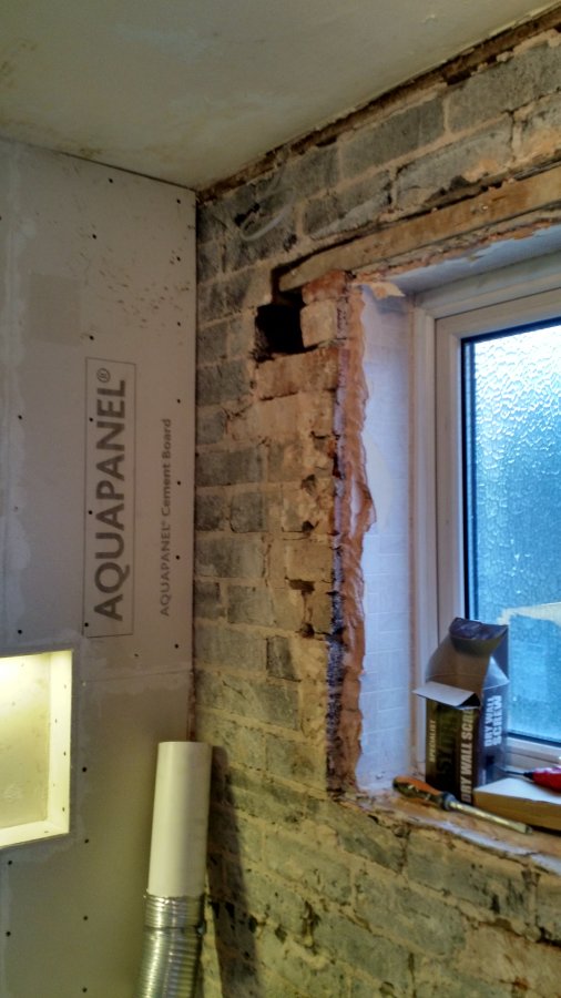

cheapest and or quickest way to cut this brick without disturbing it
21 Feb 2014
267
12
Lancashire

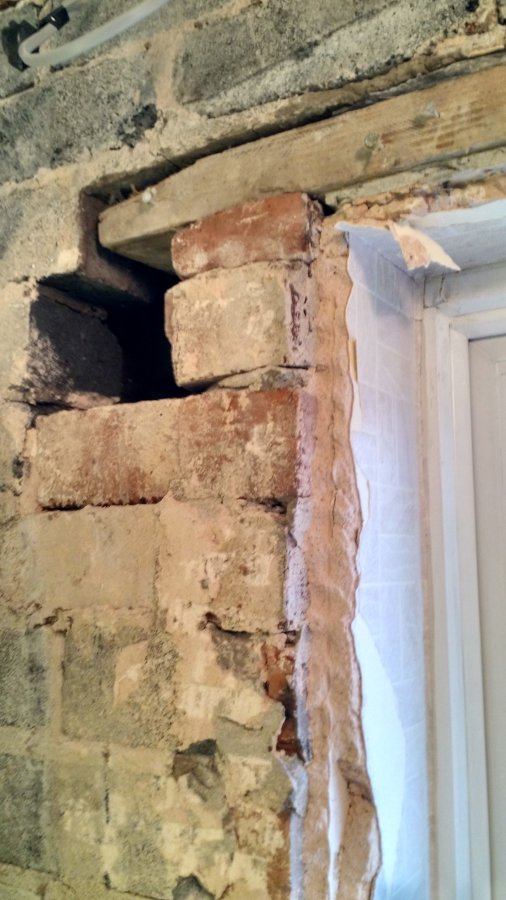

I need to cut the brick under the bottom of this hole. so as to bring the hole down one brick. this will allow me to run my ventilation straight outside.
The idea is to cut the brick fit the plastic pipe and then pack the whole with deep cement to strengthen it all back up.
obviously i cant remove it to try to cut it without bracing and all sort of other things.
Internally on soft brick, I use a reciprocating saw and a few few deep toothed wood blades or hardened steel blade. There are tungsten grit and toothed blades available though.
But a sharp tap as vertical as possible with a bolster or cold chisel will tend to crack that brick in half.
If you stitch drill it first its more likely to split were you want it to split.
I thought about the reciprocating saw but its a tool i dont have and probably not a good idea to buy another tool just yet as i seem to have an addiction at the moment.
Stitch drilling sounds like the winner if i have enough room i hadnt thought of it. thanks

If the brick does start moving when you attack it, just prop that end of the lintel with a bit of 4 x 2 in the window return, do your extract duct & put the brickwork back in packed with slate. Well worth stitch drilling first, may be worth (if you have a small grinder with a diamond disc) scoring the inside & outside where you want to get rid of it.
Given that your window reveal will need remedial work anyway, just prop the lintel and remove the brick. Cut it and replace.
you know i might do that probably a lot quicker and a lot less mess.
ill see if i can prop it properly
