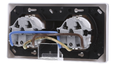

A hole may be preferable for a single outlet, however most people i imagine want doubles, so would be a massive round hole.
I would quess the sguare box evolved due to its ease of building into brickwork

Thanks for the reply guys. What about two single holes next to each other, like binoculars. I remember we had three, with different plug designs (painted over).
I think they used to all be single in the old days, it was quaint and looked odd, old fashioned, but beautiful.
