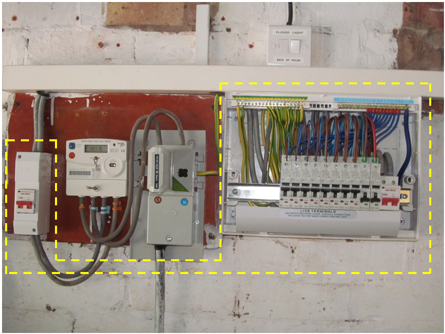

Within the dotted line is quite clearly, and in perfect accordance with every sane and sensible definitions of the terms without explicit over-rides in the regulations, "an assembly of main and auxiliary switching equipment"

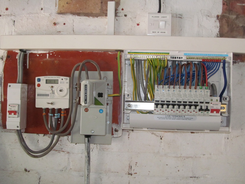

The photo I posted? If so, then Yes, of course, but it was just an example of something I regarded as 'switchgear'. The point of this thread is that, as far as I am aware, the Wylex REC2S (as very widely installed in domestic installations, and still being promoted for that use by {WylEX and} TLC) is plastic.

The photo above shows an assembly of main and auxiliary switching equipment, said assembly consisting of an isolator and a CU, assembled together for the operation, regulation, protection or other control of an electrical installation.

Amongst the items here is an assembly of main and auxiliary switching equipment for operation, regulation, protection or other control of an electrical installation.
Unless the isolator plays no part in the operation, regulation, protection or other control of the electrical installation, it is part of the assembly of main and auxiliary switching equipment which does.
