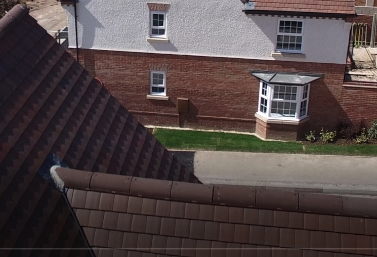

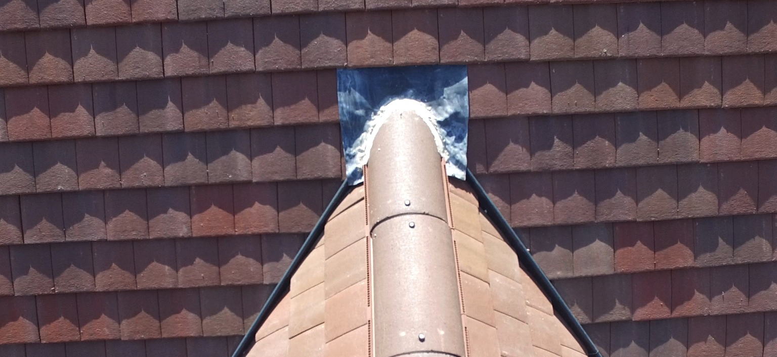

Comments please on the roof top workmanship
15 Apr 2020
7
I'm no expert of roofing, far from it infact, so can somebody please advise if this is correct as looks so amateurish! Thanks in advance :)
I’m not one to slate others work and I’m not a roofer, but it doesn’t look the best.
page 35
  • Guide-to-Rolled-Lead.pdf
  • Thanks
Reactions: CBW
Lead apron should be underneath the tiles.
It needs weathering over two courses of tiles. If he went under then protection would stop at the first batten he hits.
The job is not the prettiest but its essential.
He could of simply used a roof sealant to finish off around the dry ridge tile , maybe perhaps patterned out the lead a bit more but everything else looks ok. Just a very scruffy finish.
It's not the easiest to deal with due to the fragile cuts and the way the cuts sit at the top of the GRP valleys. What he has done is correct in terms of weathering. There is no easy way of saddling the valley junction whilst dressing neatly over fragile tiles. We always dress our lead away from the junction on a dedicated mock-up so that we damage sacrificial tiles rather than the real thing.
The lead saddle should go over the ridge tile as shown on the guide to rolled lead detail .
under ridge and under tiles draining onto the grp. It is trickier using the dry valley but not impossible. I think klober recommend using wakaflex
