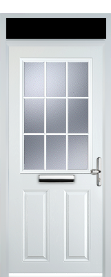

As you can see it's a state! We're just buying the property. Handle's missing and it's so badly warped it has to be kicked shut. I think it would be quite a big job to build the panels and custom fit a wooden door and we'd still have future maintenance.
