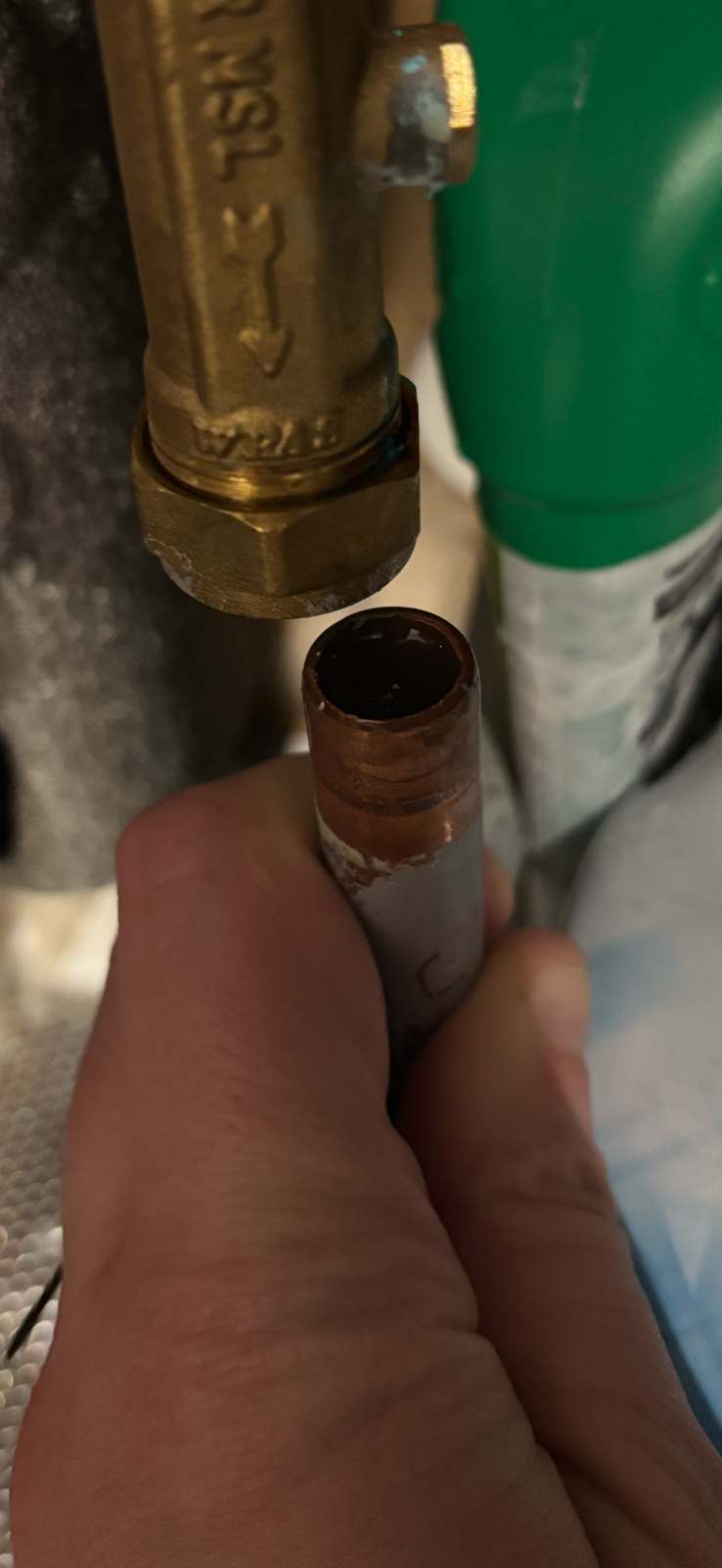

Hi all!

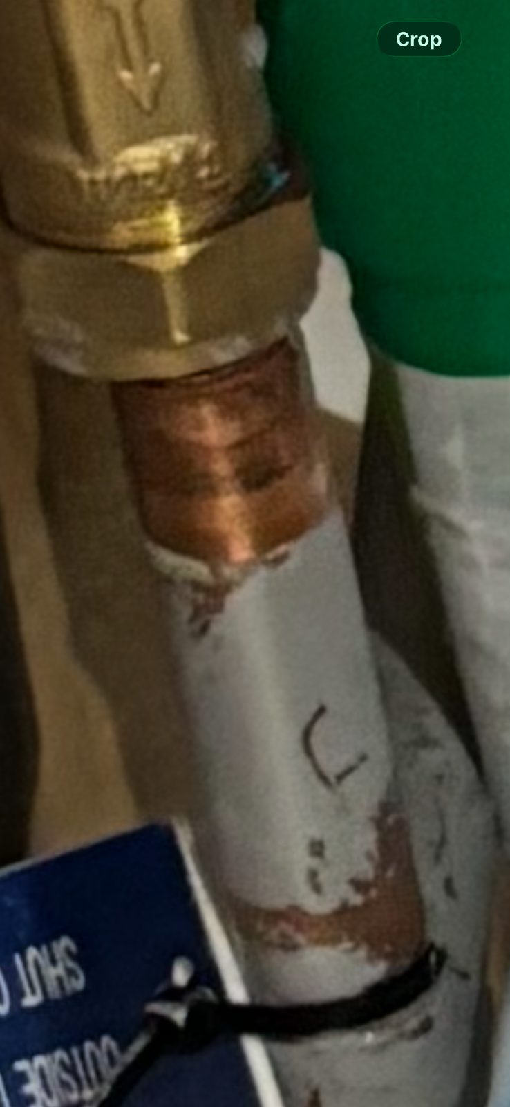

We recently purchased a new build and in the two weeks we’ve been in and not drained down the external tap (yes, bad us) - a pipe has popped out and caused a small flood. Before I put it down to us not doing the draining - I am looking for some advice on this fitting… to me it looks like the olive hasn’t clamped down enough to seal and so even though the freezing weather was the trigger, an incorrectly fitted pipe may be the cause? It looks more like discolouration than a clamping. My limited understanding would say that a correctly fitted pipe wouldn’t have ‘popped’ out like that due to freezing weather and the pipe would have burst or cracked somewhere instead?
Any help would be greatly appreciated to help me with conversations with the builders.

Weather hasn’t helped but has in another way, as it definitely looks like it wasn’t tight to begin with.
Thanks both. Guess this is more of a question of liability with the builder/plumber - they want to push it to be my fault for not draining down (which is 100% the trigger) but my argument will be that the part that failed wasn’t installed correctly as wasn’t tight enough, so was going to come loose at some point… the weather was just the trigger.

Thanks Terry, do you think the fitting was correctly installed based on pictures?
Completely agree about the pressure etc, no dispute on the trigger. Just whether the fitting was sealed well enough.
On any compression fitting on a copper pipe ,including one that is " correctly fitted",the olive can be pulled off the pipe with an olive puller ,and can usually be removed by tapping the nut against the olive with a spanner , leaving the pipe itself with no visible damage ,and able to be re used.

As suggested, the forces applied on fittings when ice expands is very significant, it can split copper, crack cast iron, split rock etc. Also as suggested, a compression fitting that has been fitted correctly can hold fine under the pressure of the mains water but the olive can still be twisted off the copper pipe using grips, so expanding ice would have no problem squeezing the pipe out.
If the tap has been fine till now (no leaks) then unfortunately there's no issue around its install but if it didn't have the ability to be isolated and drained down (nor fitted with a double check valve) then that would be a different issue.
As mentioned though, it's never good when something like that happens and there is damage but I wouldn't look to a bad install as the reason, given the info.
Thanks both - appreciate the feedback. My limited knowledge suggested that there should be indentations on the pipe, of which there isn't. Not from over-tightening, but by correctly installing with a slight decompression to leave witness marks and create the seal.
There was a slight leak when we first moved in but it hadn't leaked since, or the external tap used in that time. Fitted with a non-return valve and able to be isolated.
If there were indentations (necking/throating) then the fitting has been overtightened and that would be a poor install. The only parts in a compression fittings that should deform are the contact surfaces on the olive.
