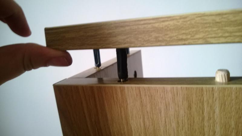

Concealed cistern unit has no access panel
Victoria Plumb are useless. I've had two issues with them and neither they have been able to help me on. Cheap prices = cheap made products and cheap service.
Anyway... ignore the scruffy battens I used but here is what I did in the end and it works perfectly. Brackets used were from screwfix, really cheap and perfect for the job. Panel is held nice and tight. Plenty of space left for the cistern even with the batterns.
Thanks everyone for your help. Its really appreciated.

I'm just having exactly the same problems with this same unit. At first I had figured I would fit the cistern to the wall and then just "place" the unit over the top but the part of the cabinet to hang the cistern on is at the same height as the noggin in my wall :(. But I've already tiled and don't fancy hanging the cistern off just plasterboard & tile. I also stupidly purchased the top suggested cistern on the website with the side entry like the OP. They do a bottom inlet which would be much more suitable for this unit but they never bothered checking or mentioning that what they were sending me won't actually fit :mad:. Don't suppose anyone has any experience with the this basin unit from the range? The unit comes complete with a top on it and the basin separate (obviously). But there are no fixing points whatsoever on the basin, I was expecting wall-mount style ones or brackets of some sort but there's nothing. Nor any instructions, I guess sinks are fairly self explanatory but with no fixings I'm a but stumped, can't just plonk it on top and hope a bit of silicone holds it. Not fitted vanity style units before so no idea whether to remove the top or cut it like a kitchen counter? Contacted customer support and they said the unit isn't even supplied with a top on it so they obviously have no idea about their own products. When I asked whether to remove it or cut it they said they guess I could do either. Sigh. Thanks to the OP for posting some solutions, may go down that bracket route too. If anyone has any suggestions on the basin that would be much appreciated!
