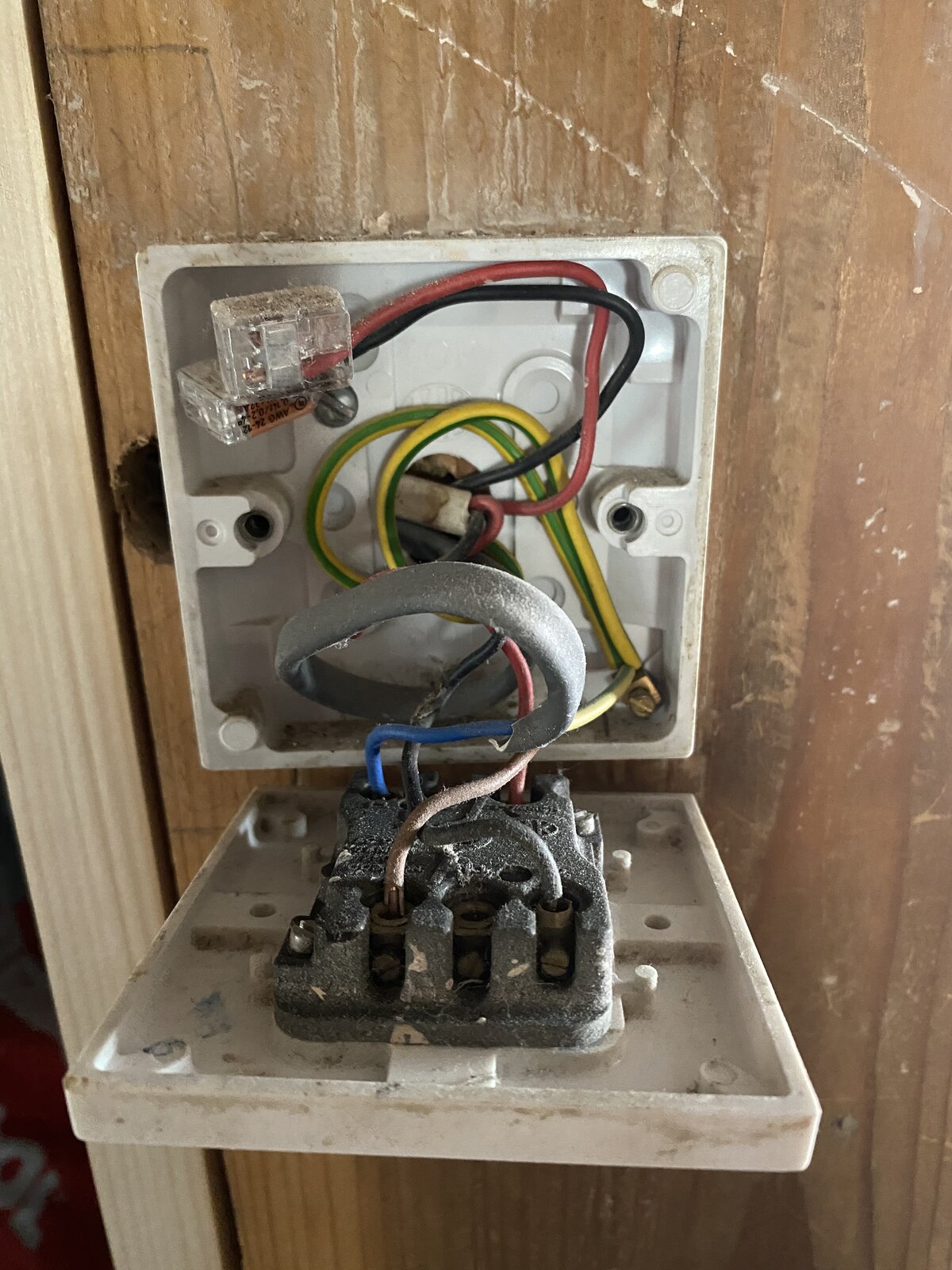

Had a kitchen refit recently and an electrician ran some new wiring around the room for multiple wall lights. I now can’t get the lights working. Apologies if this is really obvious but it’s just not making sense to me at the moment, looked at various wiring diagram’s on here to see if anything helps but I’m still stuck!
The old black and red wiring on the right hand switch is working fine and operates a couple of lights in a downstairs shower room. The new wiring on the left seems to be completely dead, no power running through the cables as far as I can tell. The black and red wires at the top going in to the Wagos are live and I assume these were old wires that were going to a ceiling light in the kitchen that has been removed in the refit.
So how do I get this working? Thanks

There is a very slim possibility that putting the blue into the Wago with the black and putting the top red into the switch instead of the blue may possibly work if the electrician prepared for it.
Otherwise you may have to access the area where the old light used to be.
This is verging on guesswork though.

Thanks Sunray
If that’s not how the electrician prepared it what’s the worst that’s likely to happen from giving it a try?
After reading it again I would do what sunray suggested, turn the power off first obviously.
But also as he said its a guess
The Way that's been terminated looks a little poor, the Brown has too much copper on show, is that black terminated into the switch got damaged insulation?
I don't know why the grey outer sheath hasn't been stripped back more so there's more room in the back box.

Why didn't the spark leave everything working?
I was left with cable sticking out the walls where lights were intended to go. The plan being I’d connect up the lights once we’d settled on what we wanted.
Why it wasn’t connected up at the switch I don’t know. I can only assume so as not to leave live wires sticking out the wall??
