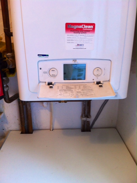

My heating doesn't come on some evenings and when I check the boiler I see it has a pressure of maybe 0.5 or less. I therefore increase pressure by opening the left-hand one of two taps below it and increase pressure to about 1 or 1.2. This seems to work. The next day it's about 0.5 again, however.

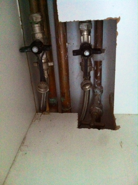

I take it the two taps I'm talking about are the boiler "loop". For as long as I remember the tap on the right has always been open and the left one (which I turn to add pressure) closed. I have just left it like that. Should they both normally be closed, then opened to add pressure, then closed. If the right-hand one is always open, is this what causes the pressure loss?
Another odd thing that happened one with the boiler recently was that pressure went up very high by itself (to about 2.8 or 3) and then water emitted through the overflow pipe. After that it still operated OK however, (or at least as above).
I still have heat and hot-water (with some re-pressurising, as above), so don't really want a call-out for no reason, unless it sounds like something will soon go badly wrong (it has been like this for weeks however). I'll wait till annual service.
I would be extremely doubtful that pressure-drop was due to a fault in pipe-work, as this was largely re-routed (avoiding under-floors) only a few years ago, after previous pressure problems caused by that. Any leakage would show somewhere.
Boiler is British Gas 330+

Expansion vessel probably failed or empty. Fixing it here if it just needs to be repressured: https://www.diynot.com/diy/threads/faqs.37170/#post-251090
Get someone to replace if not.
Both of the valves on the filling loop should be closed unless actually using it to fill. Leaving one open would cause a flood if the hose was to burst.
If you continue to top up the boiler with fresh water, internal corrosion will occur. This will cause damage and eventually destroy the system.

I think you're supposed to close both valves to avoid the possibility of central heating water getting back into your cold water supply, or something like that. Someone else may be able to explain it. Many systems have only one valve. It is not going to be the cause of your loss of pressure, unless something very peculiar is happening.

It's probably your expansion vessel. You should get it fixed sooner rather than later. You should also add some inhibitor to thr system as you will jave been diluting it while topping up.
Call a recommended gas engineer in to service the boiler and system, point out the issues you've been having, how long you've been filling it etc, so they can target their work to correct the issues.
It should be pretty straightforward and hopefully covered within the service if the EV is holding pressure and the price of the inhibitor if needed. Doesn't look like you have a check valve on the fill loop either so that might need added too.

I think(?) it's actually got two DCVs Rab?? The loop valves look a bit big for just ISO type valves.
It looks like a Glow Worm FP? It could be the EV blocked flexi pipe, quite common on these sheds.
Yup, think you may be right m8, well spotted (y) Too quick a look before, looking closer I think I can see the check nut at the back of the left valve.
