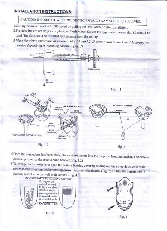

Hello,
bought a ceiling fan (Napoli) with light, trying to connect remote control to it.
The remote instructions say connect as follows:
Blue - to neutral/fan/light
Brown - to fan/live
Red - to light/live
yellow/green - earth
But the fan only has 3 wires:
Brown - live
Blue - neutral
How can this be connected?
Both items bought from Homebase, the fan box says this remote is compatible with fan.
Thank you for any help in advance.
Is there a way to remove the light fitting from the fan and fish its live wire through? Any chance of a photo? There is normally two lives present at the ceiling.
1st pic shows the 4 wires from remote that need to go to the fan: brown, red, blue, green/yellow
2nd pic shows the 3 wires from the fan: brown, blue, green/yellow
A strange one. What do the fan instructions say? Anything about using the remote module?
I gather the fan comes as standard with a "socket" to wire to the mains, that plugs into the fan's connector?
The fan instructions don't say anything about the remote, connecting to the mains is straight forward one-to-one.
The fan box says this remote is compatible.
have sent an email to Homebase, but could be weeks before anyone answers (if at all), you know what these big company's aftercare is like (non-existent).
The remote instructions assume there are two live wires (one for fan and one for light), but there's only one.

It surely can't be beyond the wit of someone to adapt this fan/light (although it would quite probalby invalidate any guarantee) to make it work.
Presumably the switched live will be split via a connection block within the fan housing - one for the light and the other for the fan. So by leaving the light to be operated by the wall switch, and taking the feed wire into the remote and from there up to the permanent live, it would work.
And now I'm outta here before having the usual (predictable mandatory) strip torn off me :roll:
Compatibility: Can be operated with remote control (807870), sold separately.
But this is clearly untrue, because the fan and light supply conductors are not presented separately.

Your description does not list enough wires - there should be a feed (3)in to the remote unit and a feed out from it (3-4), I think mine is similar and IIRC it has 6 or 7 connections.
Also no plugs on mine, just lots of choc blocs.
Mime came from B&Q and the remote came with the fan.
