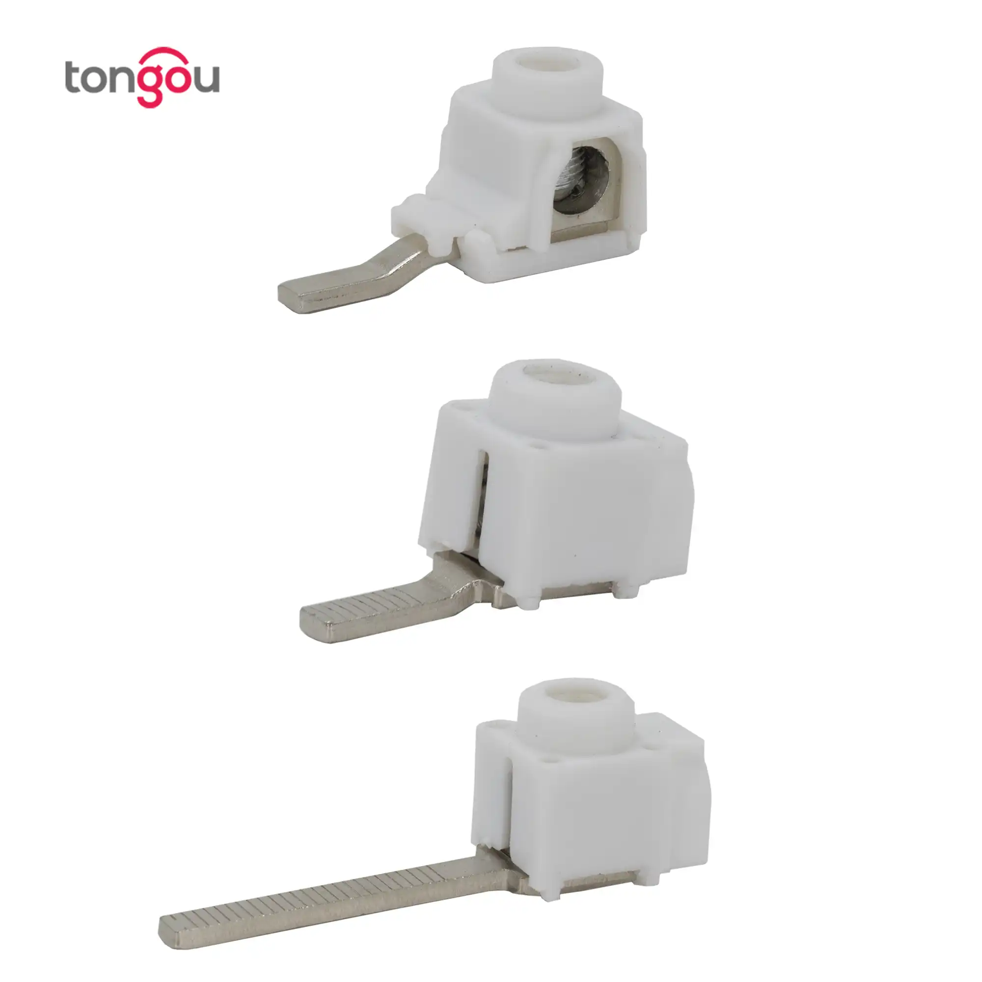

I assume you're talking about this sort of thing?
25-mm-Terminals-for-Busbar-Circuit-Breaker-Distribution-Box-Electrical-Wire-Connector-TONGOU.jpg_q50.jpg
Available from most manufacturers from all wholesalers.
To get 100A rating use two of the side entry style in adjacent MCB's and pass your 25mm² into both
Yeah - thought about thems. I'd certainly feel more comfortable putting one into the bottom of a device along with the bus-bar prong than a cable, even a crimped tri-rated. But incompatible with my busbar - I'd have to bend the prong 90° and then it would obscure the bottom terminal screw in the device.
