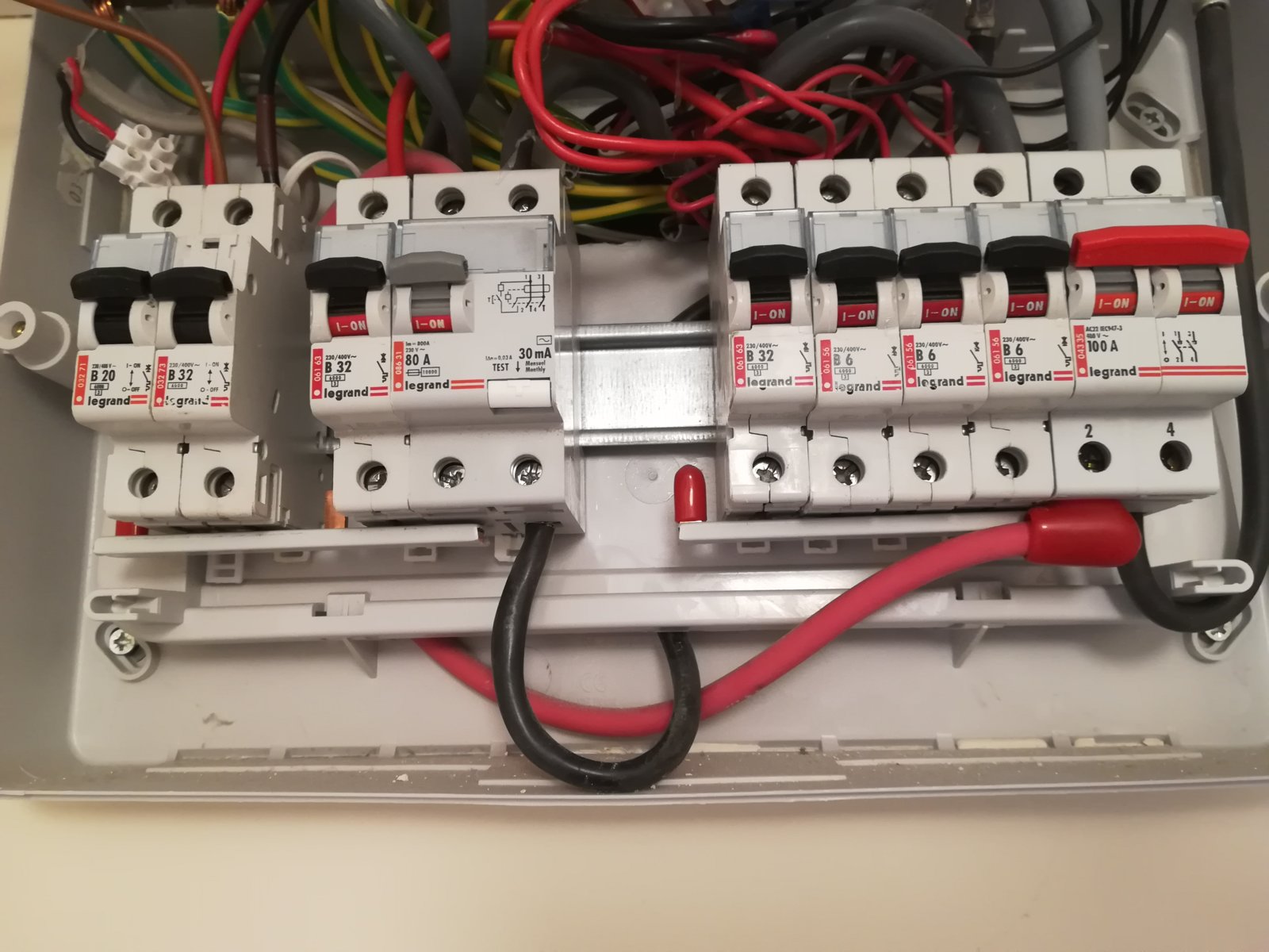

i have a split load cu installed with single rcd, at the moment the circuits are laid out as follows.
Rcd protected: 1x sockets, 1x induction hob, 1x oven, 1x boiler, 1x fridge freezer.
Not Rcd protected: 2 x lighting, 1 smoke alarm.
It is my thoughts to put the fridge freezer on the non rcd side as we had a nuisance trip whilst on holiday recently, and lost the entire contents.
Any tips on what you would do circuit wise?
It’s a typical new build with 1 ring main covering 3 floors, which is poor in my opinion but it’s got to stay that way sadly.
What you suggest with the freezer socket may be ok in principle, but could be a problem if the cable is buried in a wall at less than 50mm deep.
In my opinion, the best way is to fit an RCBO on the unprotected side of the cu to serve the freezer.
It’s an added high level socket for the fridge freezer but yes there is roughly 300 mm of cable behind the dabbed plasterboard.
A new-build should not have a single RCD in the CU, to have that, it would need to be at least a decade old, installed under the 16th Ed. Regs.
If the RCD trips it is either due to a fault or poor design (such as too much equipment on a single RCD).
Given you were on holiday at the time a fault is more likely as little or nothing else would have been in use then.
Could even be the freezer itself.
Moving items to non-RCD circuits is not a solution.
Sling the RCD and existing MCBs away, replace with 7 RCBOs.
7 because the smoke alarms can go with one of the lighting circuits, so that in the event of power failure to that circuit, people will notice immediately.

Good idea, any brands to avoid when choosing a new cu?

While RCBOs for that are theoretically available, installing them in there will be a nightmare.
Replace the entire thing - most of the cost is the RCBOs, the box they fit into is a tiny fraction of the total.
