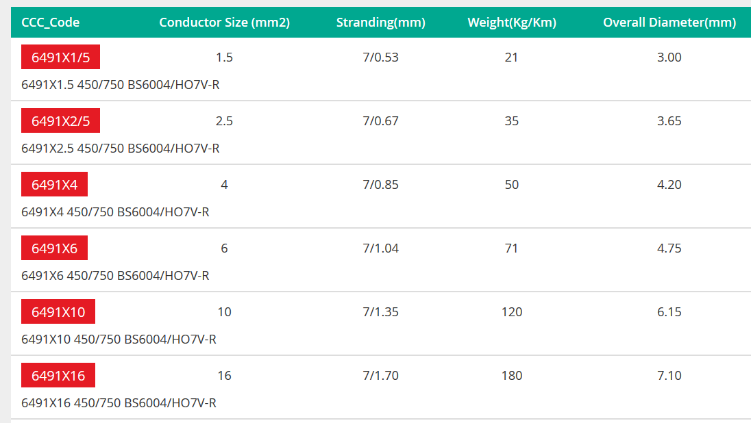

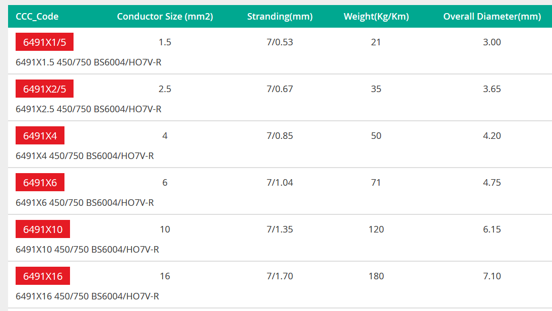

But size is hard to judge from the photo - what's the approximate outside diameter of the cables?
i think they are 4mm singles like the rest of my ring main.

Measuring the outer diameter could mislead you, some imperial cable had thicker insulation, you may well have the imperial equivalent of 2.5
