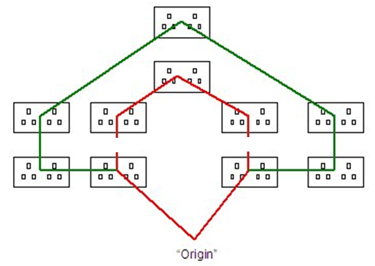

The CPC of the second ring would be "a ring with both ends connected at the origin". The CPC ring will have multiple joints (most or all at sockets etc.), and the fact that the conductors from the first and last joints to the 'origin' are shared with the first ring does not alter the fact that the second circuit's CPC is a "ring with its ends connected at the origin".
Err...
Yes.
Those two red lines look very much like "CPCs arranged in a ring with the ends joint at the origin", don't they?
They do.
Sorry.
Good to see you.

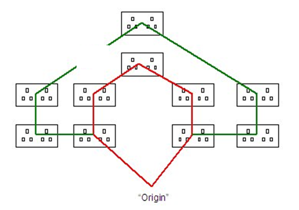

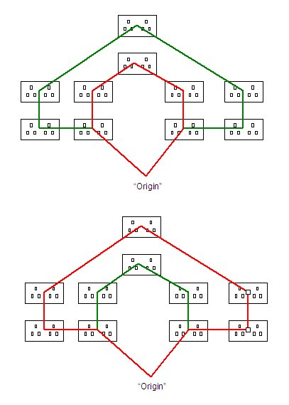

I agree, that end-to end testing would not pick up this:
Or this:

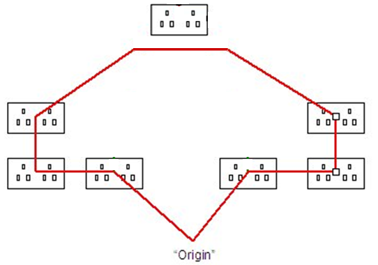

But nor would it pick up this:
In all these cases, the only way to be sure that there is a cpc at every point is to test at every point. There are no shortcuts.
Maybe I should have put blobs on my wires to remind people where the terminals/'joins' are. Little is impossible, but the probability of a pair of CPCs conductors coming out of a socket terminal but remaining connected together is incredibly low. The same very low probability also applies to L & N, so is it being suggested that one should not bother undertaking end-to-end continuity testing of the L & N rings, in favour of just measuring resistances to the 'origin' from each and every socket?
E-E testing is a good initial check.
Is it being suggested that if E-E is OK one should not bother checking each outlet, and just assume that a cpc is present everywhere?
