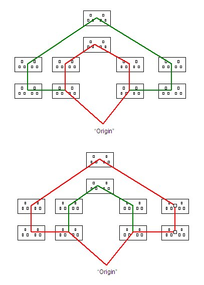

I'm still unsure what an installation would look like if multiple circuits shared a single cpc.
If, as OwainDIYer seemed to be suggesting, there were just two CPCs "large enough for the largest circuit" (and serving all circuits) going to the CU, then showing continuity between those two would not in any way guarantee that the CPCs going around any ring final circuits in the installation were continuous. As I've said, I have no experience of wiring final circuits in singles, but I very much doubt that it is done as suggested.
How are you suggesting it has been done?
I am personally suggesting nothing. This all started with ...
I didn't think you needed multiple cpcs if wiring in singles, just one large enough for the largest circuit carried.
... and, as I've said, although I have no experience of wiring final circuits in singles, I really don't think anyone would do it like that (have just one CPC {or two if there were ring final(s) involved} entering the CU/DB, serving all the final circuits).
I therefore think this is a rather silly discussion, since, as I say, I don't think anyone would do it like that. However, in case they did, "543.2.9" keeps getting mentioned here, and I don't really think that changes anything. That reg merely requires that any ring final has a CPC arranged as a ring with both ends of the ring connected to the origin of the circuit. It says nothing that would preclude other circuits sharing part(s) of that CPC ring - so, if one were daft, one could have, say, two ring finals, one with the two ends of its CPC ring going to the CU/DB and with the CPC of the second one connected to the CPC of the first ring at, say, it's first and last sockets. Both ring finals would then have a CPC which was "arranged in a ring, with both ends connected at the origin of the circuit" - but it would be impossible, from the CU, to test the CPC continuity of either ring with confidence.
However, as I said, I think it would be plain daft to do that, and I doubt that anyone would!
It ought to change your perception of a problem if you read it properly.
Yes, but I'm not sure that "merely" is an appropriate word to use.
No they wouldn't. The cpc of the second circuit would not be a ring with both ends connected at the origin if they are connected at not the origin.
The CPC of the second ring would be "a ring with both ends connected at the origin". The CPC ring will have multiple joints (most or all at sockets etc.), and the fact that the conductors from the first and last joints to the 'origin' are shared with the first ring does not alter the fact that the second circuit's CPC is a "ring with its ends connected at the origin".
Especially as what is being discussed is shared CPCs.
That's the point. Although, as I've said, only a pretty daft person would do it this way, as far as 543.2.9 compliance is concerned ....
Those two red lines look very much like "CPCs arranged in a ring with the ends joint at the origin", don't they?
Kind Regards, John
