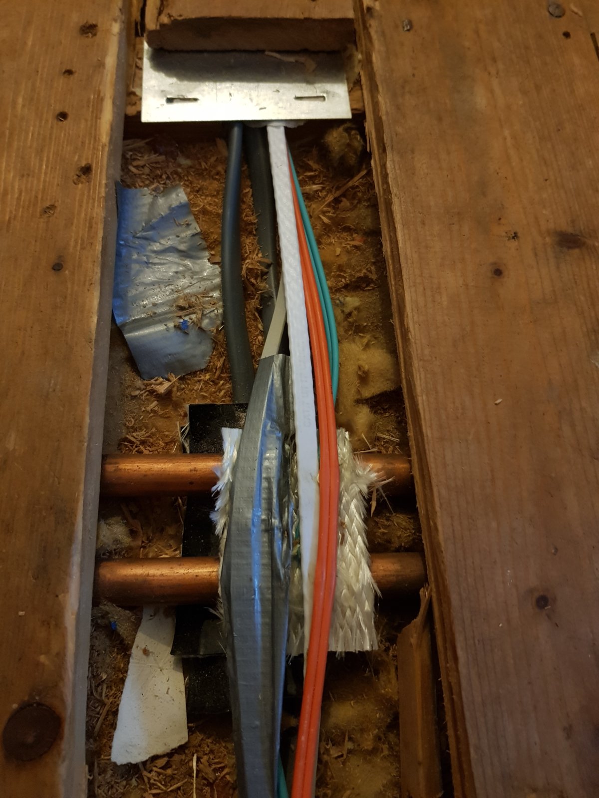

Hi Guys
Sorry I have been out of it for a long while mainly because of not being able to do a lot as my right arm was a bit useless for quite a while and my work was overloaded.
I got another Electrician in to do the rewire for me and I hoped that would be the end of it. The first day he rewired the lighting in the existing conduit which was good as I really didn't fancy having all my walls and ceilings chased. The cable pulled through relatively easy.
Unfortunately it went a bit downhill after that (for many reasons) as he couldn't remove the cables for the ring from their conduit so he decided to lay T&E under the floorboards.
If you look at the following photo and ignore the data cables for the moment even though the melted fiber optic is interesting.
Does the mains cable only need mechanical protection when it goes through the joist ?
My whole floor is concrete and the joists laid down are none structural and just there for the floorboards to rest on. unfortunately they are only about 4 - 5 cm above the concrete so there is not much room to play with and in particular have problems when the central heating pipes meet the electrical conduit.

In the picture, those nail guards don't give anyone a chance to nail the floorboard back down.
Data cables should not be run parallel to mains cables, you need a gap of AT LEAST two inches, if not much more.
Rule of thumb is to run mains cables below pipework, theory being the cable is less likely to touch the pipe. Not always possible within such a shallow void though.
I don't know for certain what the rules are for protecting data cables from nail damage and the like, but I always treat them the same as mains, mainly because I don't want to ever repair them.
Yes i agree with you about the safe plates but they were what he put down.
As far as data cables go for the flat Ethernet cable that is a good idea but for fibre optic I think its OK to run along with the mains cable as it can't interfere with the signal nor can any voltage be carried by it.
The data cables were there first as I had done that myself previously, the Electrician just reused the notches in the joists. I hadn't put down safe plates as I knew the data cables were there and wasn't going to put a nail in it.

But my living room is still done this way as new sockets were put in, so I was just curious if the safe plate over the joist meets regs?
