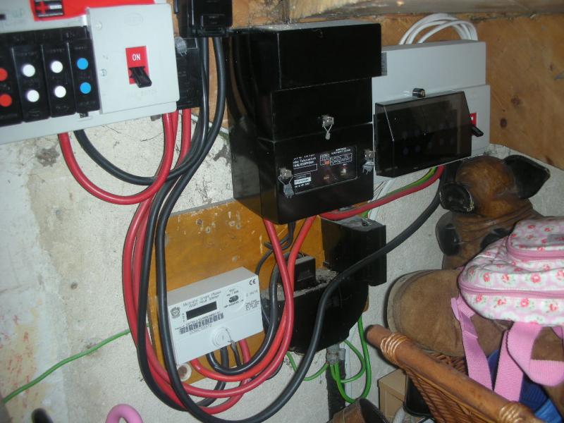

Hi people.
Thanks for the replys. Ive taken a picture of underneath my stairs (and luckly thats where the fuse box is) to ponder. It seems there is a machanic and digital meter both wired in and the CU on the left is what ive been using to isolate circuits but any ideas why i have the one on the right as well? I followed wires and it looks like the supply comes from the street and into the box on the right, goes through the meters and fuse then supplies the box on the left before shooting off around the house. Can I get all these removed and have just the one CU that i mentioned before?
[/img]
The CU to the right is newer than that to the left.
If you isolated the right hand CU and see what no longer works that would be a good indicator of what circuits are installed on it.
Is there a circuit chart with it or markings identifying the circuit under the visor?
The white cable seems to be heading downwards, what type of floors do you have, any below house power required?
The big black box is a radio controlled time switch for controlling the power to Off Peak loads ( storage heaters and water heating )
The white box is the meter and it has two counters, one for day rate and one for the Off peak rate
The consumer unit on the right is only supplied with power when the time switch is in Off Peak mode.
The consumer unit on the left is supplied all the time.
The small wire from time switch to the meter is the control wire to tell the meter whether to count units on the Day rate meter or the Off peak rate meter. (

No below power is required. The house is 1930s build and all the floors are boarded. When i switch the consumer unit off on the left it kills all power to the house. Ive never touch the one on the right. Ive always tested everything ive been working near or on with a multi meter and its always been off. The house did have storage heaters but hasnt anymore. The water heater which we no longer have installed is run from the CU on the left.
what time is off peak?
Ive just thought that if i tested the wire where the storage heater used to be and theres no power and im sure the other night it sparked when i touched the wire. Perhaps this storage heater wiring only comes live at off peak periods. Ill volt test it in off peak tonight.
Well it sounds like when the water heaters were removed that the power supply had not been.
Off peak is generally between 10pm and 8.30am.
