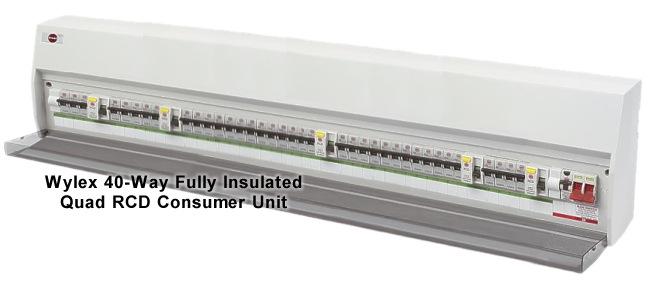

From a domestic property I am currently working in.
DB 2 of 3
:wink:
That must be some domestic install. Why so many circuits ? - if it requires that many for loading in a house then some of those circuits must be a long way from the dis-board. :?:
RF That looks suspiciously like a commercial installation, I have done several larger installations but they were in sub-stations.
Why would I say it was in a domestic if it wasn't?
I've done loads of boards bigger than this on commercial jobs, but this is my record for a domestic.
There are loads of circuits for a few reasons.
Circuit length plays a part but was not the only consideration. 314.1 was one of the reasons, mainly the reduction of inconvenience, and the possibility of an accumulation of conductor currents due to lots of gadgets with filters etc.
Hopefully this should help.
Don't bother mentioning the missing blanks or the 'locking off' :oops:
Wouldn't like to pay for that lot! I've changed a few three phase dbs since the seventeenth came out and the customers jaws have hit the floor.
