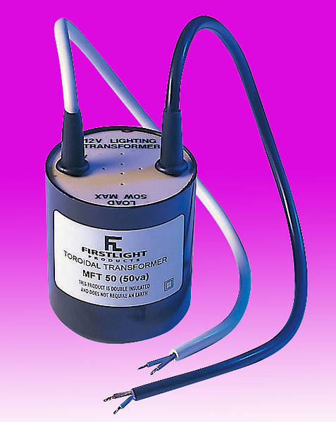

I want to change a couple of light fittings in our hall from Halogen to LED so we can get bright white bulbs to brighten it up a bit rather than the dull yellow halogens. The current light fittings are driven by Kaoyi KTB-60 and the fittings take 6 x 10W G4 halogen bulbs. We don't want to buy new light fittings as we like the ones we have.
I know I'll need to change the transformer and just wanted to validate that if we were to replace the existing transformer with one rated 0W-50W (like this one on Amazon https://www.amazon.co.uk/0W-Dimmable-Electronic-Transformer-voltage/dp/B00IWCG502) then this would still do the job and drive 6 1.5W LEDs?

The power supply you linked to in your first post will be fine with the LEDs you’ve linked to.

The problem is even if this toroidal transformer transformer.jpg is ideal to comply with 50 Hz 12 volt AC supply, it can't be used with a dimmer switch, and at £19 is not cheap rated 50 watt. The 0 - 50W you selected will likely work OK, but the likely is the operative word, the kHz range of output could turn the set up into a mini wireless transmitter if the cables happen to hit the right length for the frequency. Also dimming any electronic lamps can cause problems where the power supply/driver/transformer/ does not match the switch, specially where the switch does not require a neutral, and this includes both 12 volt and 230 volt lamps.
You should not dim quartz lamps so likely no problem using a toroidal transformer this is how I would do it, but I have a 200 watt toroidal transformer spare, so don't need to spend £50 on a new one. I have some G9 bulbs 4 x LED and 1 x quartz, in the same chandelier and lucky you can't tell which is which, and that is likely the easy way to move to LED leave one quartz in the circuit. However you seem to want a very high colour temperature, I have never considered quartz lamps to be yellow, I have always considered them to be if anything too white.

If you have access to fit the larger toroidal transformer I show then I would use one of them, but if the transformer is to fit through the hole where lamp fits, I would take a chance and fit the one you linked to in your first post. There is no right or wrong, just shades of grey.

I would not think the LED lamp works any different be it 50 Hz or 50000 Hz likely the only difference is the stroboscopic effect, which will reduce as frequency increases. The big thing is a toroidal transformer is heavy and big, (63 mm) so having that weight on the ceiling and getting it through the hole that the light fits into could be a problem, so there is a good reason for using a 0 - 50 VA electronic device which is light and will fit through the hole. Yes the light may say 50 Hz but that means you should not use DC as well as not using kHz AC, both could cause problems, and both are in real terms unlikely to cause problems.
So using a DC power supply instead of a kHz power supply is really the pot calling the kettle black, neither is correct, but both will likely work.
