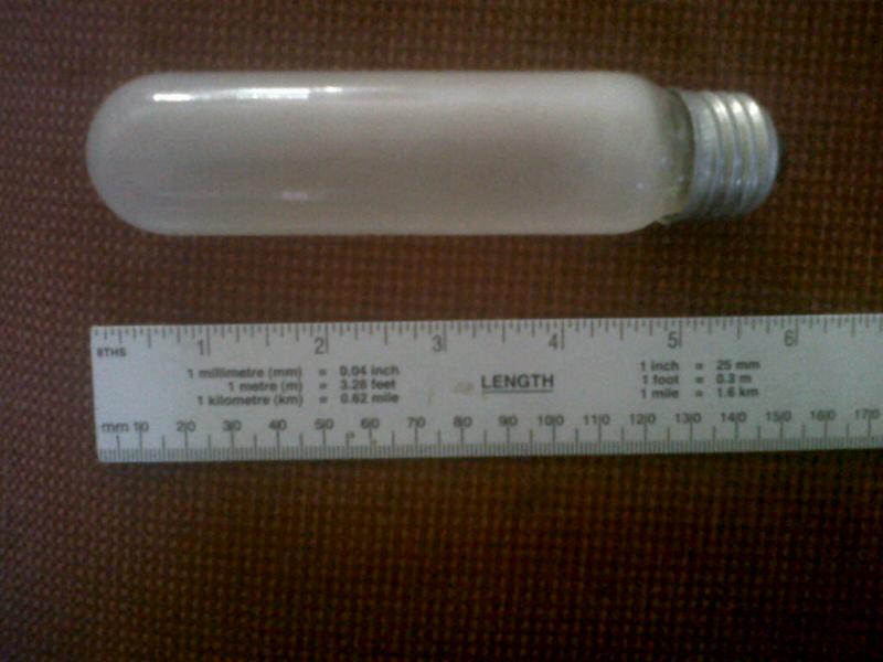

I am converting a US wall light to UK wiring, but as I can't get the correct type of bulb in the UK, I would like to try to add two.

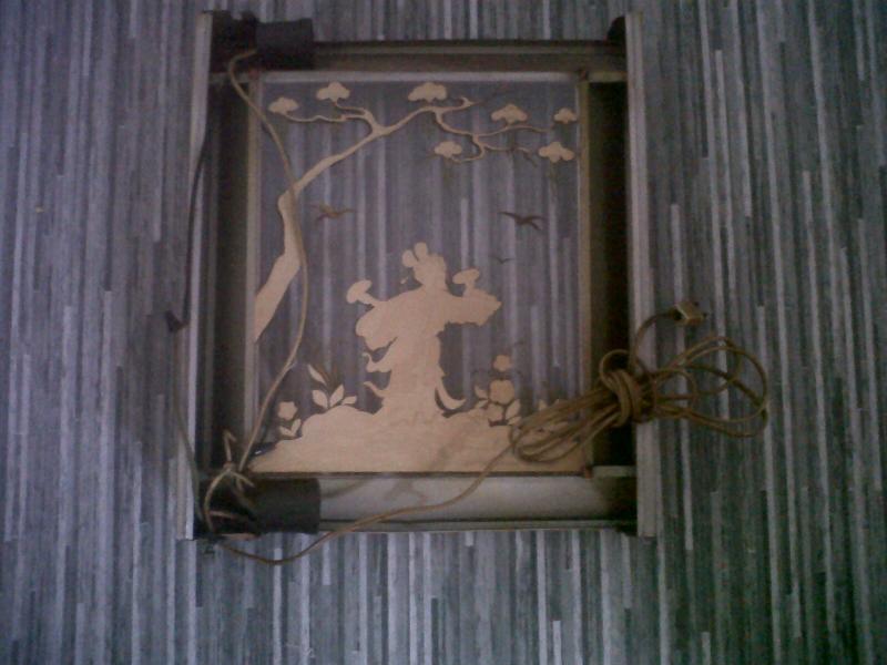

Back of the light in it's current state below:

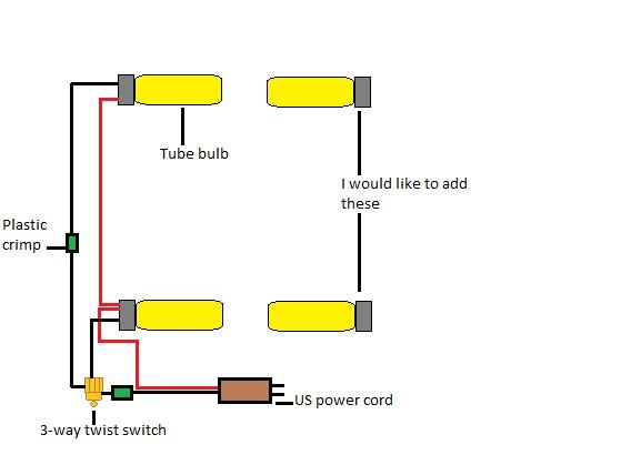

Diagram below is the current wiring (wire colours not necessarily representative):
As I can't seem to get 5"-6" tubular type bulbs, I am going to try and use 4 x smaller candle bulbs instead, probably 25w.
Can someone suggest the best way to wire this so as each pair of of top and bottom bulbs work as they do singularly - the switch is three/four way - twist once and only the top one comes on, twice and only the bottom comes on, three times and they both come on, four times and they both go off.
Also, becuase of the limited space between the light and the wall, what is the small wire gauge I can use (it will be connected to 1.5mm T&E), and what is the best way to connect this to the T&E - terminal block?
But this worries me greatly.
If you can't see that to do that all you would need to do would be to connect the new top lampholder in parallel with the existing top one, and ditto the bottom ones, then I fear you have nowhere near the basic, fundamental, almost instinctive understanding of how to wire things up which you are going to need.
Particularly as...
... you are going to have to find a replacement switch - no way can you assume that the existing one will be safe at twice the voltage it was made for.
Which means you are going to have to work out how you would wire a multi-pole multi-way rotary switch to do what you want, and then find the right one.
Or you could just wire each light independently back to a normal 2-gang wall switch.
The switch is in the black line, red is usually hot and white neutral, I believe.
All the wiring is a dis-coloured browny yellow.
What's there right now is all academic, really.
Everything currently there has to be removed - the wiring, the lampholders and the switch. You have to take it back to just an assembly of metal and glass, and starting from first principles find a way to put lights in it and have them switched how you want.
And from what I can see in the photos you should find a way to earth the metal.
I figured they would need to be wired in parallel, but like to get confirmation before I do anything.
This was indeed an oversight.
Can only run it back to a 1-gang, so if I lose the rotary switch I won't be able to light them both independately.
Earthing will be simple enough.

Width of light - 310mm
I have found a striplight which is 221mm length x 26mm dia.
There is not much room left around the diameter, but there is 45mm maximum either side.
Are connectors available to mount this light within this space?
