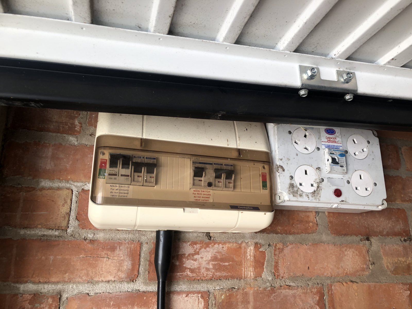

I’m looking to put some stud walls in my garage and need to move the control box (I’m assuming that’s not the right terminology but I’m clueless unfortunately with electrics) the switches and lights before I put my walls up.
My question is what sort of money would I be looking at having to spend for a job like that and for them then to return to wire it all back up once I’ve completed the walls.
Thank you in advance
Just get 3 quotes. Very difficult to give an idea without seeing the job.
If it’s the main fuse box for the house I would say £1000 ish
If it involves moving the mains incoming supply/meter it will cost a LOT more.
Pics will help.

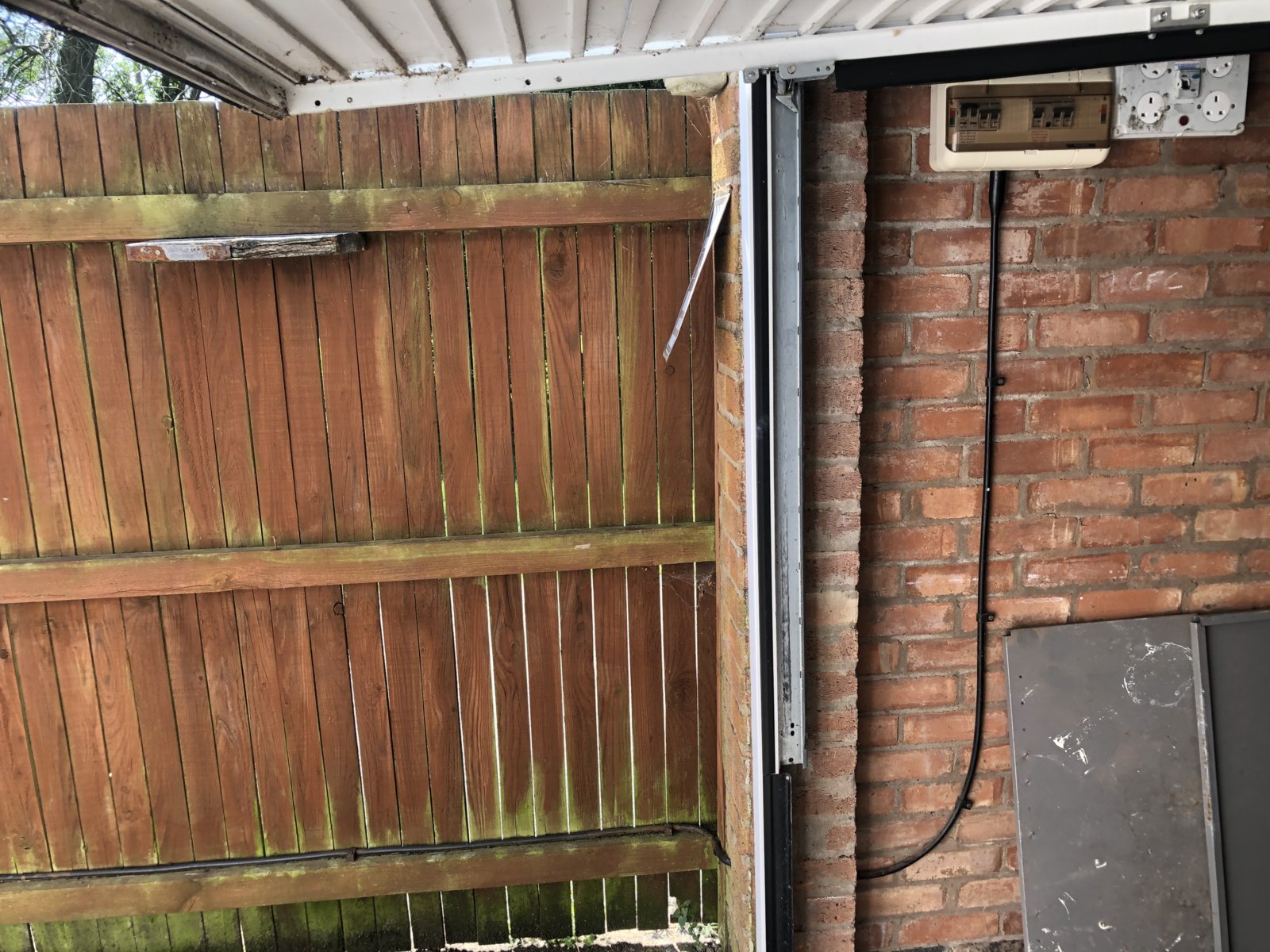

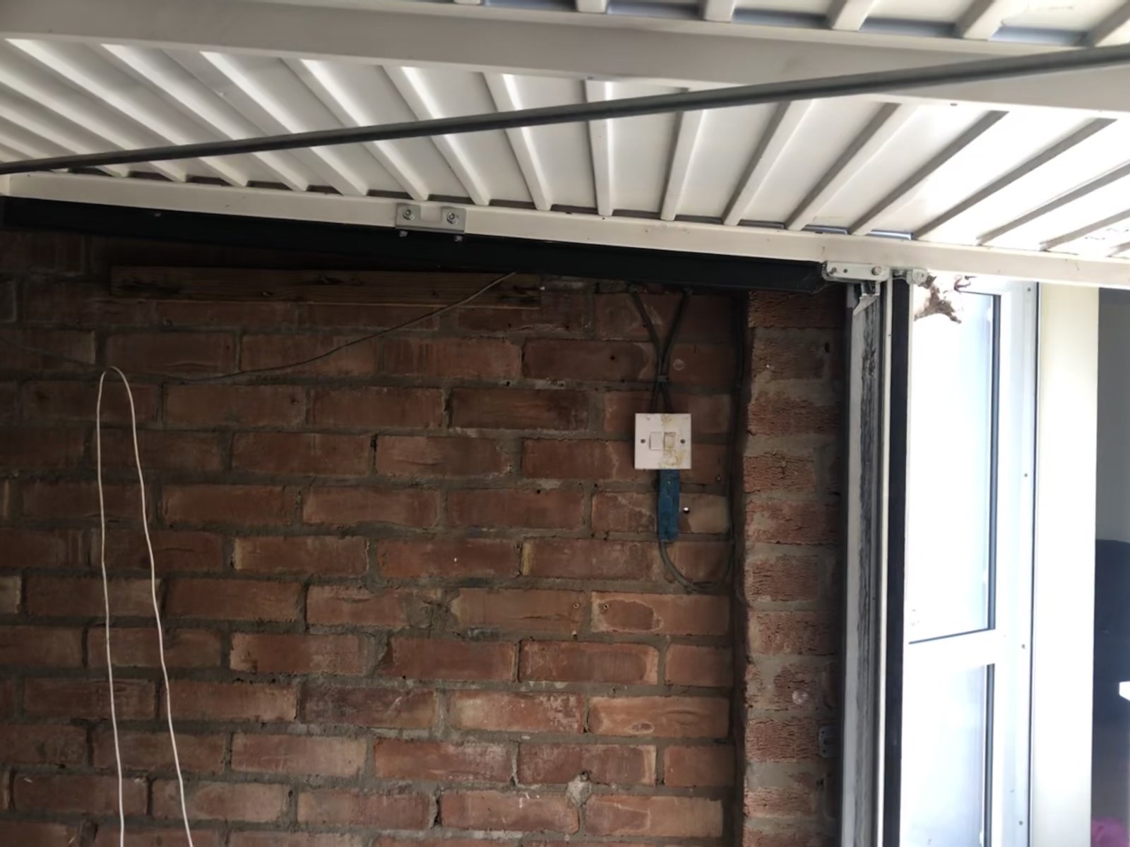

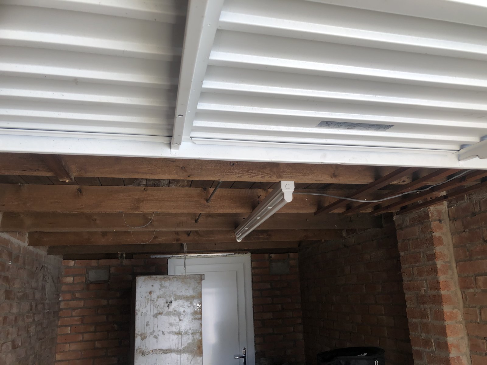

Sorry yeah should have put pics in, so the box runs off the main that goes along the fence from the front of the house which is that black cable, then it’s just a light switch and a light

As there is basically nothing there now, it's really a question of what you want in this building, as in how many lights / sockets / other.

Electric drum kit will need a power supply. You will have space in the 'fuse box' to wire in a couple of sockets BEFORE you put up the stud walls.
You, or rather your electrician, would simply run a cable to the place(s) where it would be convenient to have a few sockets. Leave a loop at each position and poke it through a hole in the stud wall. Once all the walls are in place simply connect up the sockets, connect to the 'fuse box' and away you go.
