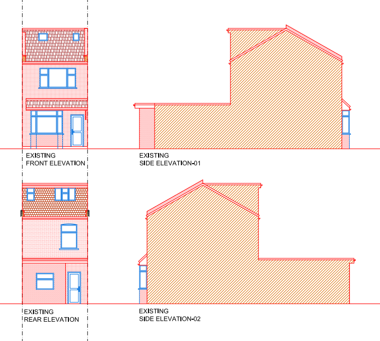

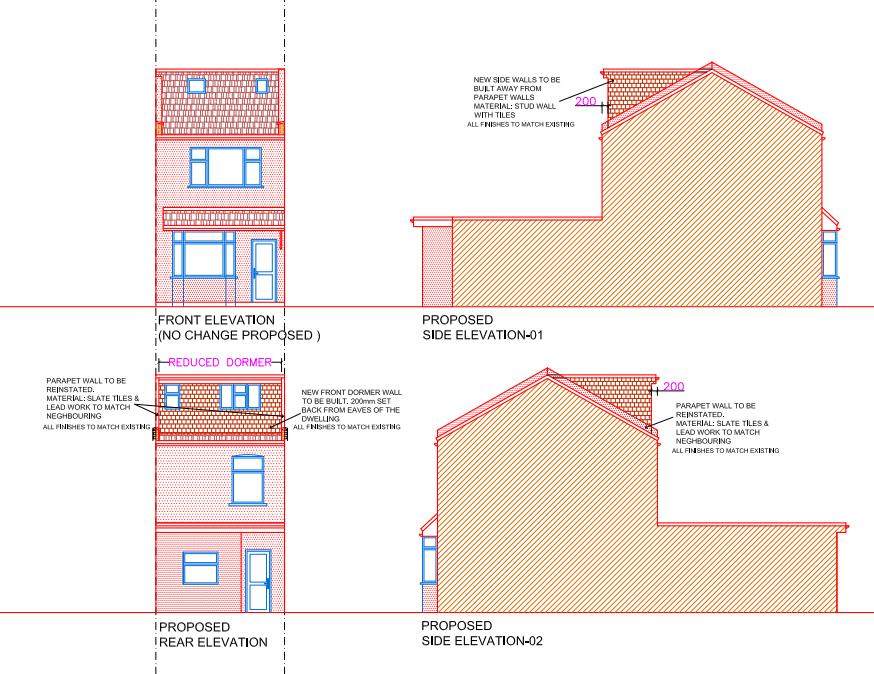

I have involved an architect to put together the new design for dormer and sent that to council for Lawfulness Certificate for Proposed Development. The council has refused saying:
"The development does not comply with the provisions of s.192 which deal with the lawfulness of a proposed use or development, by virtue that works to the roof of the dwellinghouse have already been undertaken. As such the works would not be lawful and the certificate application is refused"
My architect is confident that the design complies with regulation but I am not sure if I should go ahead with the change without getting confirmation from the council. I am scared that they may come back after development and find some issue with it.
I have attached drawings for existing and proposed elevations. Can anyone please help? Thanks.
