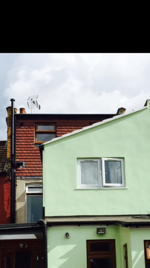

I am just asking for advise. I have recently had my loft converted under PD rights. Following discussions with the neighbours it was agreed that I should raise the party walls in brick to match existing house as they intend to convert at a later date. The 20 cm setback was not maintained as the independant building inspector advised it is not a set requirement. The loft has now been completed with a completion certificate issued only to find myself that the Council are not happy with my loft and they consider taking enforcement. The reason given by them was the fact that I have raised the party walls and not maintained the 20 cm- making the extension look like an additional floor, even if it is under 40 sq m and respects all the requirements for PD.
Having already contacted an arhitect and a party wall surveyer prior to the loft conversion and having building regulation in place, where do I stand? Are they entitled to give enforcement? Any advice is much apreciated. Picture is atached.

Your BCO advised wrong; to qualify as permitted development, there should be a 20cm set back from the outer edge of the eaves tile/slates (among other things).
Raising the party walls is a moot point.
The bottom line is: is it a 'roof enlargement' or a complete additional storey? There doesn't seem to be any of the roof left, so the council may have a point.

Councils will sometimes accept the argument that the 200mm setback detail is unachievable for structural reasons. The point about raising the party wall seems a nonsense to me. This is exactly how councils should be insisting that this work is undertaken, for precisely the reason you've identified. The work has been done to a good standard. Have they got nothing better to do?

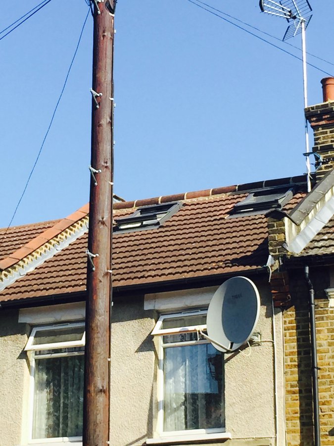

Also there are no modification visible from the front of the house except instalation of 2 velux windows. Will upload a picture tomorrow as it is to dark to take it now .

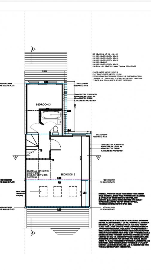

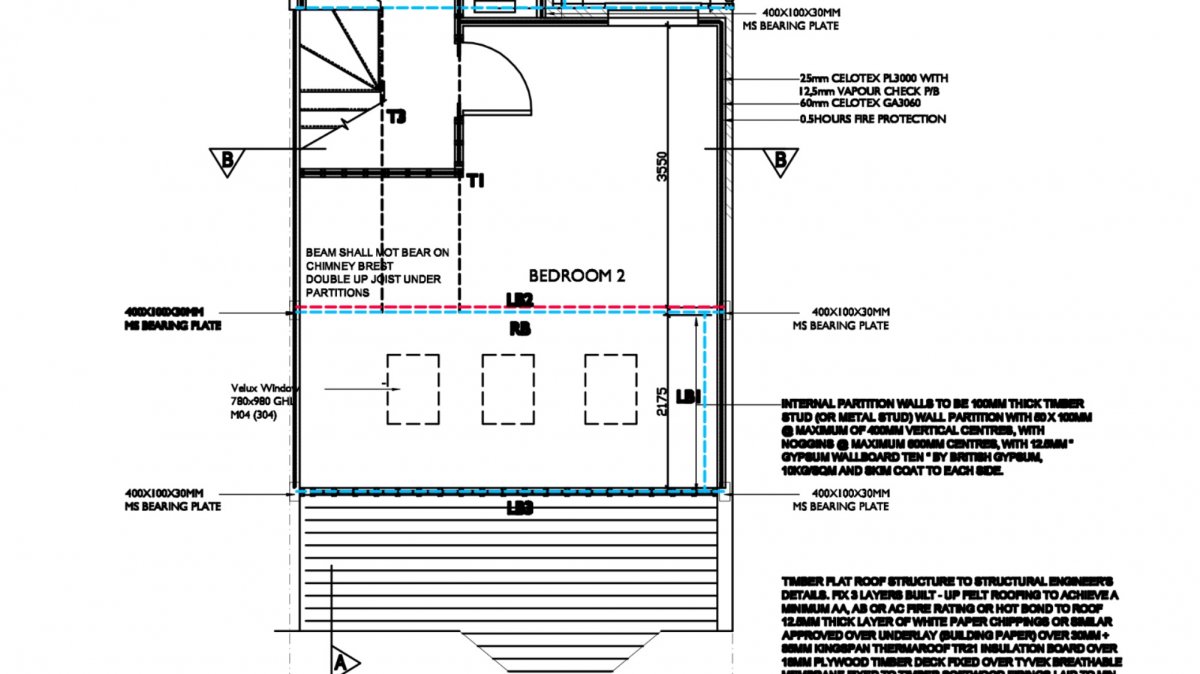

This is a picture of what he has drawn. The loft was not done as an l shape as i clearly said I am not looking for such a big extension. He argued that he put it down only for the purpose of the drawing and the fact that it comes under pd, but it is up to me how big i decide to do it.

I have added another as it might be a bit clearer.

This is a picture of the front roof
