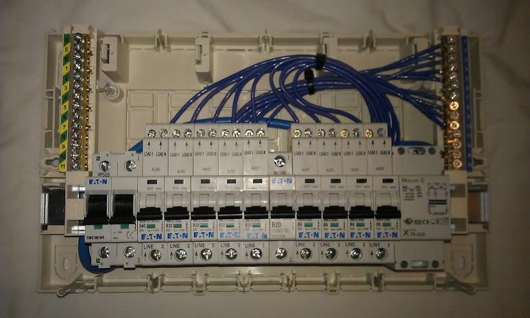

Crimping bootlace ferrules for RCBO neutrals
The topic title is "Crimping bootlace ferrules for RCBO neutrals" - it's not that which has made the significant difference.
You should note that the diameter of stranded cable can't be used as a reliable indicator of CSA. Round strands cannot be packed together without a gap.
They can't, but if you've only got a limited number of standard sized cables to choose from, you can ID it by measuring the overall diameter of the conductors.

I've noticed that the Bell Transformer is a different make than the Eaton consumer unit......

I believe Memshield 3 are the same as Moeller X pole, just a re-branding exercise.
