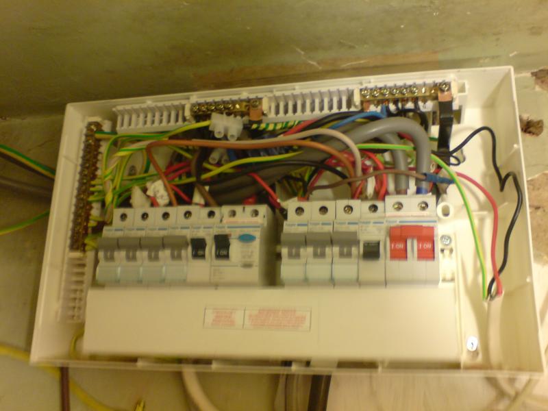

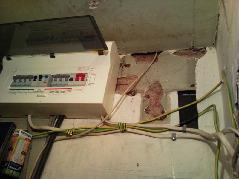

Since my CU was fitted in 2006, I've been meaning to tidy it up, because the guy who fitted it made such an abortion of it. I have a week off next week, and plan to tackle this then. Planning is everything, I dont want to leave us without power for too long!
This is what I have right now:
and without all the junk:
Most circuit cables enter the CU from above.
Jobs:
Fit a piece of chipboard, covering all the rough plasterwork on the wall the CU is on.
Renew tails from meter, in one run to the CU.
Fit empty plastic box between the CU and the ceiling.
Refit CU under plastic box.
Extend all circuits via crimps, into the CU.
Use plastic trunking across the bottom of the CU and meter board for the earth bonds and cable exits.
Re-terminate the SWA, which currently just sits inside the bottom of the CU. I have a gland for this (which I left on view for the spark doing the CU change)
Basically, if folded flat, I want to end up with this:
Several queries though.
Do I run the earths up around the CU/box or through them? I know I can use the earth bar in the CU as the MET, would this be a better solution, given the layout?
Can I terminate SWA onto plastic trunking, or will I need another box under the trunking for this? (I have a spare metal box in the shed, I'll probably end up using this anyway, because im guessing that even if allowed, doing it onto plastic will be hard!)

Hi, just a word of warning.. but its quite likely this work would come under Part P.. because it sounds like you will be essentially re-wiring the consumer unit, also when doing this scale of job.. you would normally ensure the circuits are brought up to date... if you are adement to do this job at your own risk and in the knowledge of part P.. if you are disconnecting everything and re-wiring it would be wise to upgrade to 17th edition board as it offers better protection due to everything being RCD protected, and redundancy because upstairs and downstairs are on separate RCDS.. or some electricians do front and back of the house on new builds.
RCBO'ing everything will cost far more than a 17th edition board with 2 RCDs.. being in mind MCBs are only a few quid each.. RCDs are probably most expensive part but still cheaper than RCBOs
bearing in mind you will need to RCBO anything which isnt RCD protected with wiring buried less than 50mm within the wall, and not sufficiently mechanically protected
Also when crimping.. only use a rachet crimper to get a good connection, then remember to heatshrink afterwards preferably. When crimping a good connection is essential, because if the connection isnt good enough the join will become high resistance and heat will be generated that can further lead to the possibility of a fire.
SWA would be terminated into a separate termination box which joins onto the T&E which then goes into the CU... if you use a metal box, remember to earth bond it, neater this way and gives more flexibility when wiring into the consumer unit.

1) Why not use galvanised trunking if you wan to be able to terminate SWA in it? Get yourself a 20mm punch (e.g. Q-Max) - makes nice neat holes in next to no time.
2) If you're lowering the CU, why not lower it enough to avoid the dog-leg in the trunking?
3) Get a blank for that empty CU position.
4) How do you propose to isolate the installation?

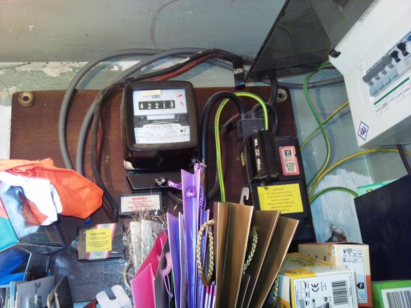

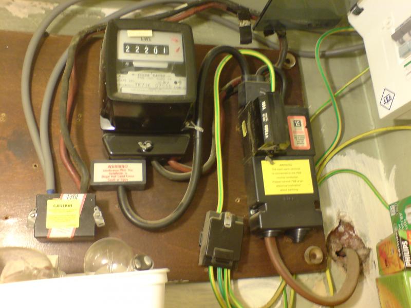

In the picture with the service head on it looks like there are electricity board seals on all of their boxes - what do you propose to do about breaking them?
Also I would be nervous if I were you about doing all of this work without testing the whole installation first, a days work if you have done it before. Maybe more, if not. You will need to hire a tester (assuming you don't own one) to do this and follow the test and inspection routine in Guidance Note 3. If you don't do this you leave yourself open to a lot of problems further down the road of your project.
Running through will look neater, there's nothing wrong with doing it either, although do try to bend the cable such that it stays well away from any exposed live parts. It shouldn't be particularly difficult to form 10/16mm in this way. A separate MET is equally accessible, and some might argue better as it makes it easier to check the integrity of PEBs without removing the CU cover, although it wont look as neat.
Although there isn't a regulation prohibiting it in specific terms, it doesn't sound like a very good idea to terminate onto plastic trunking. As per BAS's suggestion, use metal trunking or stick to your original idea of a metal adaptable box. I'm not completely against glanding straight into a plastic CU for small sizes of SWA where the enclosure is sound and an earth nut is used, although with your trunking layout I think this would be impossible anyway.

Although there are seals present on the main fuse, they aren't intact. And I am aware I'd have to cut the seal on the meter, but I'll make it look intact after myself. Bit of Araldite should do the job. :lol:
Ban, good point on moving the CU down further. The wall is unused anyway.
I figure by re-instating the original CU I'm not making it any worse. I am aware there is also an earth fault on the upstairs ring final, so I dont want to RCD everything on the day, though I may make an ongoing job to replace the MCBs. We are planning some "knocking about" of the house this year, so electrics will be updated.
I have a blank for the empty slot, one of those "been meaning to do it" jobs.
I will use a metal box under the trunking for the SWA to attach to.
