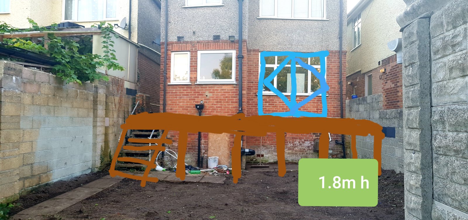

Hello all... first post as i couldnt find anything similarly related within the forums.
Basically i would like to add decking to the rear of my property. The same hieght as dpc so i can walk stright into it. Problem is my garden drops down at the rear to 1.8 meters.
Now i know the hieght of the propesed decking is 300mm from immediately highest ground level. Would i achieve this from wear it drops without the need for planning permission. I have added pictures to help explain!

Quote from the planning portal
"Putting up decking, or other raised platforms, in your garden is permitted development, not needing an application for planning permission, providing:
  • The decking is no more than 30cm above the ground"
I can't see where your planned deck will be even close to being no more than 30cm above ground unless you are very optimistically including what looks like a path to the side of the house (behind the concrete steps).

The neighbours can object to your application so it might be worth a chat with them (especially those on the right of your photo) to try to get them onside before submitting your application.
If you do get PP then be prepared for a proper bit a design - with the height and potential loading it's not something to put together with a few posts and deck boards from your local DIY store.

Me - dig footings ('cause it is going to support weight) at the distance from the house that you wish the deck to be. Maybe fix the long 'repair spurs' into the footing as it's poured, say at 4ft centres. Once set 4x4inch uprights to the height you wish the deck, (sorry, outbuilding roof) to be. 6x3inch joist along the front, 5x2inch wallplate along the house wall about an inch higher to provide 'fall'. 5x2inch joists at 16inch/400mm centres and OSB over; roof with the appropriate material to provide the waterproof layer (you need good advice here as your effectively going to walk on it). If you want the 'decking' look make up movable panels so that you can lift them once or twice a year to clear the debris that will collect in there. Gutter along the garden front.

that wont work as a roof terrace is still a raised platform greater than 300mm
