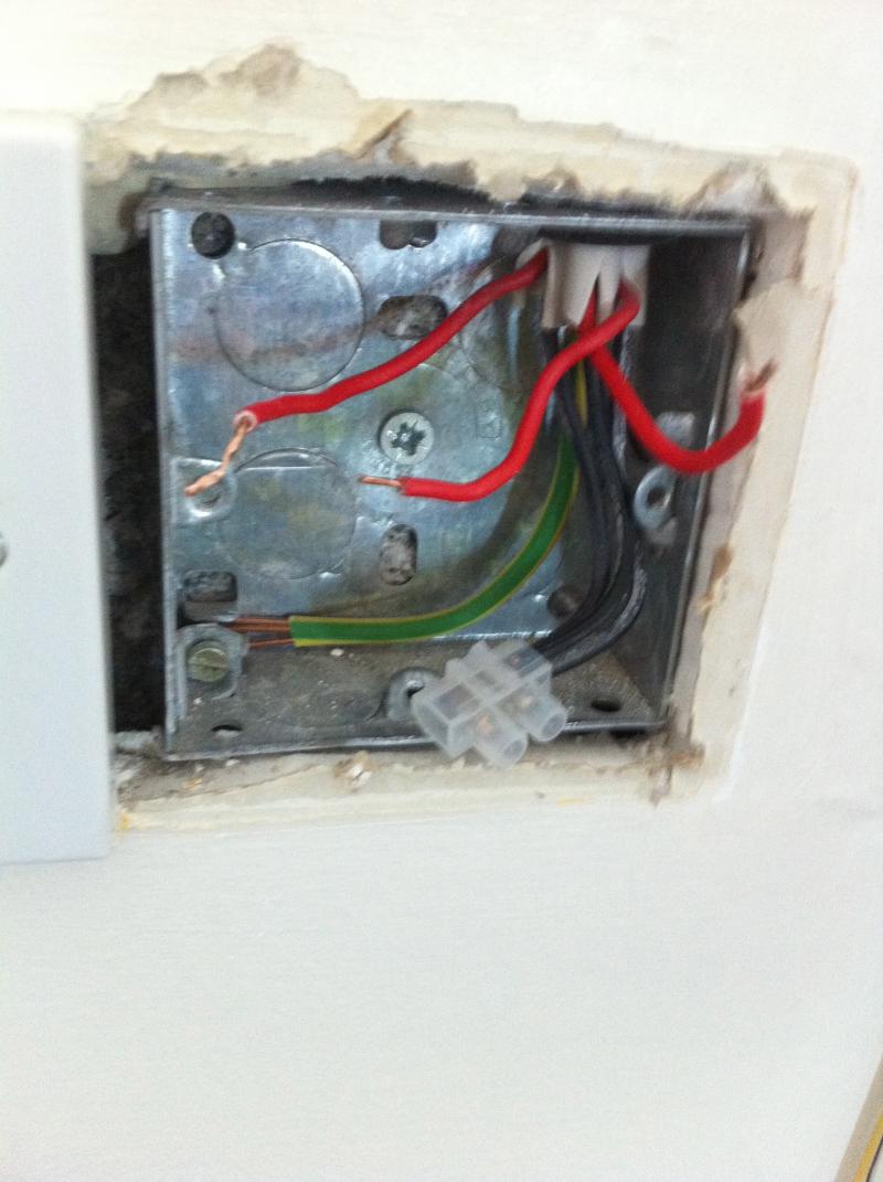

I recently moved into an apartment and one of the dimmer switches wasn't working. So I bought a replacement, but when I went to replace it I found 3 red wires (unlike any videos or tutorials I have found).
So I copied the set up of the previous (broken) switch and put the one red wire in the C and the other two reds in L1 and L2, but it didn't work properly, and stopped other lights working.
So I started switching the three reds around in the C, L1, L2 trying different combinations. None worked properly, and now I don't know which wire is which. I have tried all possible combinations and none work. What's worse is that each combination stops other lights working. So now I have all lights turned off and I'm stuck. Any advice would be really really welcome. Thank you.

Is this the ONLY switch that controls the light ?
If so then one red [1] is the Live supply from the consumer unit ( fuse box ). Another red [2] is the Live feed onto other switches for other lamps and the third [3] is the switched Live to the lamp this switch controls
[1] and [2] need to be connected together to fed the other lamps so both these go into the COM on the switch.
[3] goes into L1
Nothing goes into L2
Try any 2 into COM and if the other lamps work then you have the correct two in COM. if they don't then change one of them until you find the two that belong in COM
yes as said, first find which 2 red wires need connecting together to make the lights in the other rooms work.
Once you have found this, put these 2 wires into the COM terminal.

Thank you everyone for your advice. I followed the instructions and now everything's working fine. Such a relief to have lights when just moving in, I really appreciate all of your comments.
I will definitely not use a trial and error approach again, no matter how desperate. Thanks again all.
