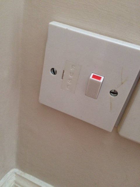

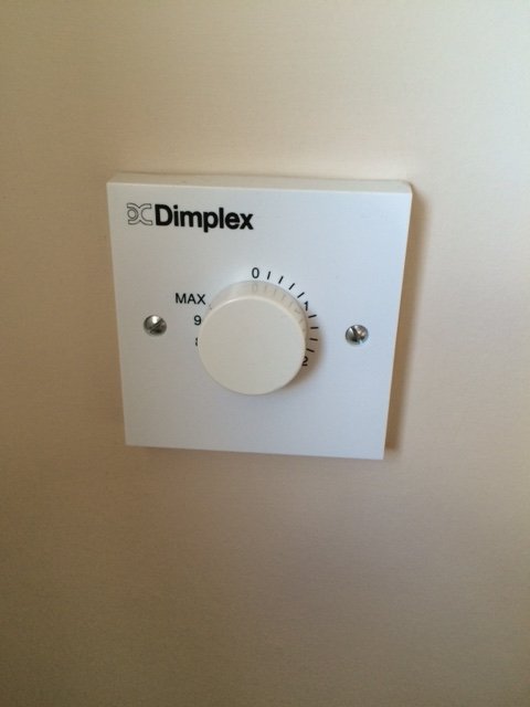

Hi
I have moved into a house and the small toilet room downstairs has a Dimplex Towel Rail BR range with a Dimplex Towel Rail energy regulator DX4123 outside.
The wiring goes in a blank plate, which is connect through a switch with a fuse and the the regulator above it.
This is not working at all, I've tried the fuse, checked no loose wires any other ideas?

Do you have power at the FCU ? I will be wired like this: Supply>FCU>Control> Heater.
Regards,
DS
Do you mean at the fuse switch? If so then yes, light is on and fuse been swapped
Hi, yes if the light is on then it must be the control or the heating element that is faulty. If you have a method of testing for power you can check the Output of the controller.

Is there a way to bypass the energy regulator to rule that out?
Hi, yes if you post a picture of the back of the control we can advise.
Regards,
DS
Hi, it would appear to be two wires L supply + L out if you connect them together using connector block that will operate the element if is Ok .

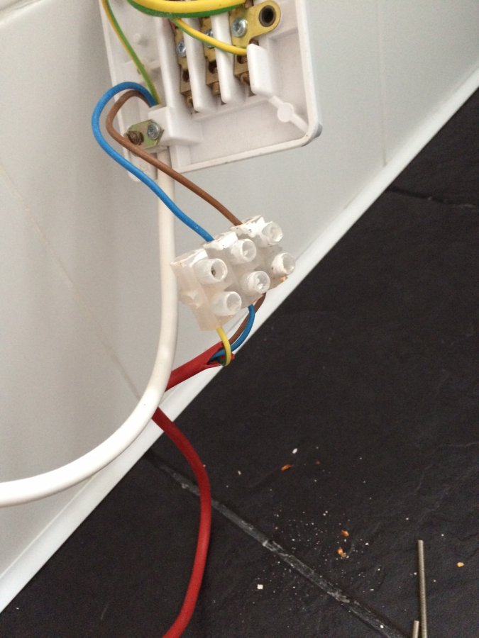

I have a extn lead cut could I plug that into the wall and wire it straight to the heater at the face plate in bathroom
That would test it
Ok so I connect a lead up to it and plugged it into the socket, test screwdriver light comes on,
see photo, will this test just the heater
If that white cable goes to the radiator directly then yes but you MUST connect that earth cable to the connector strip.
If there is a fault with the element you could potentially make the whole radiator live.
OK the good news I can feel the top 2 rungs starting to heat to the problem must either be the fuse switch or the regulator.

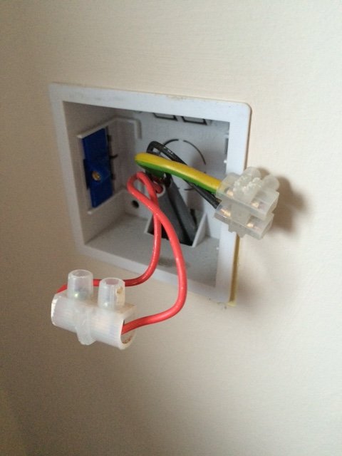

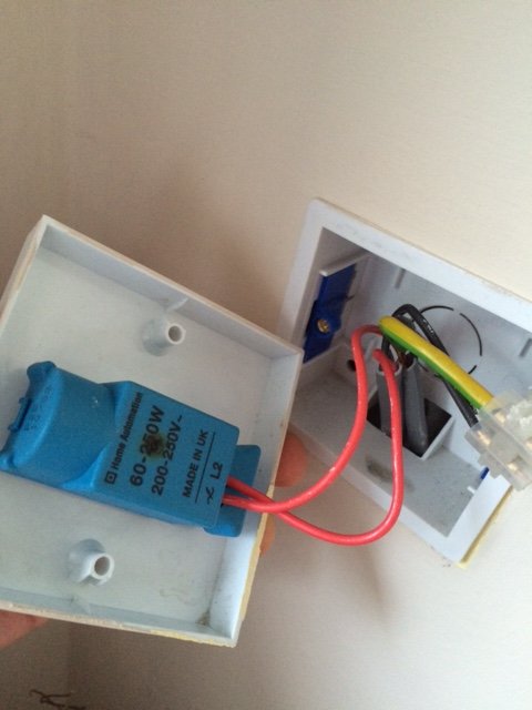

Hi, sorry i thought you were removing the controller ? that was why i said just connect the two lives together, that would confirm the supply is ok if the heater worked.
DS
ok I've done that now see photos so if it heats up its the regulator switch at fault
